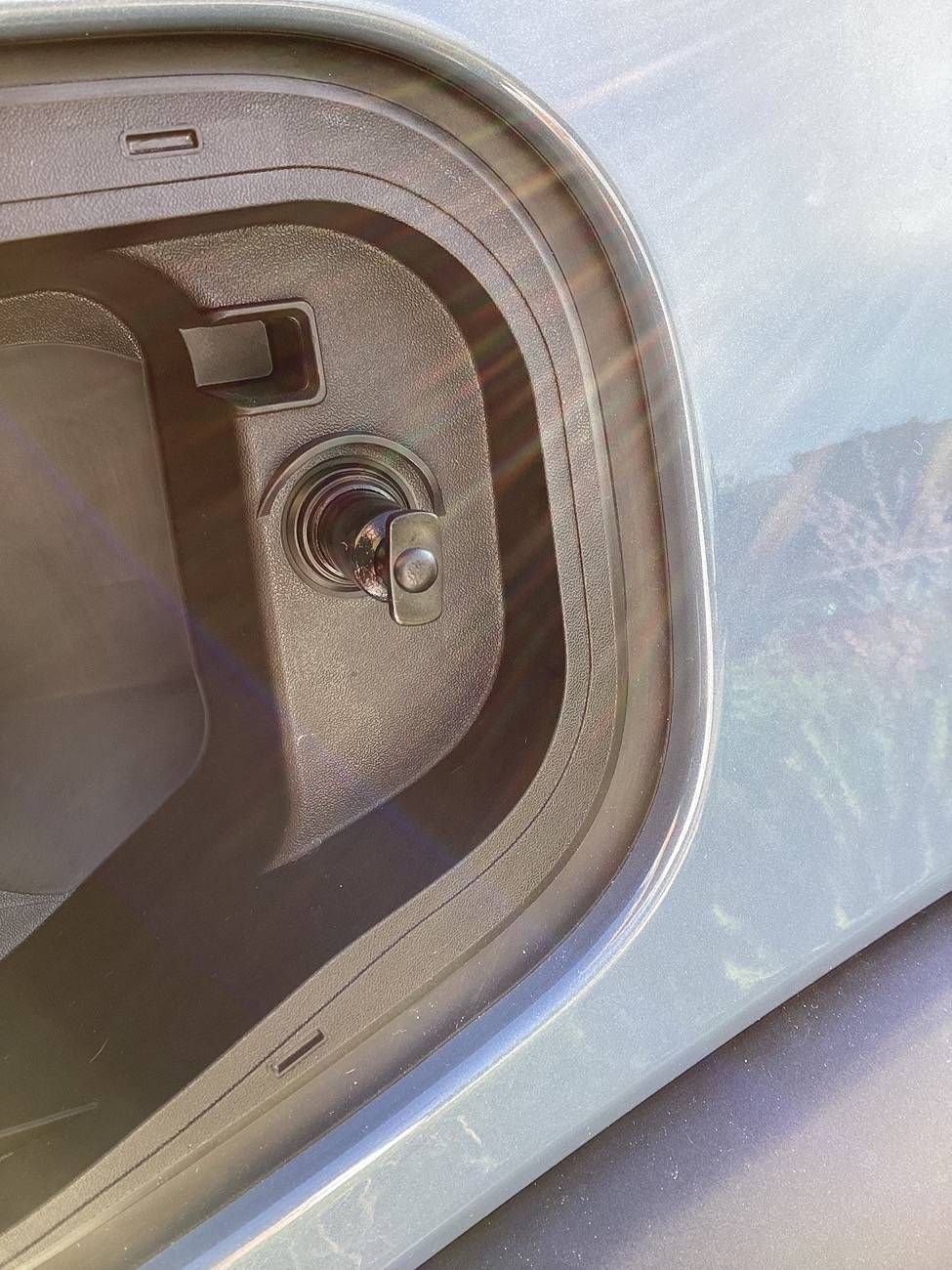

Short explanation of the catch mechanism; catch when opened full length it vertical as pictured;
Ford Ranger Fuel door keeps popping open IMG_1192

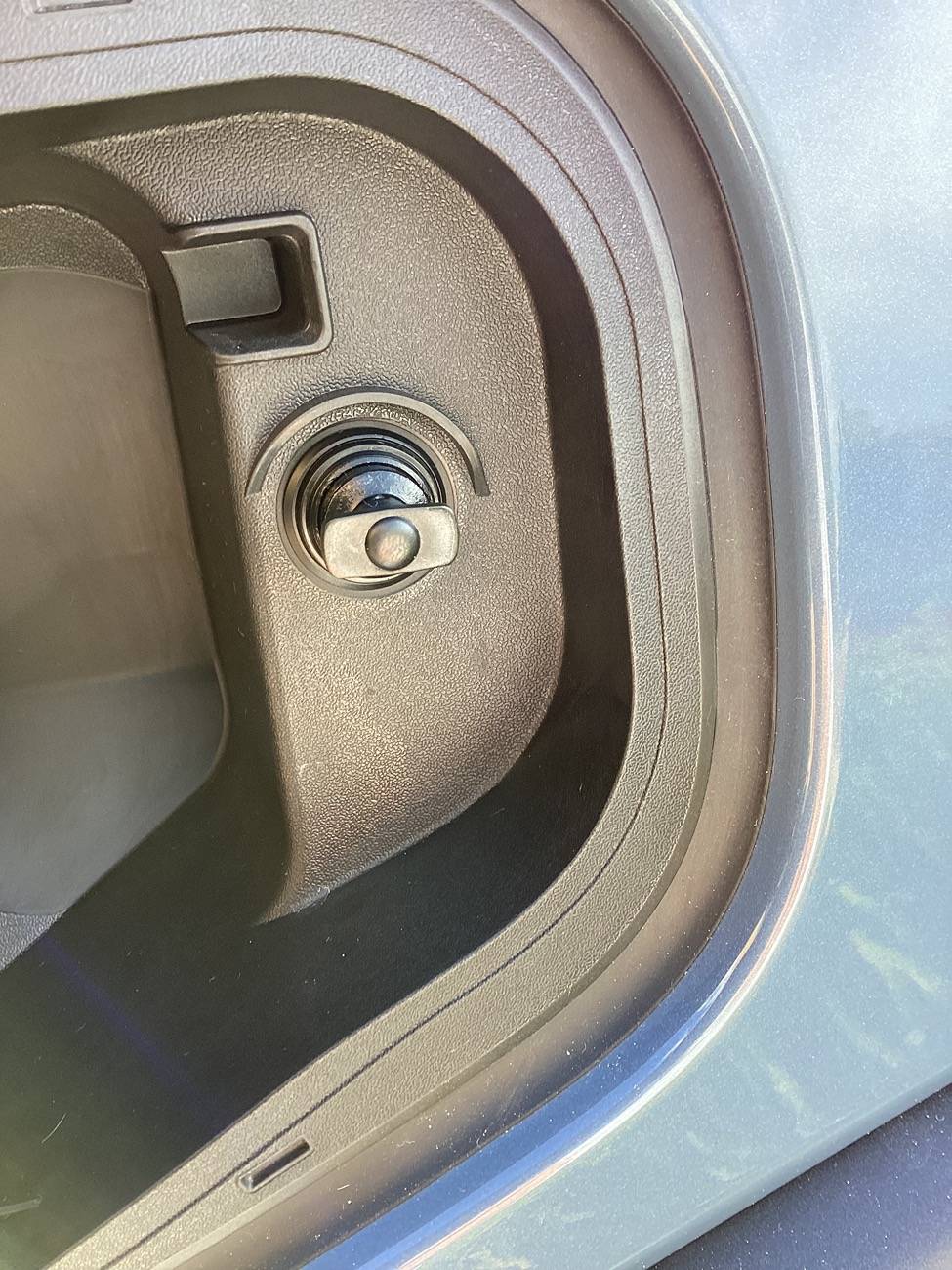

When closed is horizontal as pictured;
Ford Ranger Fuel door keeps popping open IMG_1193

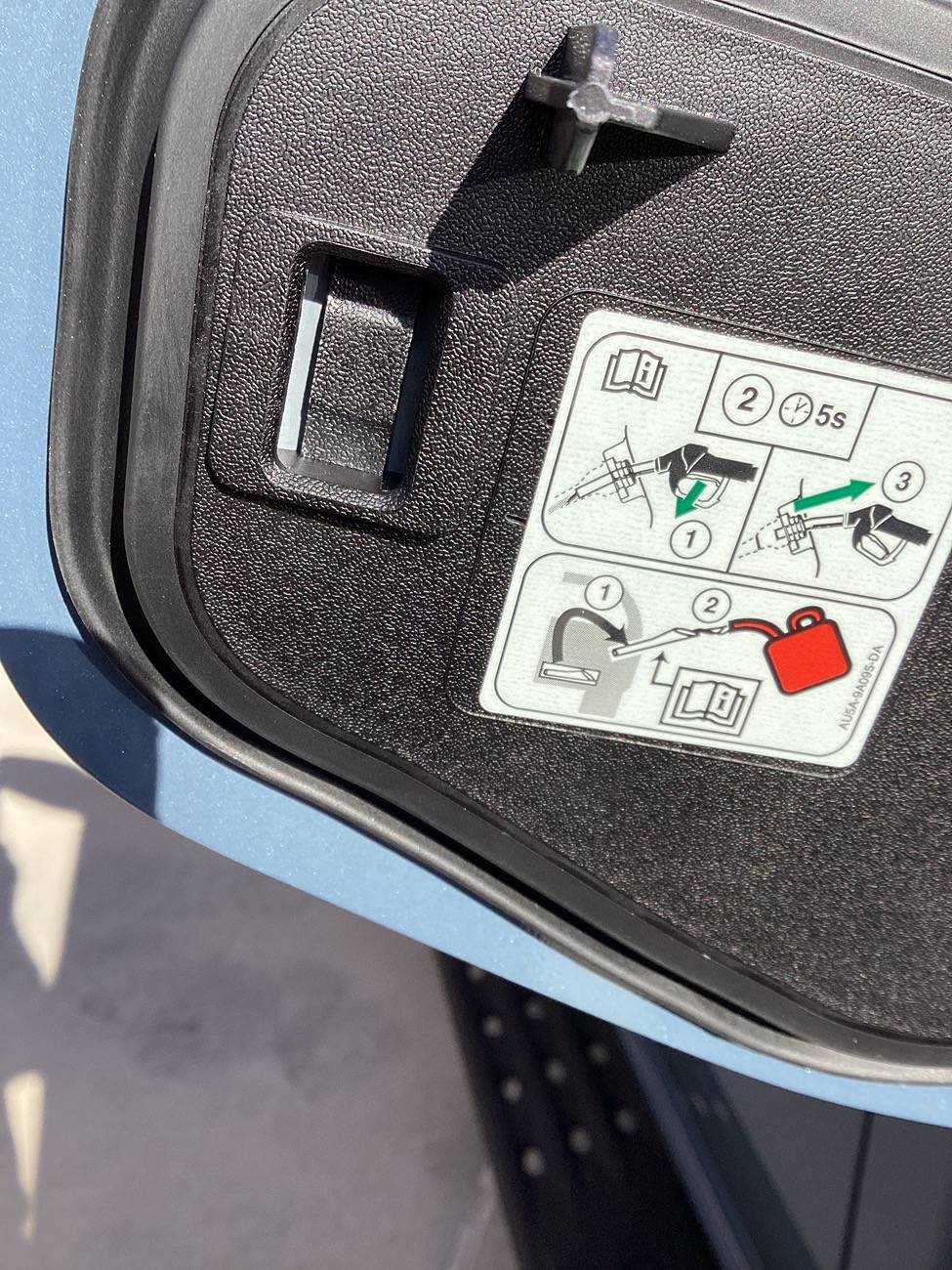

Fits in the fuel door vertically when opened and first closing. As you push on the door the catch rotates horizontally in the door slot and locks the door. See door slot as pictured;
Ford Ranger Fuel door keeps popping open IMG_1194
First check the slot for any debris of possible plastic molding left on either side of the slot. If there is remove it with a razor knife carefully.
If not, leaving the catch plunger mechanism extended use some silicone lube spray or Vaseline on the exposed portion. Push it in and out to disperse and film the plunger.
Mine is well lubricated, so it might be yours is dry and catching partway on the dodo slot, not fully rotating to horizontal in the door slot.
This doesn’t work, take it to the dealership service.???
