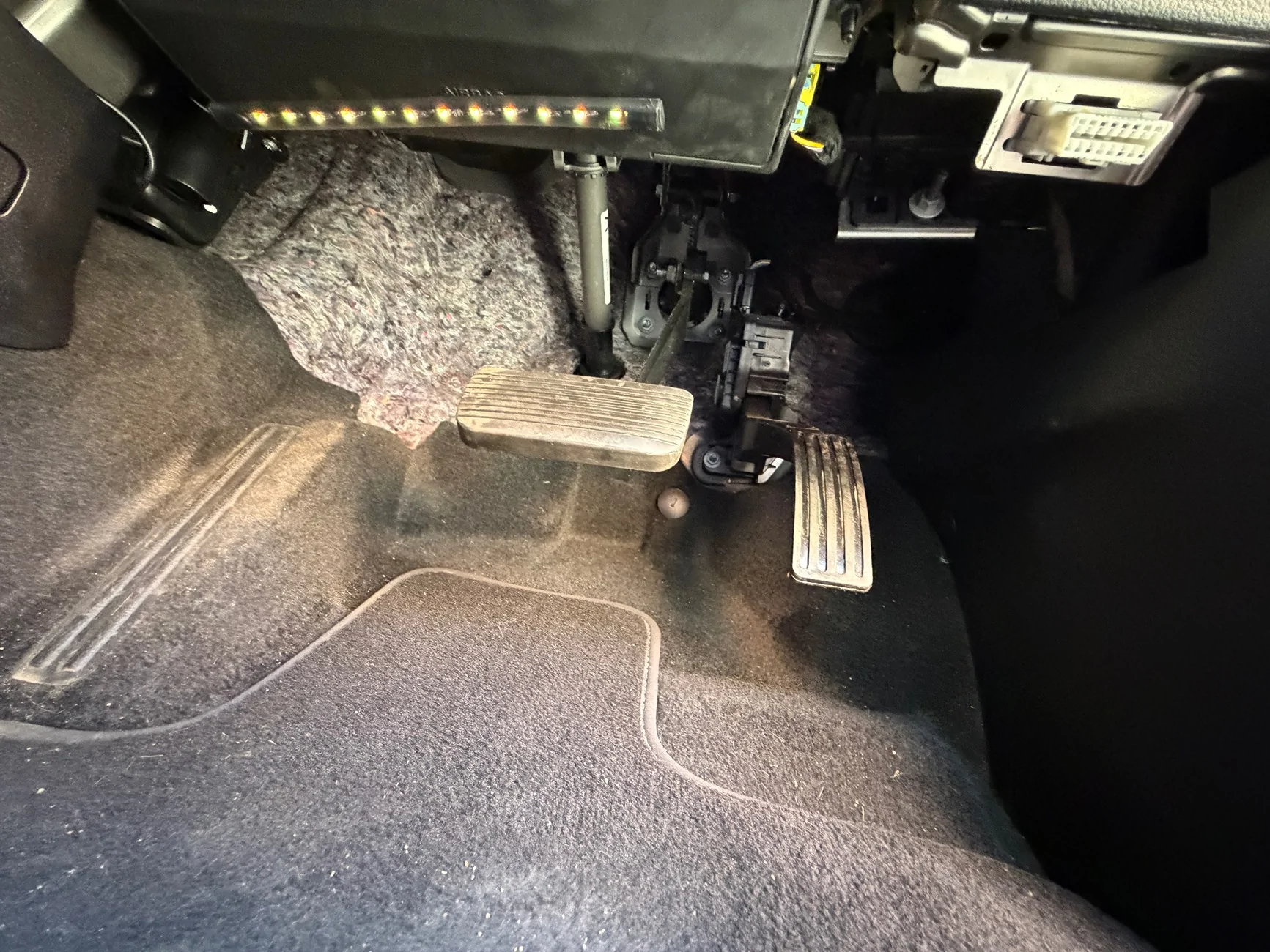

underside of my pedals
Ford Ranger Gearbox Clunk When Going Between P &R/D IMG_1334

Thanks for the update on yours and for the photo under the drivers side dashboard.
