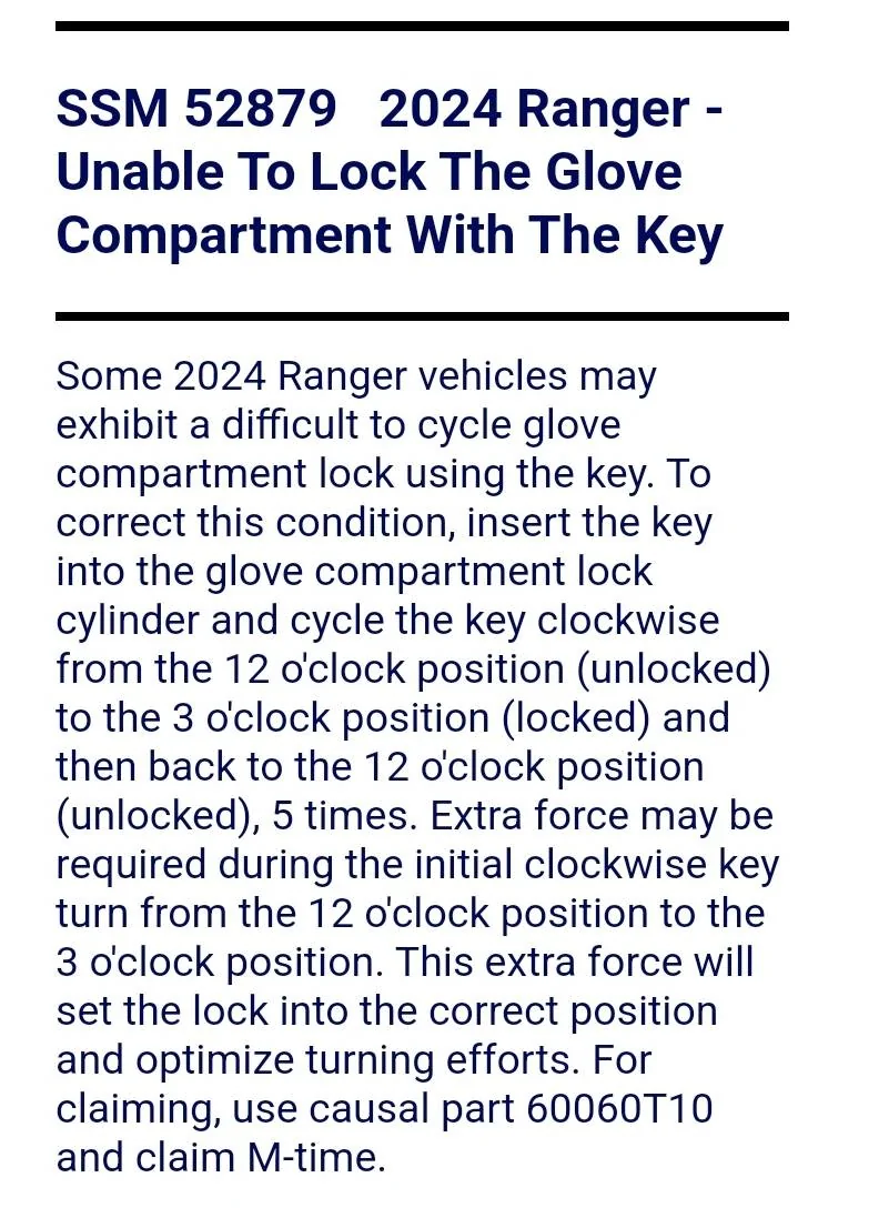

Ford issued a service bulletin concerning this issue. It seems you fixed it with these suggestions, but here is the official direction in case someone else is looking for it:
Ford Ranger Glove Box Lock doesn't work with factory keys? 1000011365
