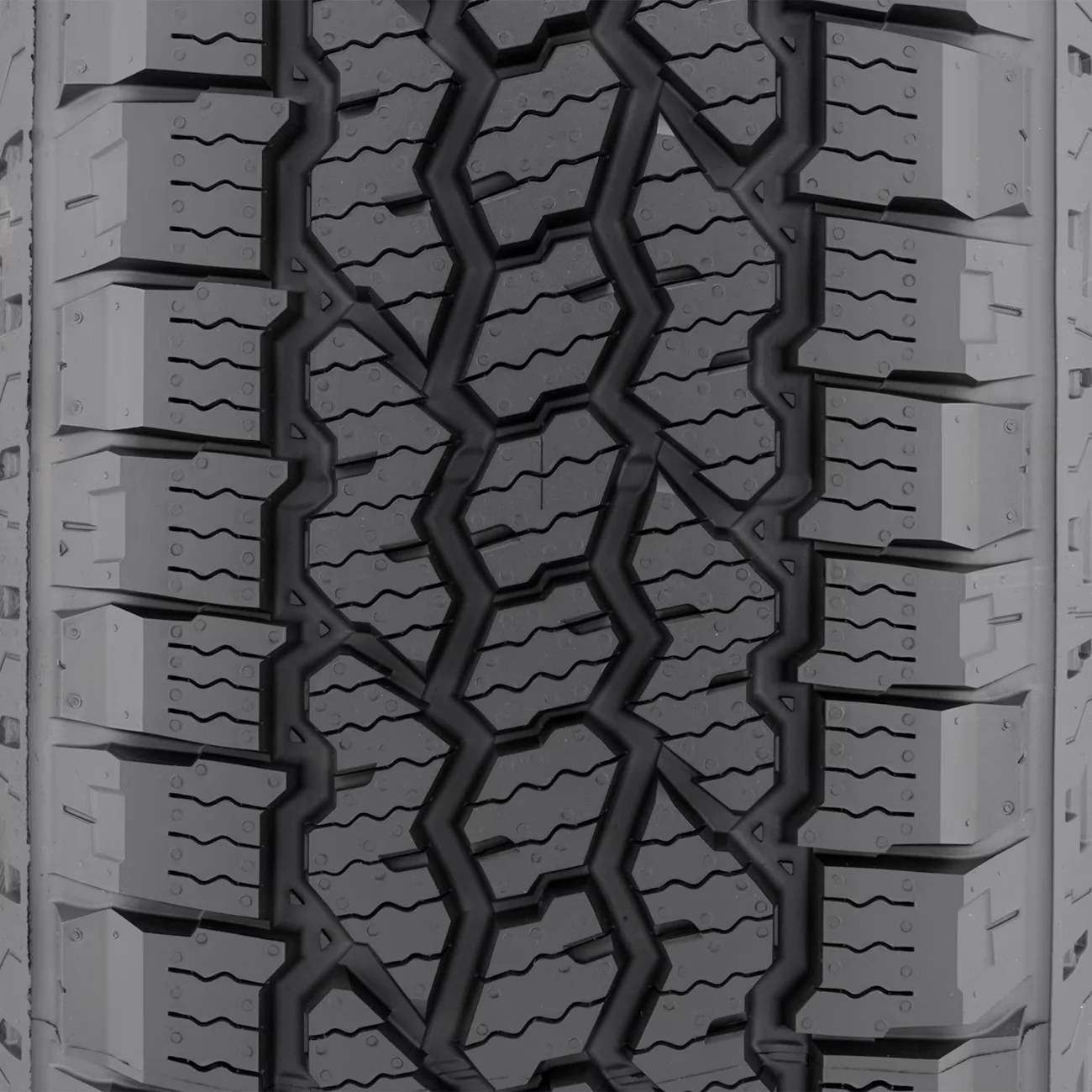

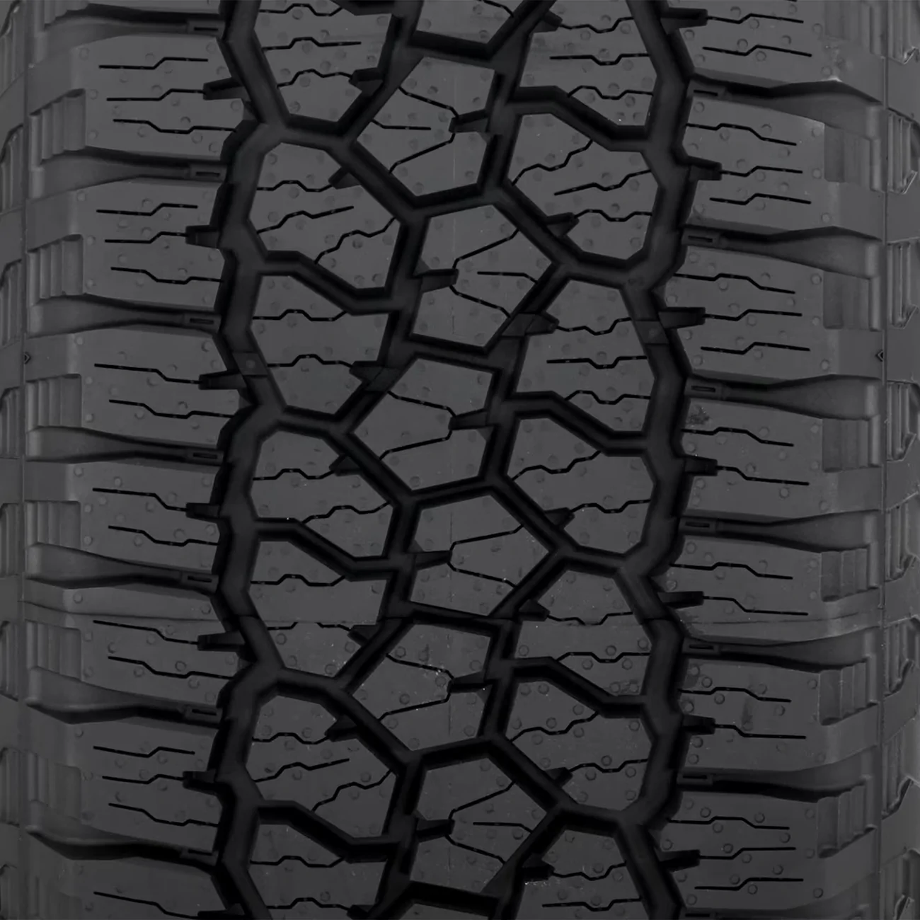

Comparing the Workhorse to the Ascent - they have different design priorities:
1. Compound Philosophy
  • Goodyear Workhorse AT2: Uses a "chip and tear resistant" compound designed for durability. The rubber is harder to withstand sharp gravel and job site debris. The trade-off is that harder rubber struggles to conform to wet asphalt and stiffens quickly in freezing temperatures, reducing micro-adhesion.
    Bridgestone Ascent: Utilizes high-silica "Enliten" technology. This compound is chemically engineered to remain soft and pliable in the cold and wet, prioritizing grip and stopping power over sheer physical durability.
2. Siping Technology / Groove & Block Design
  • Goodyear Workhorse AT2: Features standard 2D sipes cut straight across the blocks. While they provide biting edges, the blocks can flex and squirm under heavy braking, causing the sipes to squeeze shut just when you need them most on ice. The "open shoulder grooves" and large voids (visible in your image) rely on mechanical keying. This design excels at digging into deep, loose material like fresh powder, mud, or loose gravel because the large gaps act as paddles. However, the large voids reduce the total rubber contact patch on wet highways.
    Ford Ranger Going to need new shoes soon 1768059340457-vf
  • Bridgestone Ascent: Uses full-depth 3D interlocking sipes (waffle pattern inside the rubber). When braking, the internal walls lock together to prevent block squirm. This keeps the biting edges open and effective on hard-packed snow and black ice. Features a continuous center rib and tighter block spacing. This puts more rubber in contact with the road at all times, providing superior stability and wet traction, but offering less ability to "paddle" through deep, loose off-road terrain.

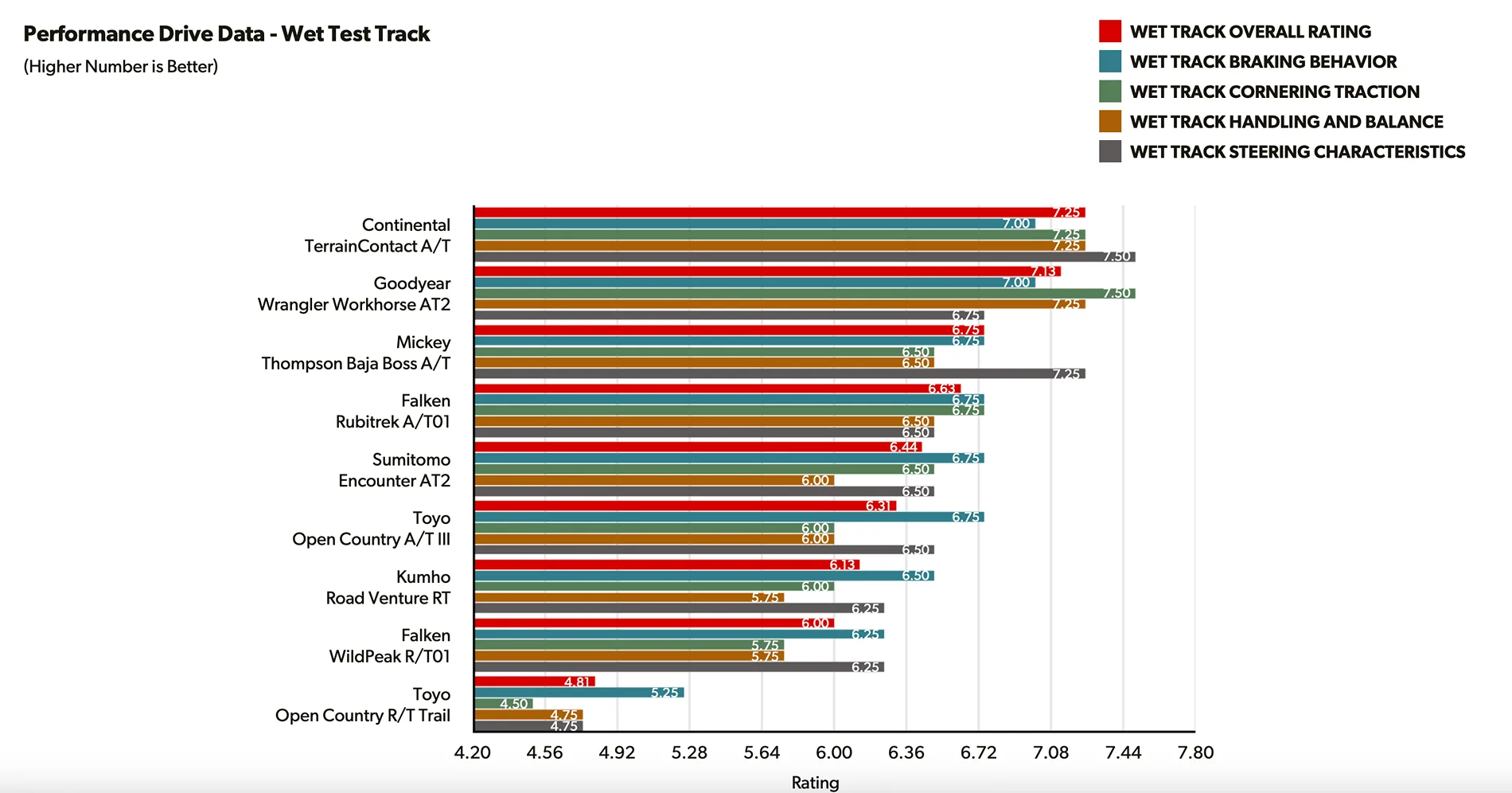

All I know is that the Workhorse AT2 performed great in wet braking and wet handling, especially for a true AT. I'm surprised the Toyo AT3 was as middling as it was, because I've run those and liked them a lot.

"On that note, Continental's TerrainContact A/T was pretty decisively the top option in this test. It stands to reason that as the sole category representative for On-Road All-Terrain tires, that it would be a strong contender on paved surfaces, but it was both subjectively and objectively the best out here. The nicest ride, the quickest laps, and the best stopping distances from 60 mph. It does an excellent job reinforcing the importance of looking at category first for tire choice.
"Goodyear's Wrangler Workhorse AT2, as one of the newest products in this test, also makes a great case for looking to see what the continual advancement of tire technology offers as well. It was very close behind Continental's tire in nearly every regard, and as an Off-Road All-Terrain pick, that's a strong place to be.
"Mickey Thompson's Baja Boss A/T rounds out the top three of the test, and makes a compelling argument for the Rugged All-Terrain category doing a little bit of everything as well. Not to the same level - it was a noticeable step down in ride quality and noise comfort on the street compared to the other two - but a worthy contender nonetheless."
I stand corrected :blush:
