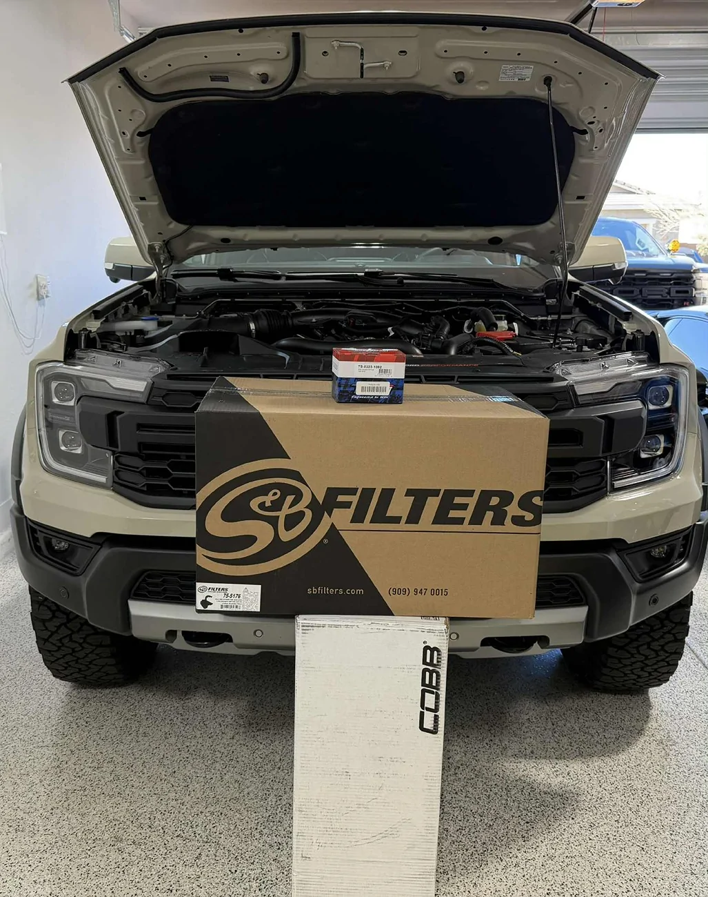

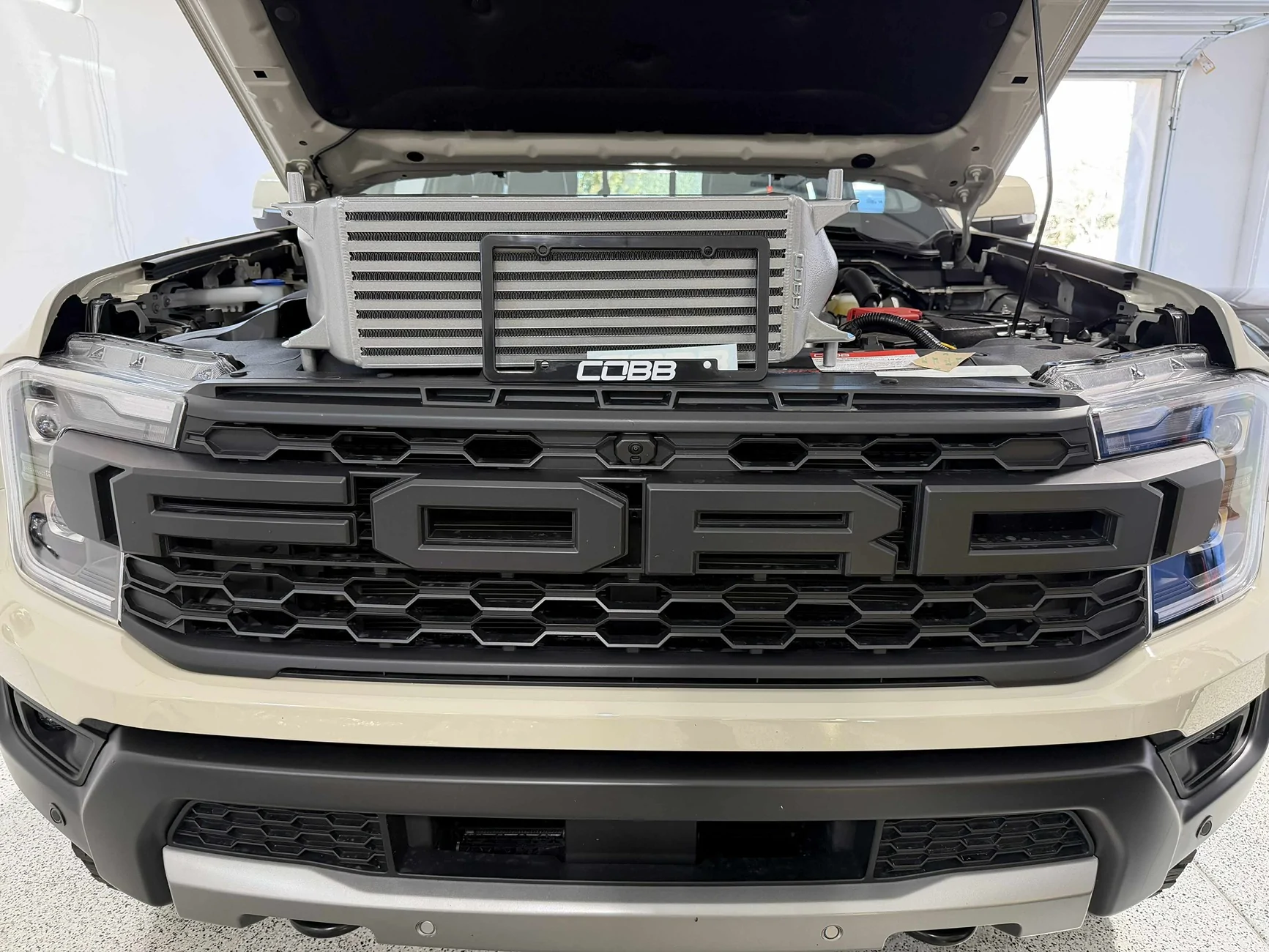

is the intake and inter cooler a must before tuning? Or best bang for the buck beside the tune?
I would highly recommend them. If you can only do 1, do the intake first, then intercooler. But I do recommend both!

i was wondering that same thing yesterday, which would be better to do first if doing upgrades.
Yep the intake is what I'd do first

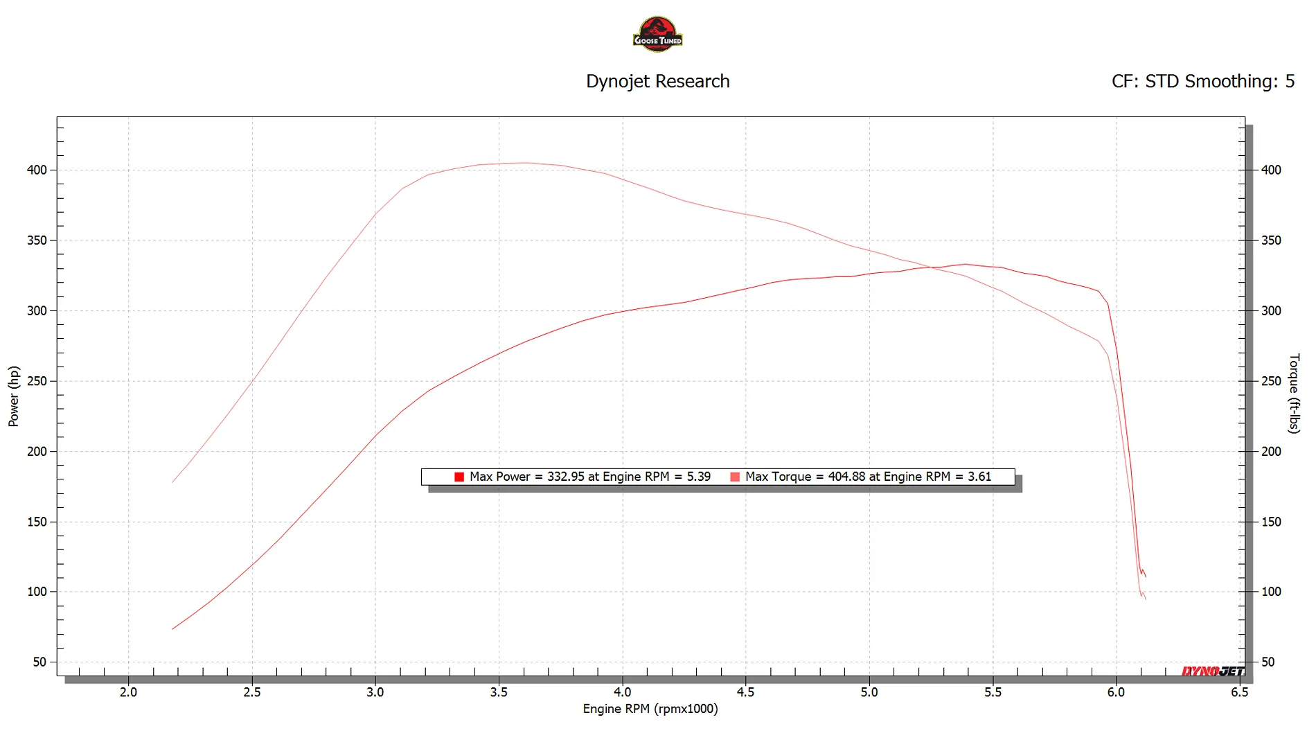

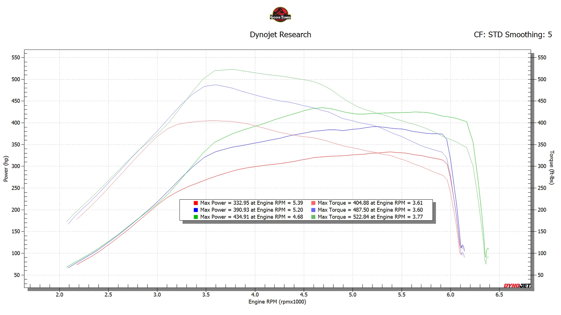

Stage 1 Tuning done!
Ford Ranger Goosetuned Tuning R&D - Ranger/Bronco 3.0 Raptor +300hp! in truck on dyno ranger raptor
As an fyi, I consider Stage 1 in this case to be completely stock, 0 mods. Tune only.
Threw the truck on the dyno (dynojet), stock tune on 91oct, made typical power as expected:
91oct Stock tune
332whp 404wtq
Ford Ranger Goosetuned Tuning R&D - Ranger/Bronco 3.0 Raptor +300hp! stock 91

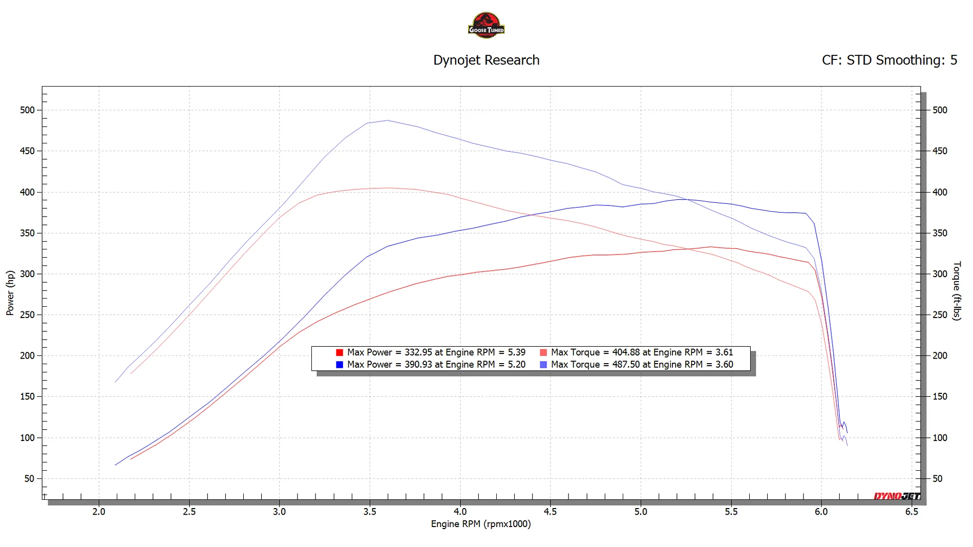

Next, I decided to test the Ford Procal settings:
91oct Ford Procal
390whp 487wtq - not bad! This is +58whp +83wtq
Ford Ranger Goosetuned Tuning R&D - Ranger/Bronco 3.0 Raptor +300hp! Stock vs Procal

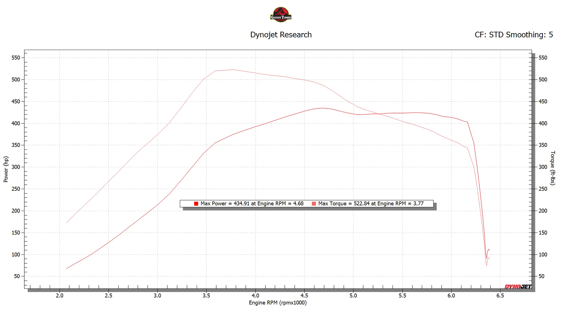

After this I decided to test my custom 91 tune:
91oct GooseTuned
434whp 522wtq - that's +102whp +118wtq over stock!! and +44whp and +35wtq over the Procal!
Ford Ranger Goosetuned Tuning R&D - Ranger/Bronco 3.0 Raptor +300hp! Stock vs Procal vs goose S1 91

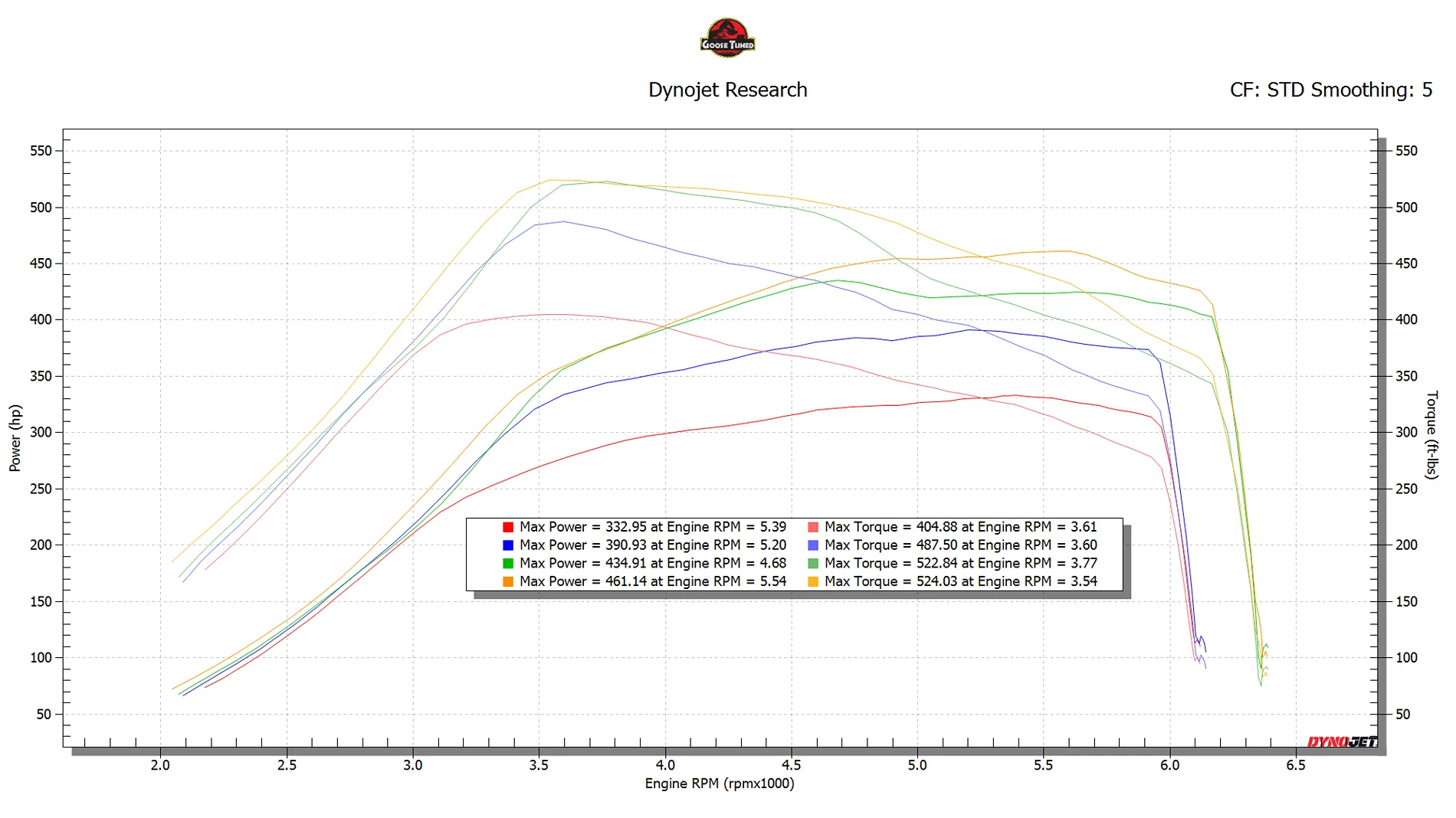

Naturally, loving ethanol, I decided to blend some ethanol in, and it picked up another 27whp!! I just carried torque out longer.
E40 GooseTuned
461whp 524wtq - That's +129whp and 120wtq over stock!!
Ford Ranger Goosetuned Tuning R&D - Ranger/Bronco 3.0 Raptor +300hp! Stock vs Procal vs goose S1 91 vs goose S1 e40

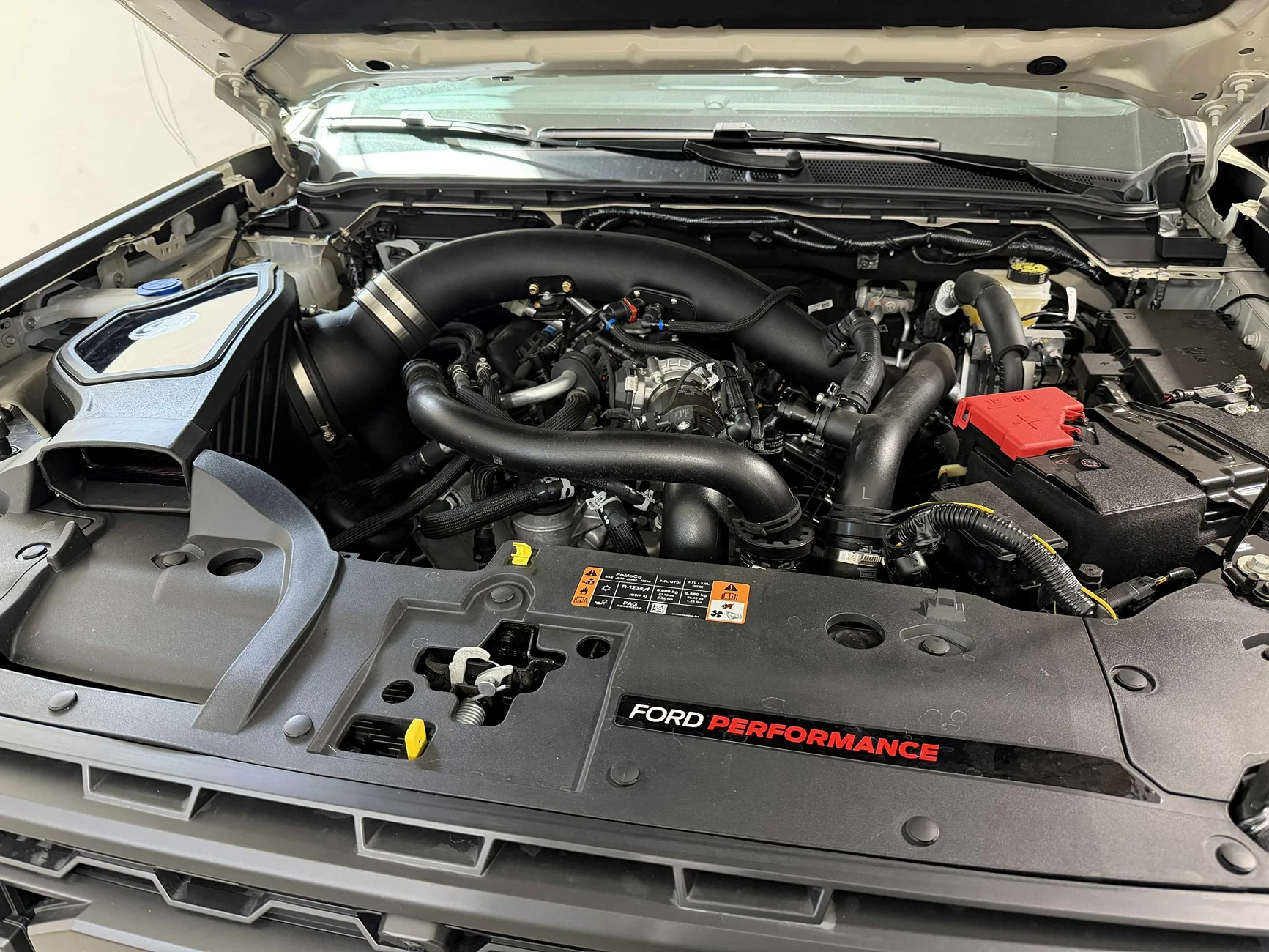

We've since installed an intake + intercooler, and will be getting back on the dyno soon.
