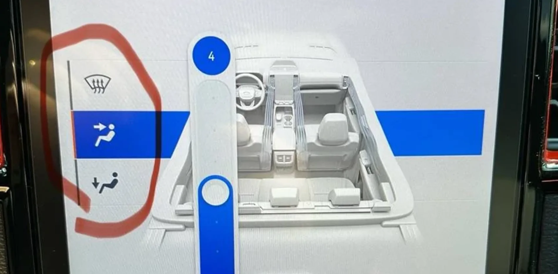

When in heat I like setting my air vents to all three locations. Defrost / regular vents / floor.
I have all 3 zones lit in blue when in heat.
Ford Ranger Heating issues 2024 RR 1766948740583-go
I feel the more your vents you have delivering the heat the more even it will get distributed and avoid the hot and cold swings your describing.
