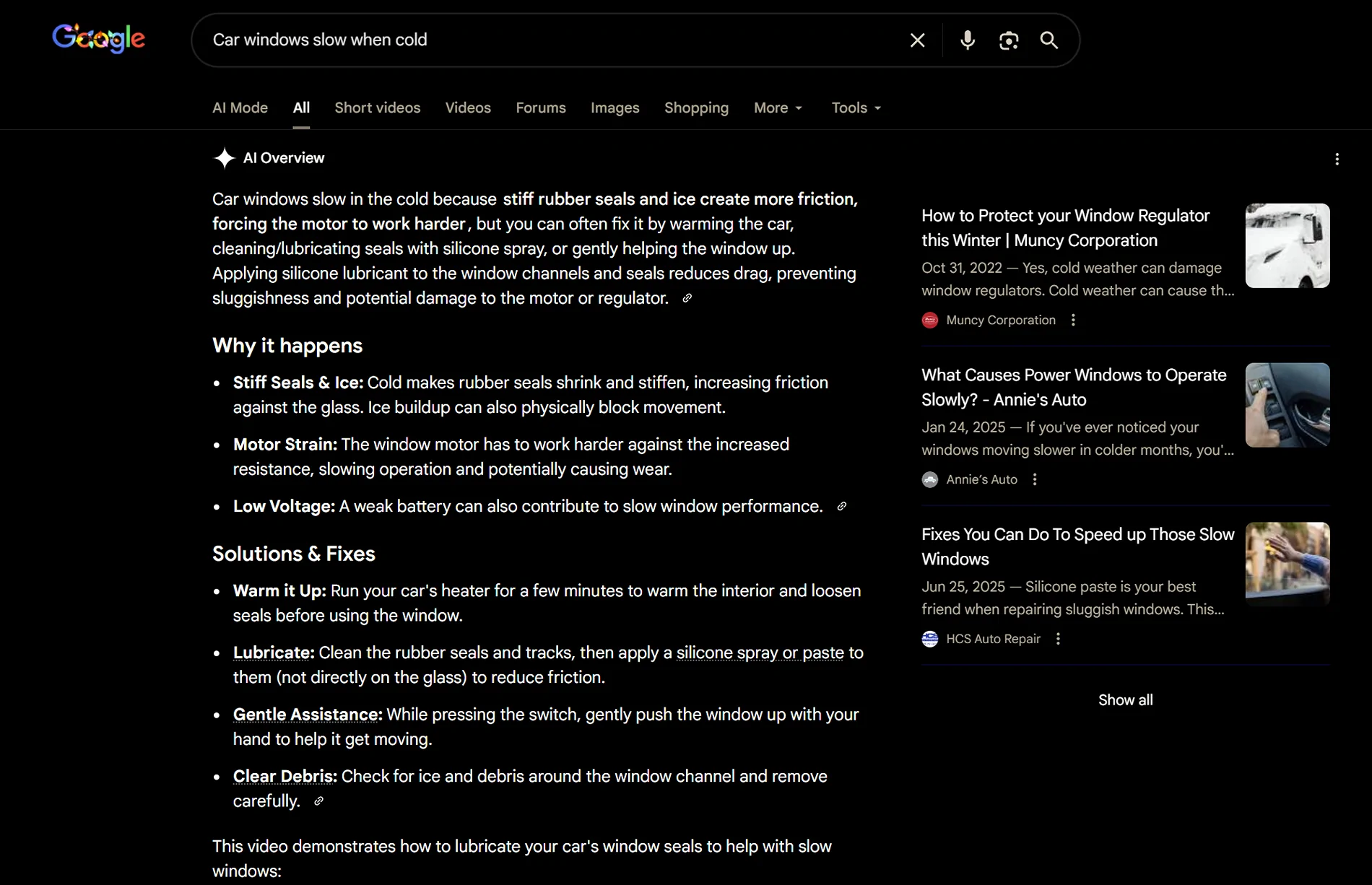

Pretty sure that's a common thing when it's cold out.
Thanks for the help. I'm in PA and it's pretty cold up here. It gets even worse when it get below 20.
I do warm the truck every morning for like 5 minutes.
I will try to get some silicone on the seals to see if that helps.

I'm in MN and the only time we put our windows down in this temperature is to get some hot coffee from Caribou.. lol
You're probably fine unless the windows are seizing completely.

After having this cold weather problem in a Subaru Outback solved by cleaning the window channel I thought the solution for the Ranger would be the same but it doesn't seem to be. I think as manufactures try to cut the wind noise on new vehicles that they have made the fit between the window channel and the glass tighter and I have to say that the Ranger is a fairly quiet vehicle. Has anyone tried spraying silicon in the window channel ?

Might need to have the grease in the window motor (regulator) replaced with a lower viscosity one. Not the answer you want, but it may be a "this is what works the best 90% of the time" engineering decision. Could also be a bad regulator?
