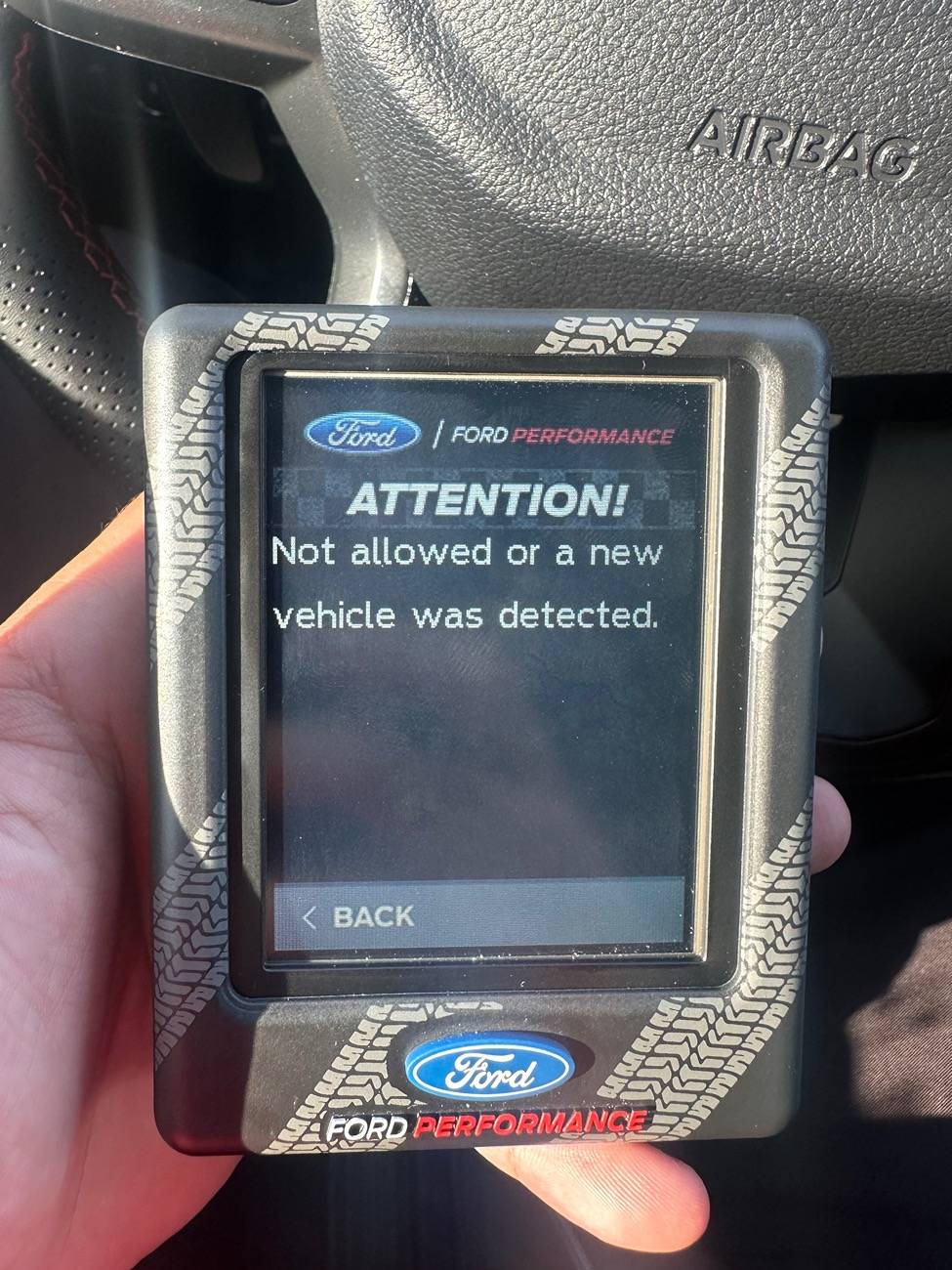

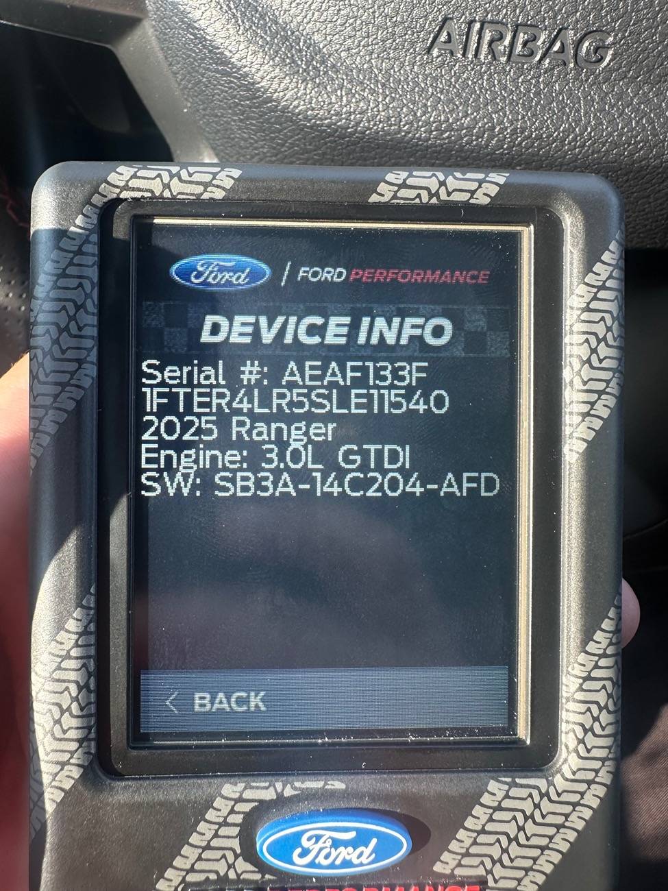

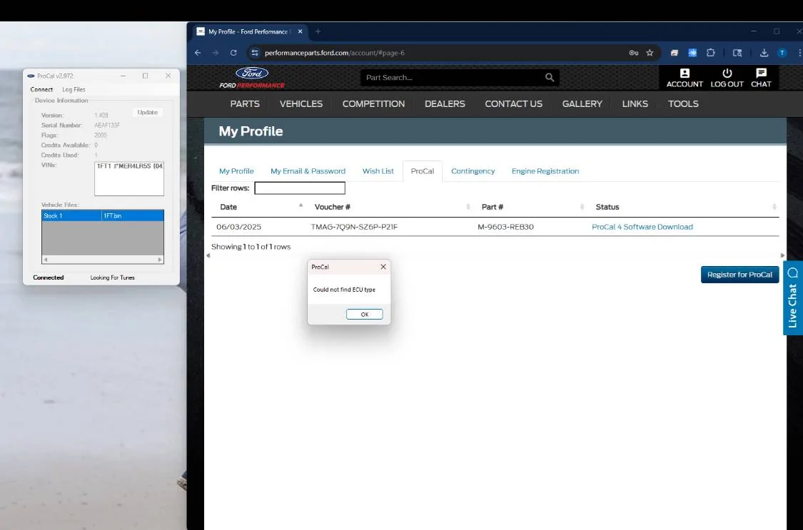

Hi folks, just got my new RR last week. Attempted to install a brand new FP procal 4 and once I tried to save the factory tune to the pc it coded the vin incorrectly. This screen on the pc is about as far as I can go. On the device it also has these messages.(attached) Anyone have a similar issue when installing? Have verified that it’s the correct kit also. I’m currently waiting for FPs response but and not the most patient person lol. Thanks and absolutely loving my new RR in marsh gray!

Everything prompted to the next step as if it did. The device showed the correct vin but the procal4 app on pc shows it with random spaces and characters. FPs tech line just asked for the voucher # so I’ve sent that over but still waiting.

Then if I try to do anything on the pc app it says to login, then says ecu type not found.

It shows this when I try.
I have heard of bad data cables causing issues while programming. Person reporting it did not say problem it caused as it happened at the dealership. The dealership ordered a new cable. In your case it looks like the tuner may have to be reset by Ford and possibly get a new cable or they could send you a new tuner.
Keep us updated. Best of luck to you.

!!!!!UPDATE!!!!!!
FD was able to clear my Procal4 software and the procal4 was successfully installed this evening!
Really felt like this truck is awake now! Excited for the system to finish its learning over the next hundred miles and see how it pulls then! But FD tech line was on top of it from when the issue started Tuesday night until today. LFG!!!!!!šŸ™ŒšŸ½šŸ‘šŸ½
