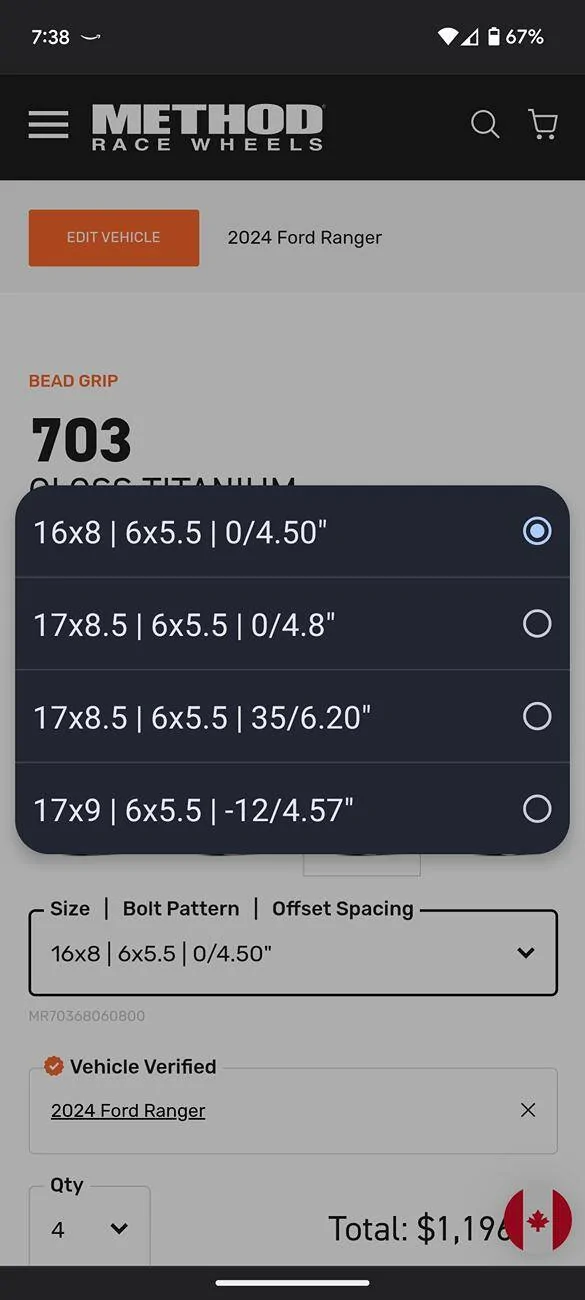

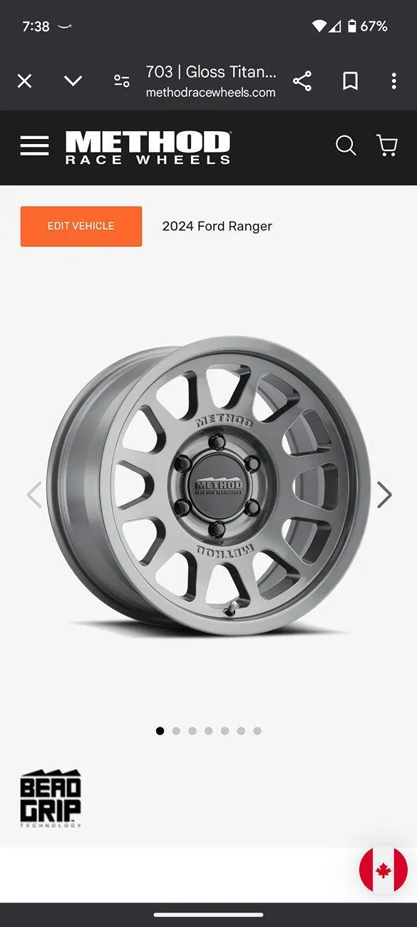

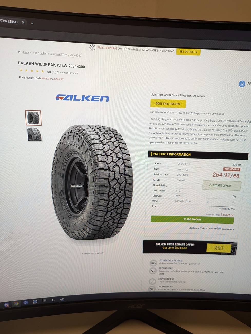

Gonna be swapping out my tires to a 265/70/17, want to go-to method rims, but what option do I pick? And what offset option?
Ford Ranger Help wanted, I what offset? Ranger FX4 Screenshot_20241009-193852
Ford Ranger Help wanted, I what offset? Ranger FX4 Screenshot_20241009-193844

Minimum +40mm offset but +35mm should also work. It doesn’t appear that Method makes a compatible offset wheel for the Ranger, they all say 0mm offset.
