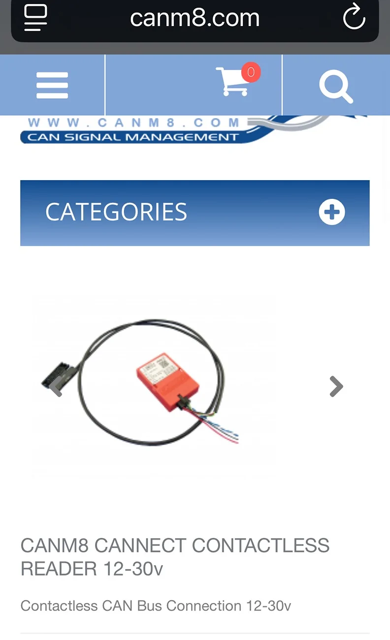

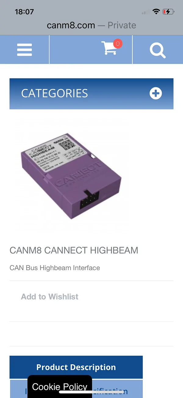

Have ya'll tried this. I know used, w/double relay for rally cars. Seems they can do much more for modern off-road adventure types. Nice to be able to aux switch, then have onboard lights trigger high/low for corner, flood and spot.

I've not seen on ranger raptor, but the contact-free (no splice) a great benefit. CAN Bus gets a little angry with splicing or tapping.
