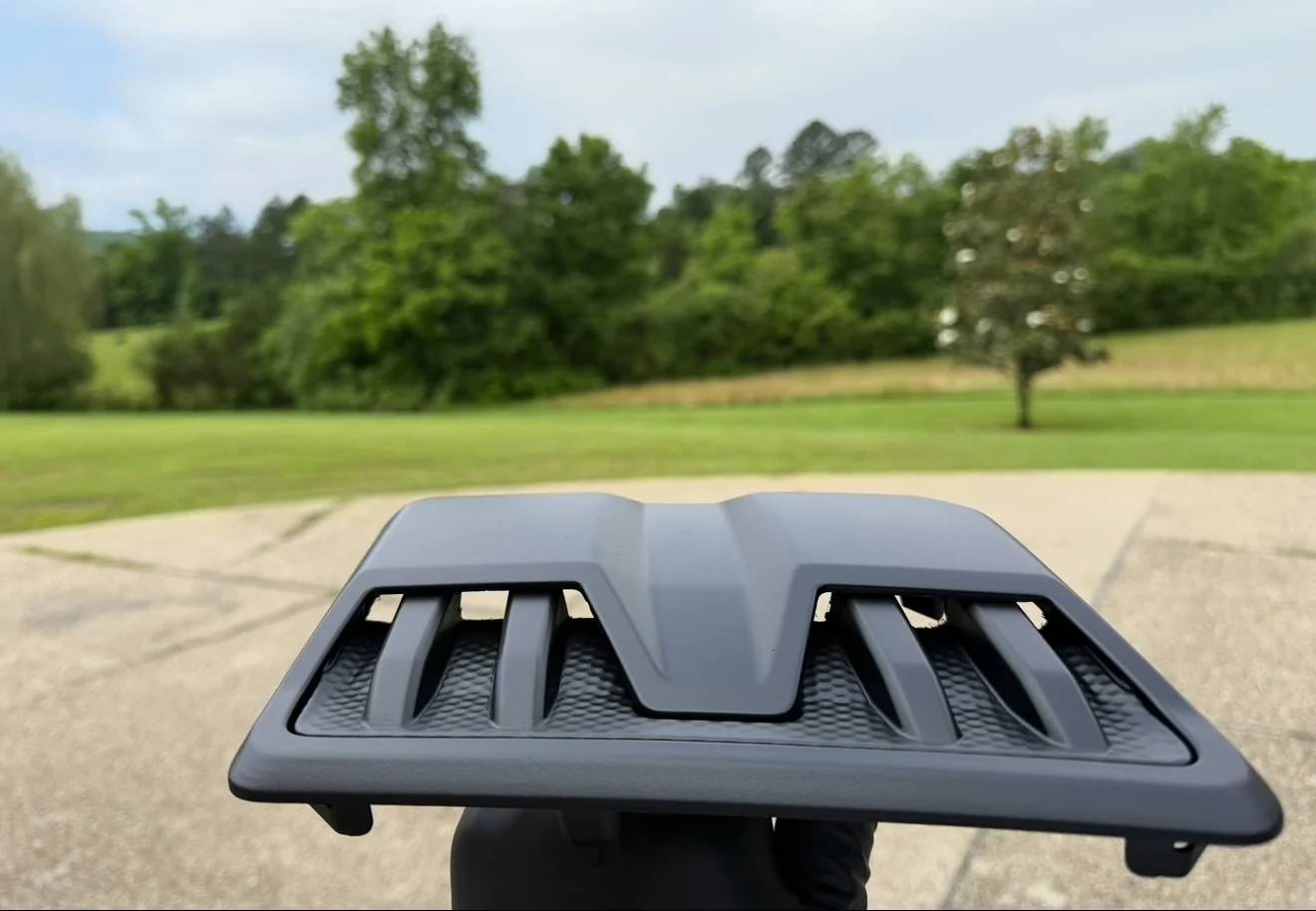

Indicarbon vents installed. Install was pretty easy. Side vents are only a small p.i.t.a as you have to remove the clips from oem vents to reuse. But they pop off using a plastic pry tool. The instructions say to pop out the fender liner and go from behind. Um, yeah, h*** with that, you do not have to do that. I can't believe they even would assume you'd have to do that.
Pros. Esthetically they look great. Lightweight. Fairly easy install
These are flow thru. Allowing heat to escape. Oem is not. Contrary to what I thought. They are closed off.
Cons. Hood vents, While they may be carbon fiber, the flow thru design leaves me hoping that no water will enter the vents. ( you can see the back of the oem vents. It has a spongy seal). I'm worried about possible corrosion on the hood with water getting in between the layers of metal.
Side vents are fine and look no different.
Overall I'm pleased with the purchase. I contacted indicarbon and let them know the concerns with the hood vents. For the cost is think the design could be a lil closer to oem quality.

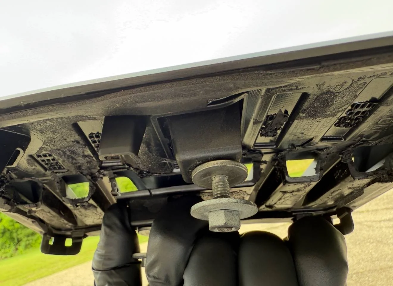

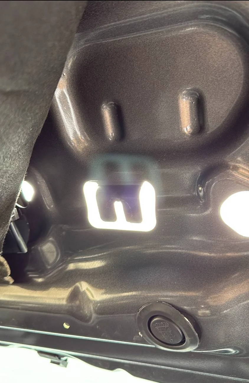

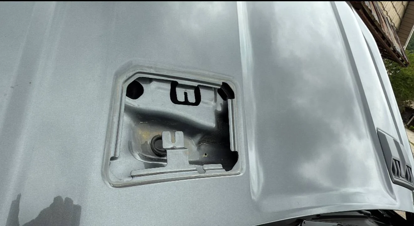

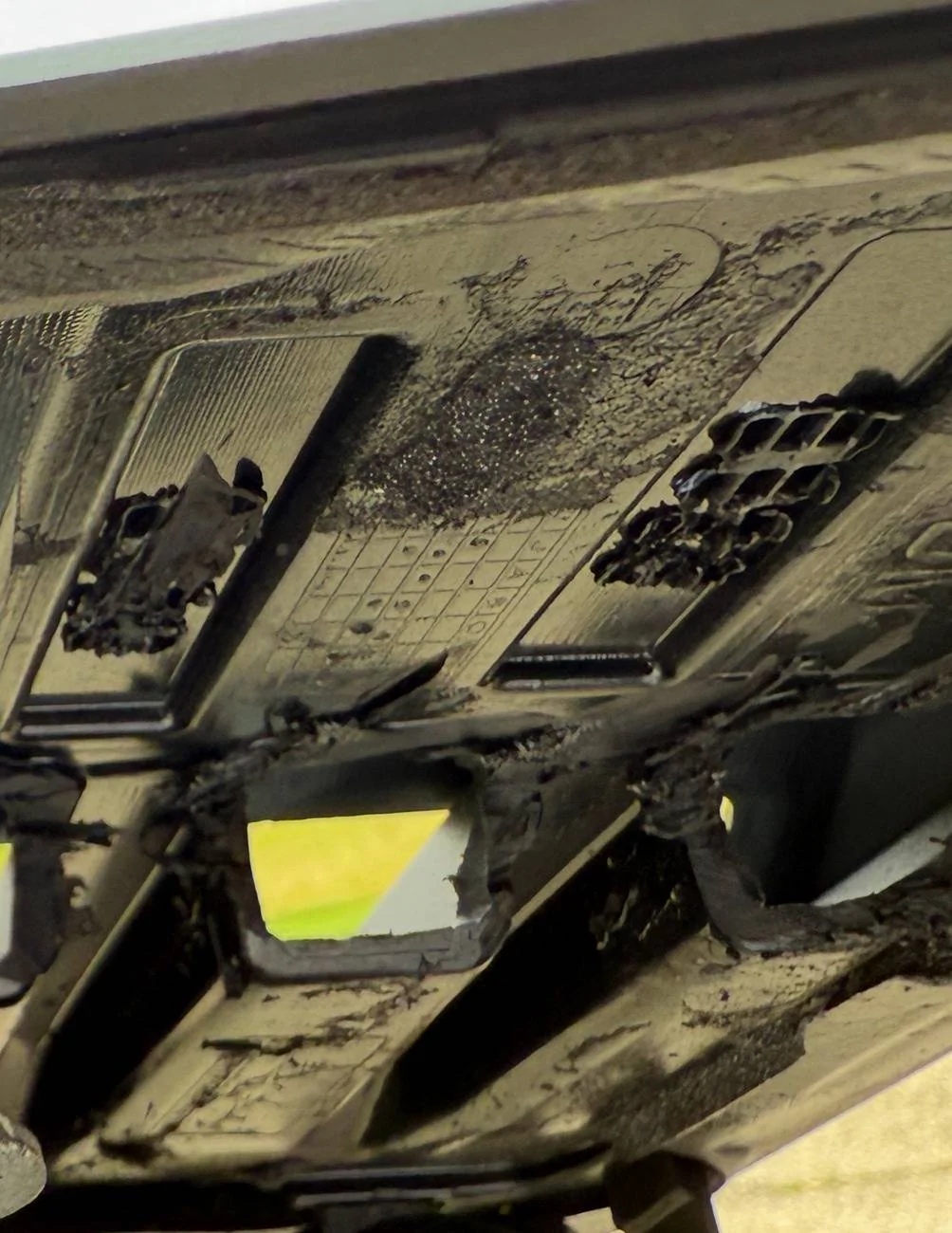

I did the poor version. Dremel tool and a file. If you look at the videos of the Ford Performance RR running Baja, theirs are completely open.
Hey Derrick, did you need pry tools to remove these? Did you cut away the sound deadener blanket under the hood as well? Any issues when water drips on the engine, like steam fogging the windshield?
Gracias!
No pry tools. I did cut away that section of the sound blanket. No water or steam/fog. Even ran it through touchless carwash a few times to check. My bedcover leaked, but nothing else.

Thinking of doing the same, did you notice much difference temp wise by doing this?
I wonder if the ones in the front arches may make more sense as the hood sounds material isn't in the way?
Both sounds good to me. Temps on my air intake stay closer to outside temp at idle, maybe helped 5 degrees or so there, up at speed seemed to help a bit more. I run a filter thats open on each turbo

Finally got around to opening the 4 vents up, also removed the sound insulation so it's fully open now.
Runs cooler for sure, once heat soaked also drops temperature way quicker once on the move again.
Side benefit, you can hear the turbos way more now, super cool 😎
