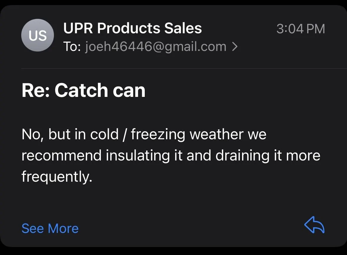

I emailed upr, this is there response
Ford Ranger insulating upr catch can from excessive heat IMG_9808

I’ve never insulated mine. And i ran my mustangs hard. Always collected a good bit too.

yea. Never ever heard of insulating a catch can until i saw it on this forum!
Neither have I. Never insulated one on several automobiles.
UPR may tell you to insulate to stop it freezing overnight in zero temps but as long as the CC is emptied regularly, there’s not an issue with one that is partially filled.
Soon as the engine warms up the condensation unfreezes. As long as fluid level is not equal to the inlet or outlet hoses, there’s no issue.
If the CC hasn’t been emptied for quite sometime and is full, then it will cause a blockage of the crankcase ventilation system.
Northern tier states with sub zero temps, I’d personally remove it during the winter months.??
