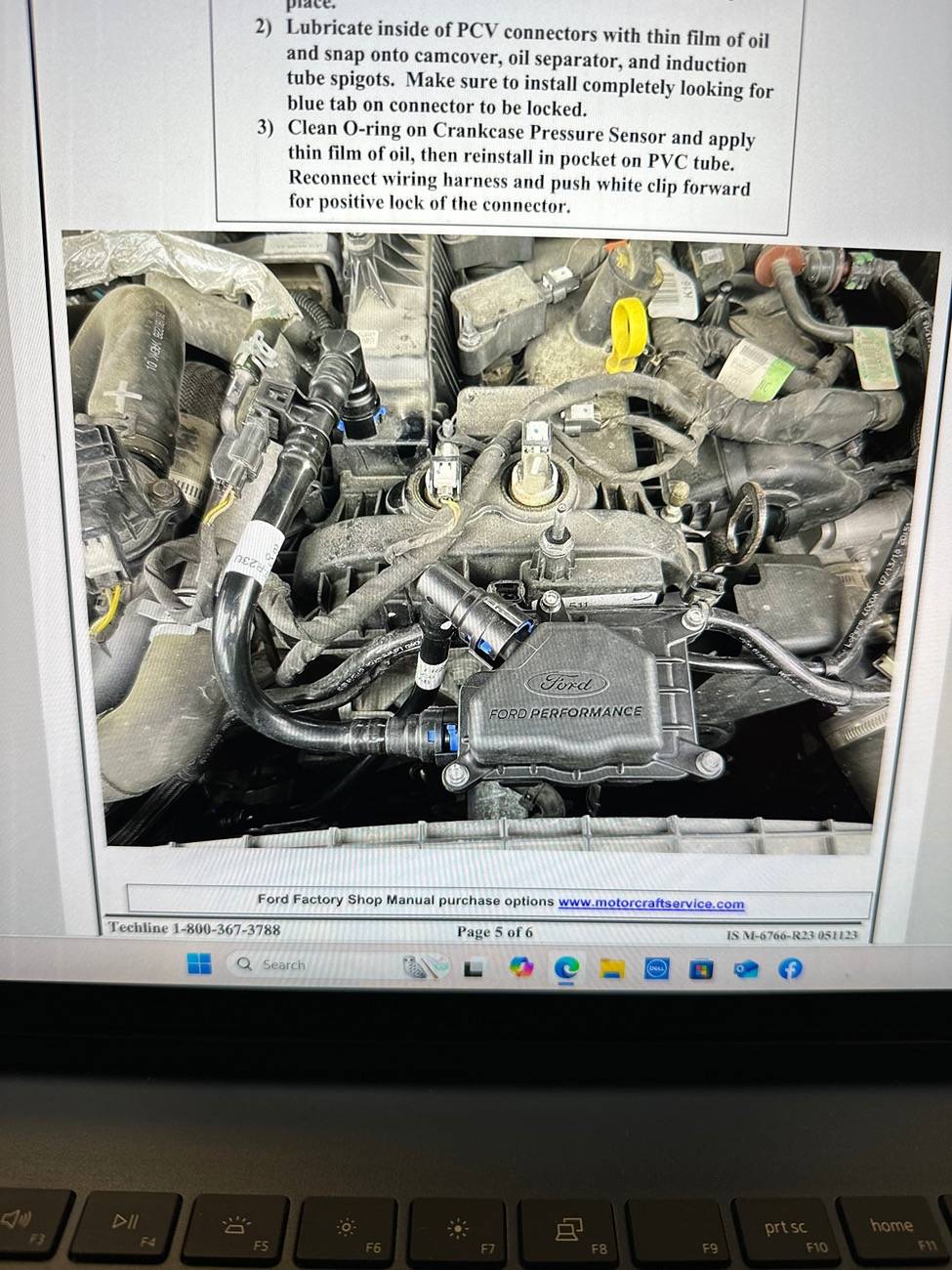

buddy of mine said after i told him i installed the upr on my 24 ranger 2.3 that i could also add the ford performance catch can to?
would it really help that much?
The Ford one would connect in the same location. You wouldn't be able to have both.

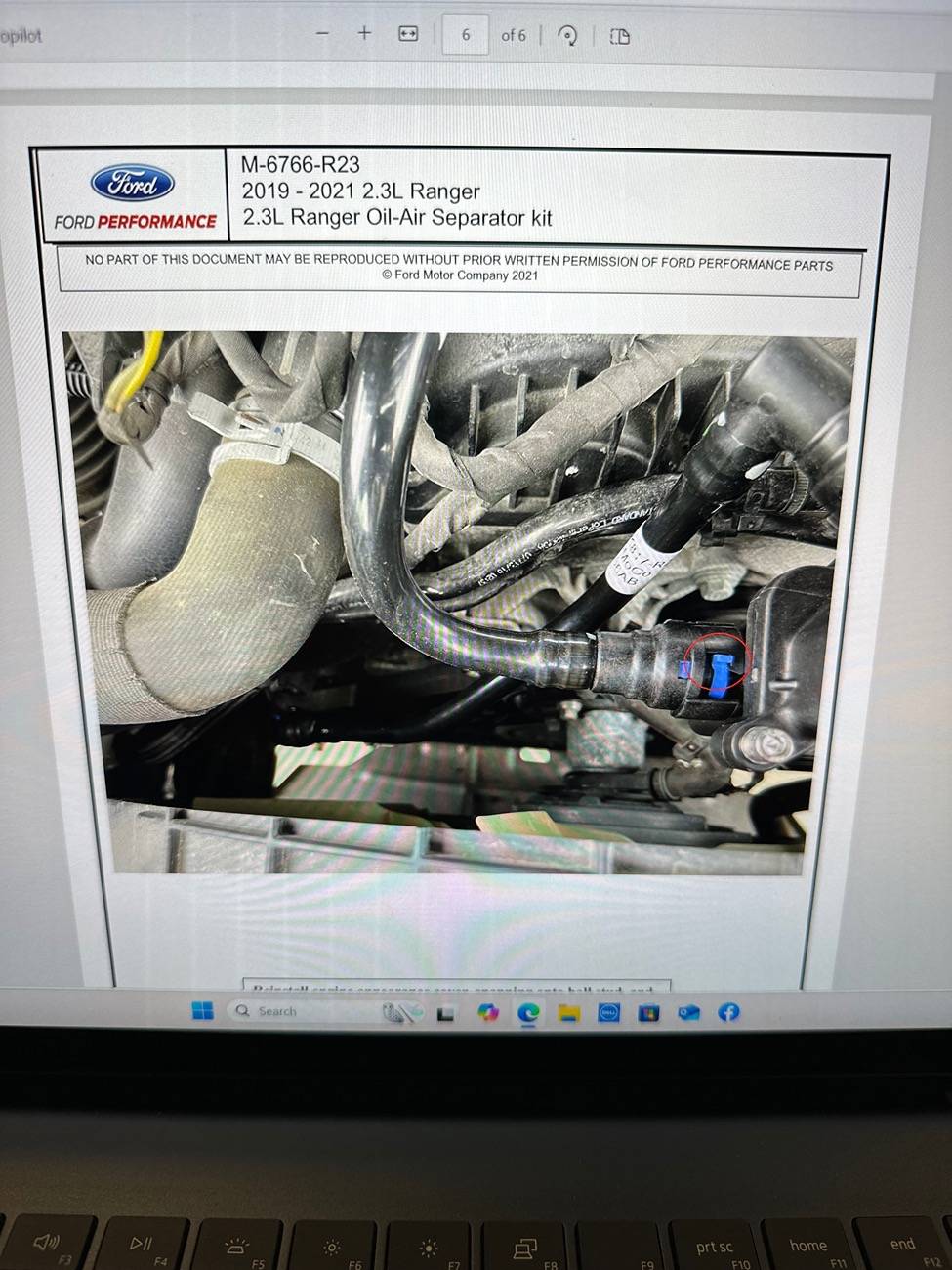

according to the installation instructions it hooks up in different location?
Well that makes very little sense. It should connect in the same location.

Maybe I missed it, but I didn't see how it was hooked up. That being said, I don't really know the 2.3 engine as well as you do, so I trust you in this regard.

since the ford catch can mounts in a different location,just wondering if i can use it along with the upr catch can that mounted on the drivers side
The big question isnt necessarily where they mount, but if they connect to the same locations. This is where my confusion was and why I was skeptical that you could run both at the same time. I dont know where the UPR connection locations are compared to the FP version. Thats what you have to figure out.
4,087
3,977
That would be odd to have to run them in sequence if they hook to the same spot.
