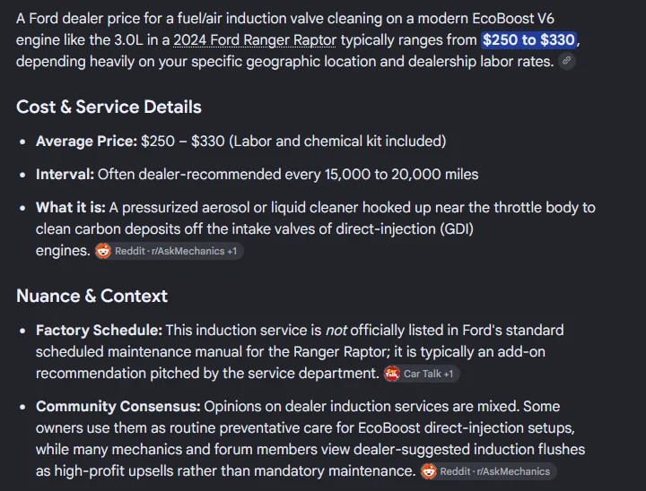

does this seem accurate? Just asking for my future self....

the price looks about right, i just paid $321 for the service at my local auto mechanic, dealer is similar price. in my opinion, 300 bucks every 20,000 miles is a lot to be honest and the more i think about it, i think a walnut blast ever 80,000 to 100,000 miles for around $800-1000 will be less expensive and get it back down to bare metal and do a better job. I'm still excited to see how well this servce does for my truck but i think i'm going to end up going the walnut blast route just for the sake of saving money in the long run. That said, i may also look at buying the BG equipment to do the chemical service myself it it really does do a good job. More to follow.

Just my opinion. If this cleaning is needed every 15K to 20K miles, there is something seriously wrong with the build of the engine.
