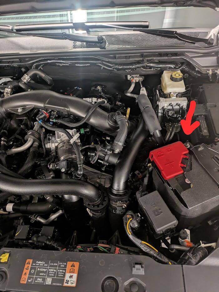

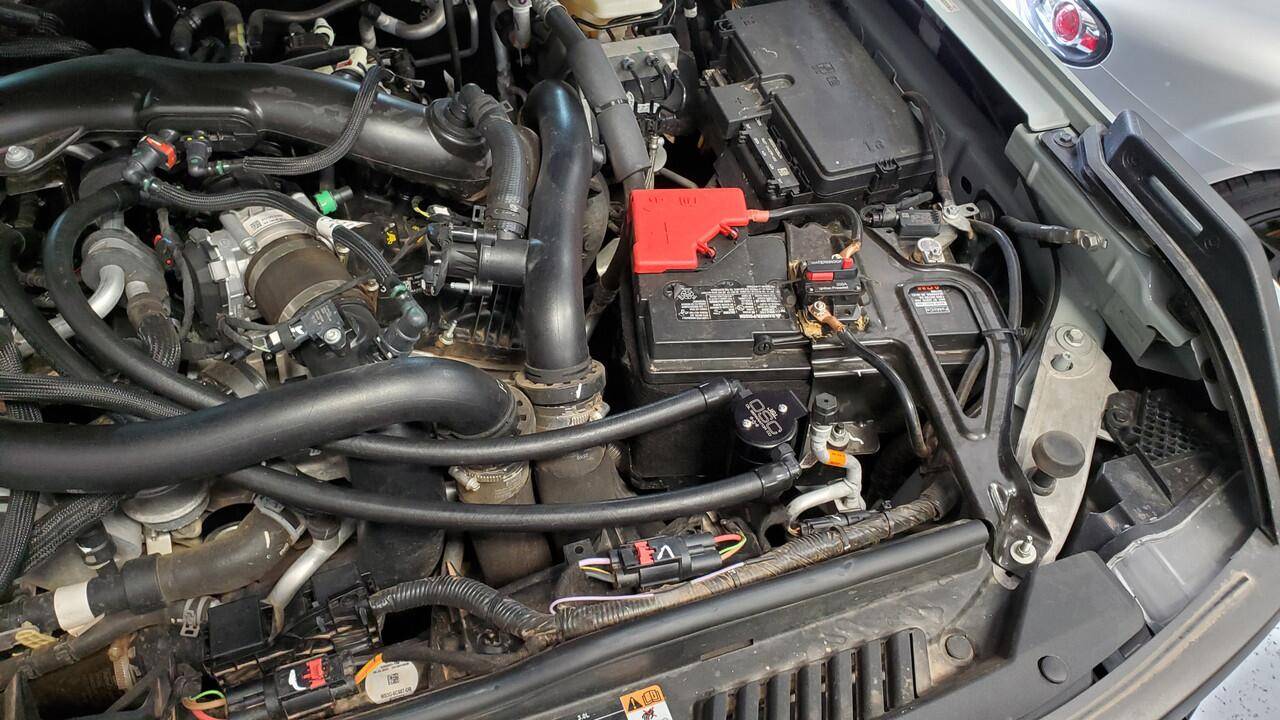

I answered my own question and got the verification from J&L. The orientation of the battery is a little different from the Braptor to the RR. It does appear that it is a bit longer distance from the mounting point in my RR as it is in the Braptor.
here's one mounted in a Braptor:
Ford Ranger US Raptor Best Oil Catch Can? 1742399928795-yq
And here is a pic of my Ranger Raptor's bay with the arrow pointing to where the same mounting point is located that J&L used for the Braptor:
Ford Ranger US Raptor Best Oil Catch Can? 1742400008255-q1

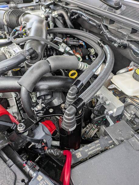

Another plus with ordering a catch can/separator, it's one of those things that just installs in a snap. Nice to have something go in without a problem once in a while. Also nice that the way that the UPR system mounts allowed me to go right over top of the cutoff switch for my winch.
