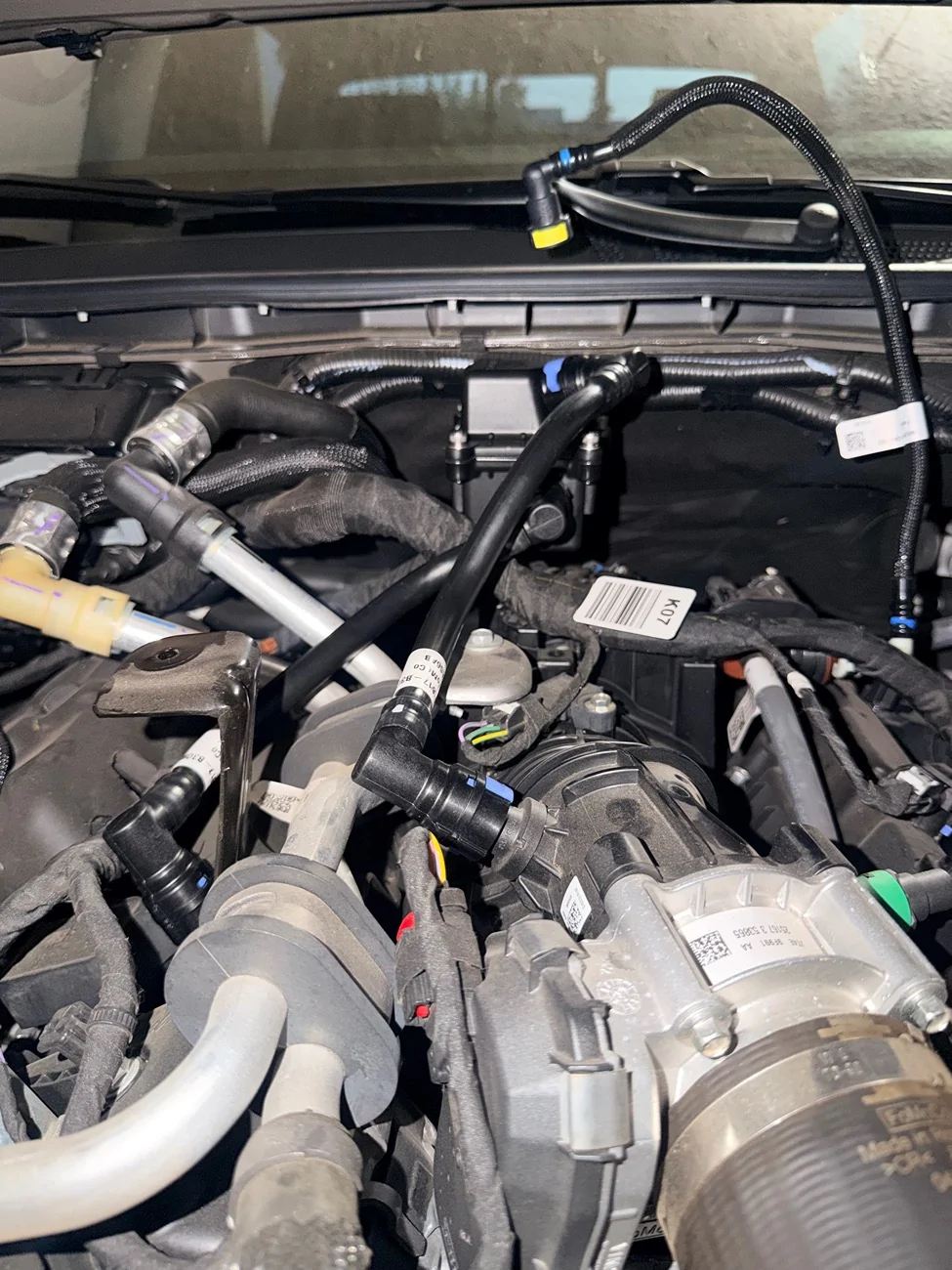

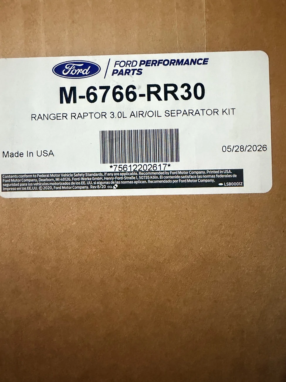

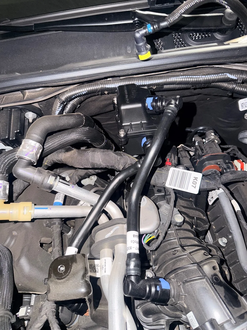

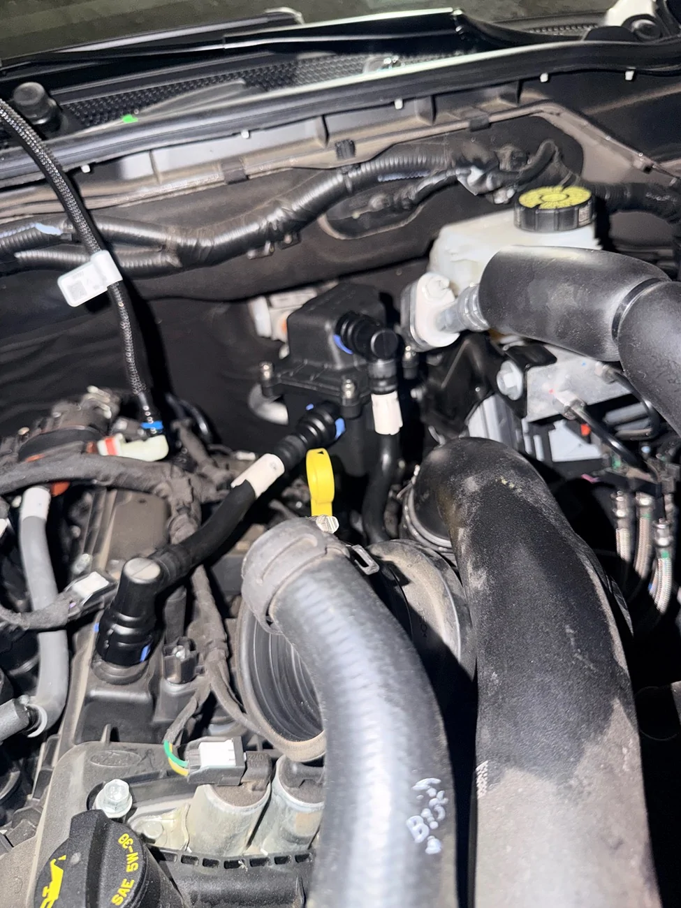

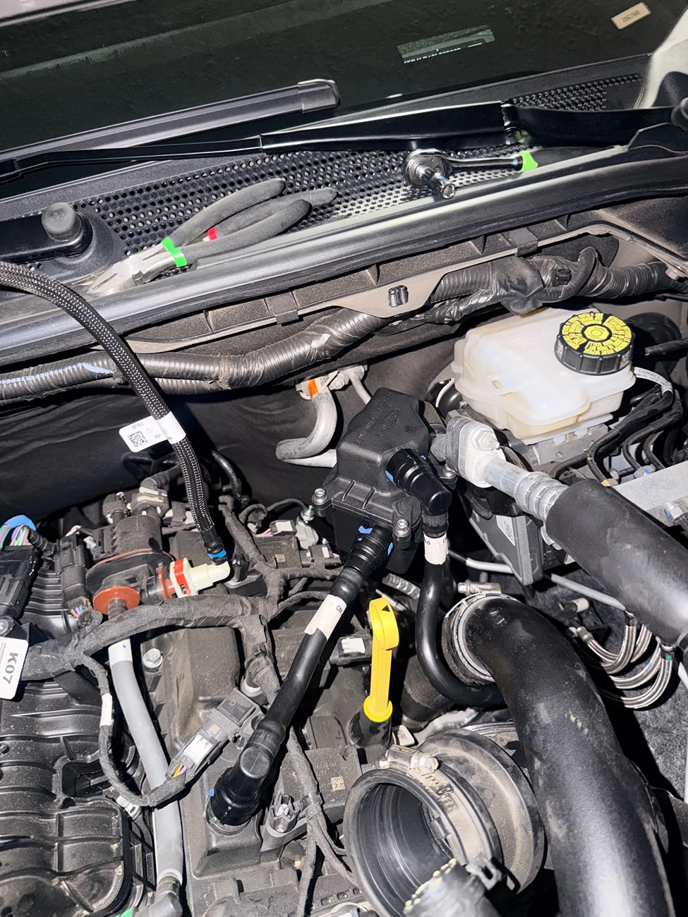

I installed the ford performance air oil separator kit aka catch cans for a 2025 Ranger raptor with a late year build date and they fit perfectly on the listing it says it won’t fit but it dose incase any one wants to order them

Your good to get it if you want it it’s a tight fit on the driver side with a ac line but it shouldn’t hit havnt really put to much miles to confirm that but if it dose hit a 3m foam pad or something like that would be more than enough
