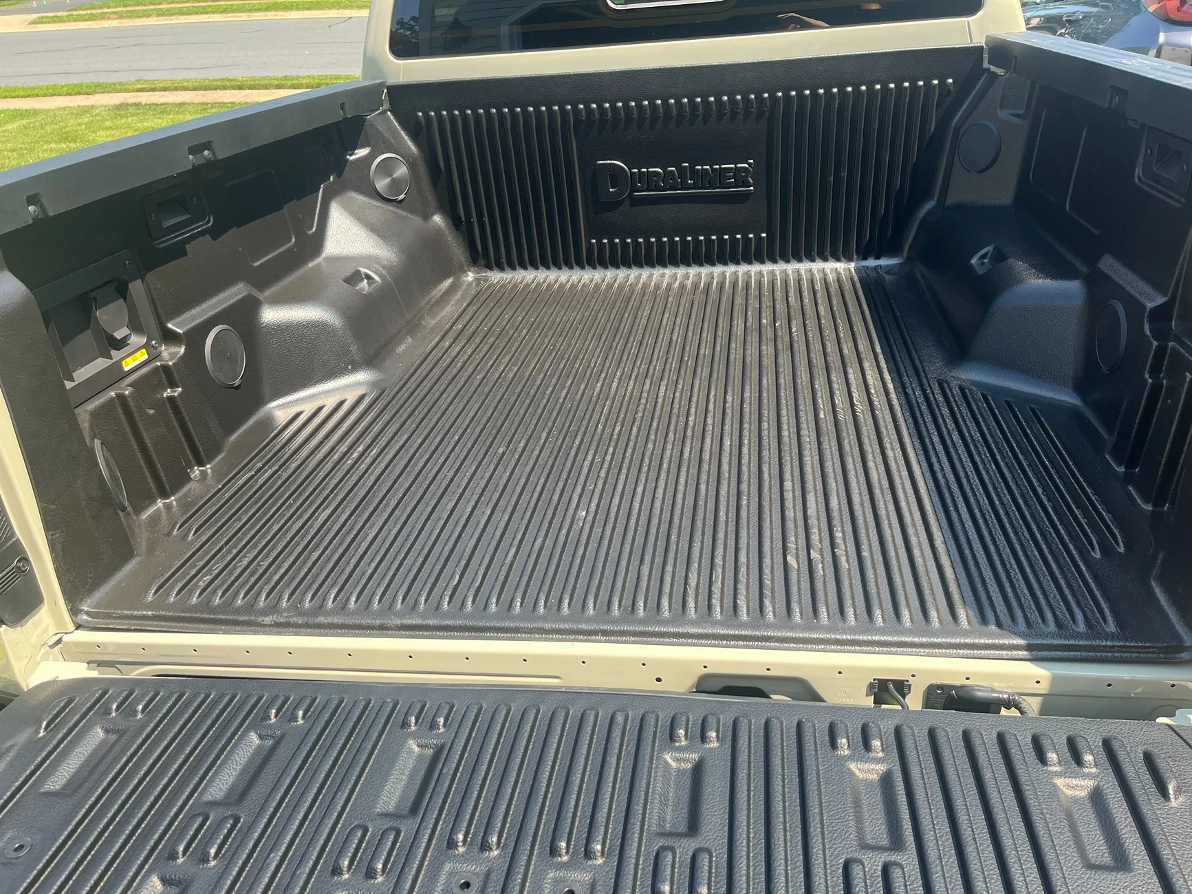

I did the DuraLiner drop in. Much cheaper and takes literally 10 minutes to install. Super easy.

RangerPA. This one?
https://www.penda.com/product/dural...-liner-year-2019-2023-bed-length-50-63105srx/
I just wrote them to see what shipping would be for me. I need a back up plan, and looking at this one if I'd known about it I would have gone that route. I'm in a time crunch trying to get ready to drive to texas to pick up a camper. The tonneau is sitting here waiting for us to install it......bedliner probably best to go in first.

Yep, looks like the same one. I had the local DuraLiner dealer order it and shipping was free (under $300). I let them install it for a small fee. Like $350 all in with shipping and installation. For the install, they had to cut out the bed lights section (4 screws each light) and the power section (4 screws). The body facing side of the liner has a guide line so you know exactly where to cut, super easy. Then it just pops in and you put the bed lights and power section back in and you're done. The tail gate is about 8 screws with some depth inserts. After that, just pop in the rubber circle inserts over the tie down bolts. The great part is you do not need to touch those bolts, making the install just 10-15 minutes.

No local dealer for me. I'll give the Ford dealer until Tuesday afternoon, if not done, then will order the Duraliner....shipping is sadly $185. I'm running out of time.

Maybe there is a dealer on the way to your destination. A lot of 4x4 shops sell DuraLiner.
