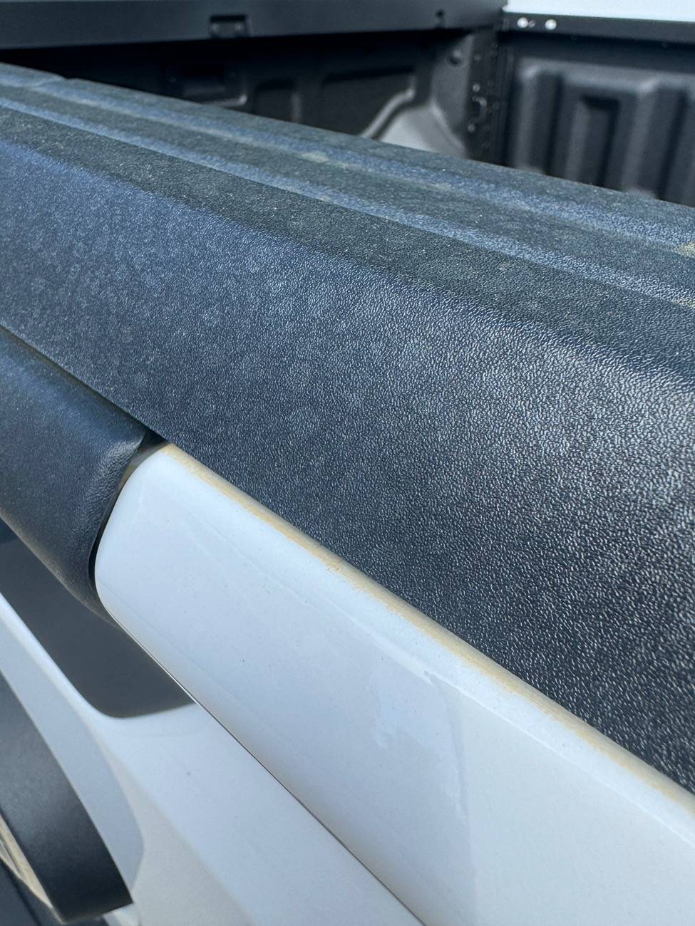

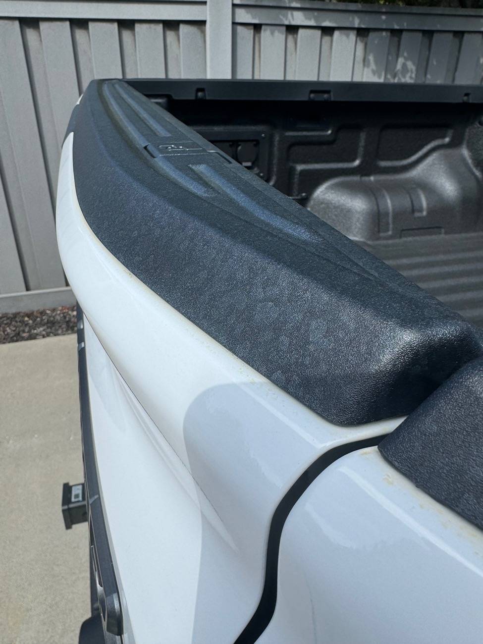

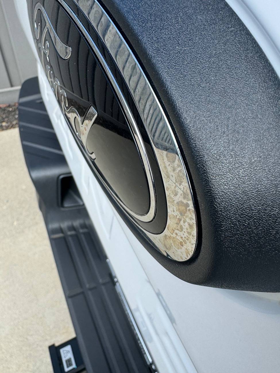

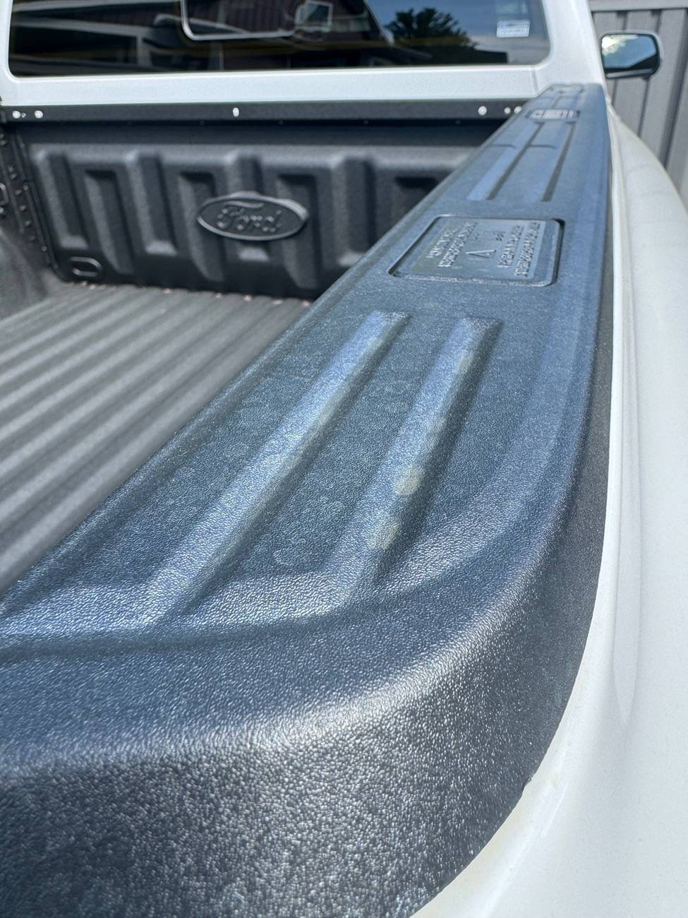

I know a lot of us whose trucks were built in January / February have rust underneath on the driveline frame and suspension. Has anyone have stains on their glass and plastic (bed rail cops) ? Mine is really bad the dealer did a good job on delivery and re washed it again it’s still there. I have washed it and tried some mild chemicals but I still have the stains it’s like hard water. Any ideas of a chemical that will help remove this?

It’s like hard water and rust

The chrome is easy to fix. I would use '0000' steel wool. It is very fine and should not scratch. I have used it on glass and chrome on my cars without any scratches. But definitely, give a small test area to be sure and no need to press very hard. Again, '0000' steel wool. The fewer number of '0's the more abrasive it becomes.

Mix 1 part regular white vinegar with 1 part distilled water (soft water is good too). It's better not to use regular tap water which contains minerals. Apply the vinegar/water solution with a spray bottle on to the affected paint finish. Allow mixture to work for up to 10 minutes.
How does it work on the plastic?
Works on any surface to dissolve minerals/contaminants that have embedded/stained a surface on the vehicle. If it doesn’t work, it’s something else. Possibly a petroleum product that your truck was hit with.
The mixed solution is your best first step.
