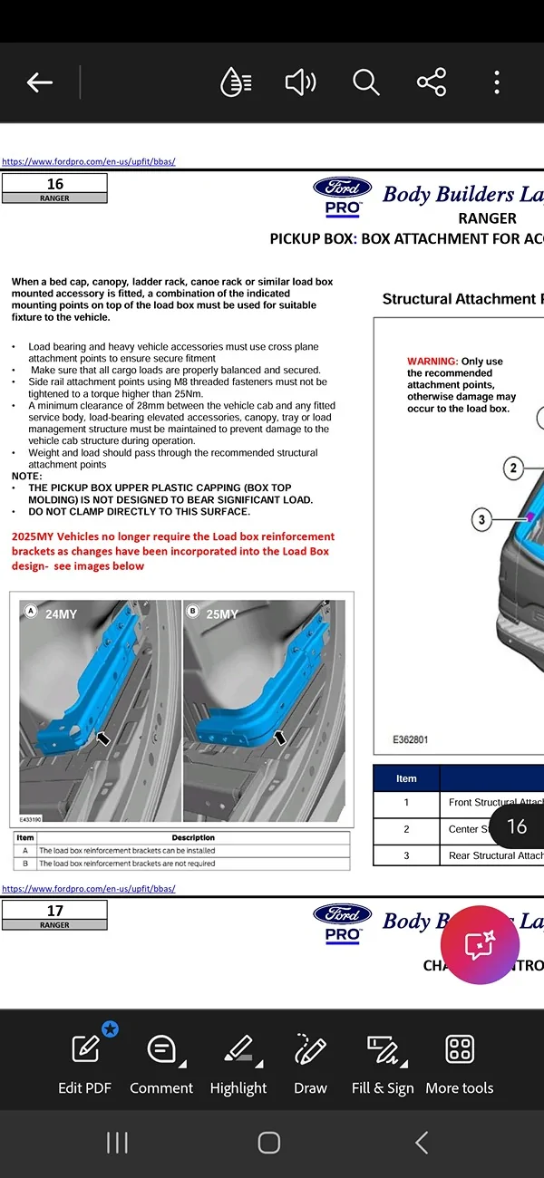

Just for safety and reinforcement, can we still add the j braces to the new bed design?
The rooftop tent I'm planning to use plus the rack is close to like 250lbs or so.
ShadowDragon24
Apr 20, 2025
665
621
2025 Ranger XLT Fx4
Heavy Equipment Operator
negitive. the bed ribs where the j braces go are completely redesigned.
