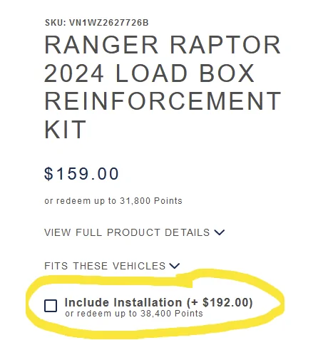

Doesn't Ford have basically pre-established rates for installation of accessories like the J-Brace? On the Ford accessories website you can add installation to the order of the brackets for $192. I'd be willing to bet the dealer thinks the install isn't worth the $192, so they just decline to do it.

You can purchase the J-braces and include installation without paying a single dime using the FordPass points you get when you buy a truck. You don't need to pay anything out of pocket if this is that important for you to get on your truck.
The question becomes can the dealer charge additional istallation charges in addition to the $192 or do they have to honor that.
I asked my dealership for a qupte to install the braces and they said $412, which does not include parts cost.

So, got them installed at my dealer paid like 1.6 hours cost about 300$.
Part was 160 or wtf ever.
Top of the bulliten states. "Ford recommends the installation of the part for extreme off road use".
I read that part of course I start with, my ranger raptor off road performance truck is missing the part you recommend. To which she agreed and she told me to send the invoice to ford customer service. Ill add the address for this on here so you can send your invoice, complaints, threats of how you spent 70k$ on a truck you cant use as a truck until you wait months for a bracket.......and a month for a tech to get to it.
