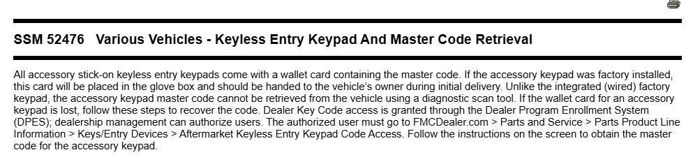

Thanks for this info!
1 The factory code doesn’t open the doors so there’s that.
2 Following your steps, entering the factory code and pressing 1 2 does nothing so I got stuck there.
I think I just don’t have the “real” factory code somehow. I’ll just have to go back to the dealer :/

That’s your best bet…….make sure they know it hasn’t worked from new. May save you some cash.👍🇺🇸
Pete6114
Sep 20, 2024
Ontario Canada
The card with instructions were in my glove compartment and do work. The card on the fuse box behind the panel in the drivers footwell has a different 5 digit code from the one in the glove compartment and does NOT work. Used to be easy to retrieve key codes for the pads that are hardwired. Rangers just have the cheap stick on, battery operated pads and i guess that's why the dealer cant find it. Wondering if they have to replace it with another color matched of course...
