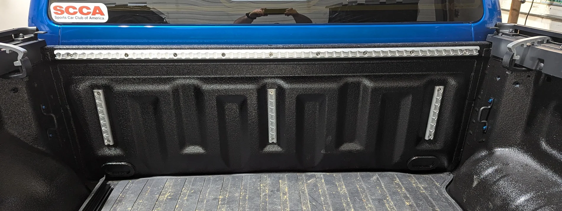

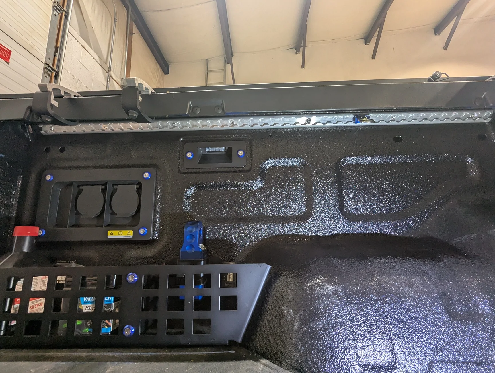

I did something a bit different in my bed. I put one strip along the top inside edge and then a couple of small strips on the front bulkhead, all through bolted with fender washers or using existing holes. I then also put strips under the rails on the angled part using a mix of existing holes and some rivnuts; these upper rails aren't going to hold tons of weight because of the rivnuts, but it's great for just keeping things from sliding around the bed.

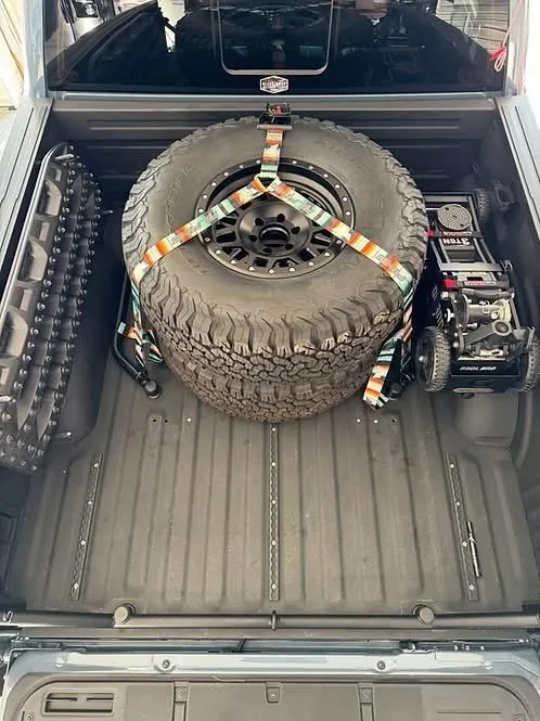

I just measured it looks like the tracks will be a tight fit width wise in the valleys of the bed.
Also I was planning on doing 3 long strips. One in the center and 2 on the sides evenly spaced but the center one can’t be centered which is going to drive me nuts.
Lion77
Feb 27, 2025
36
1,041
1,580

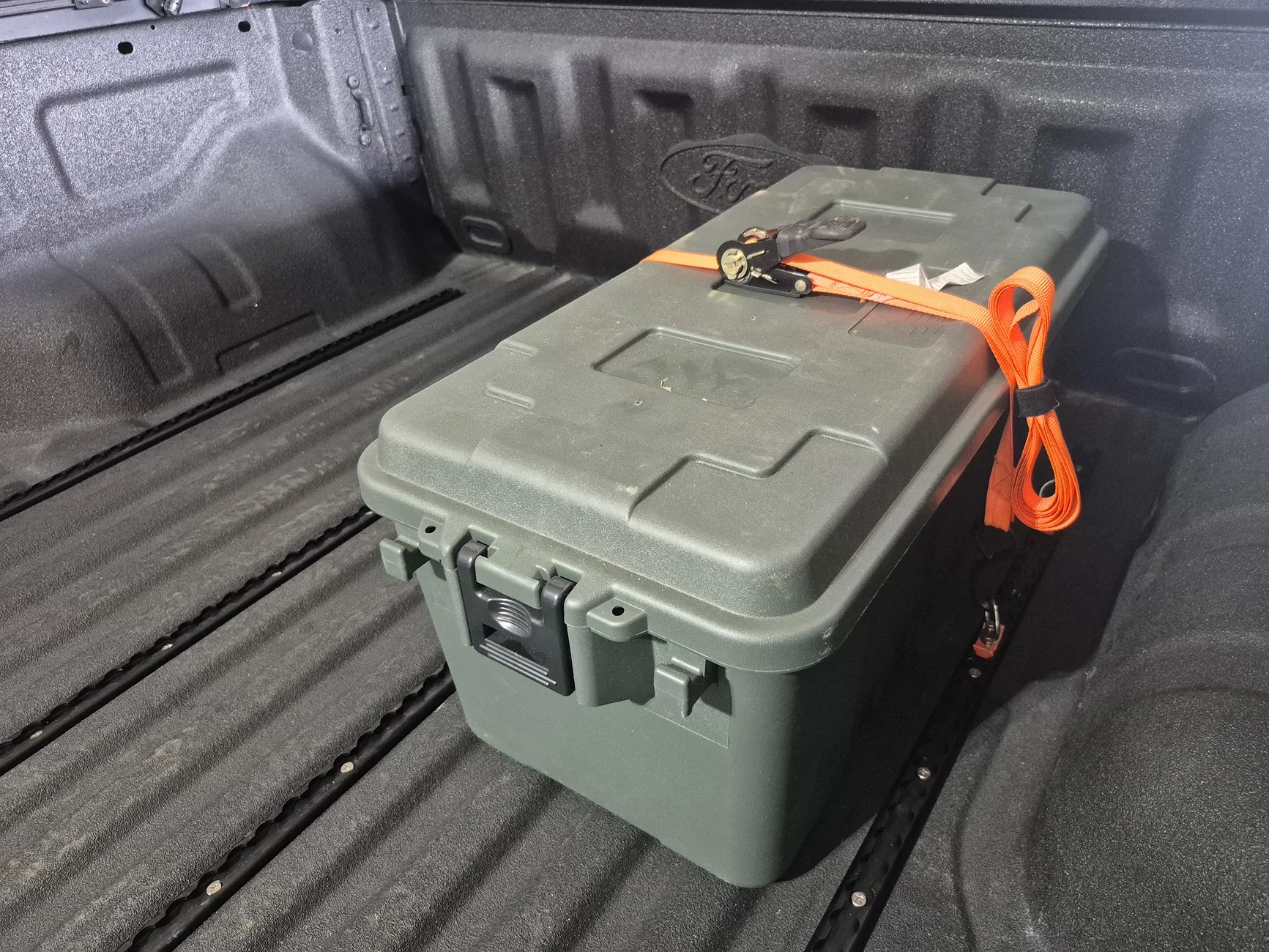

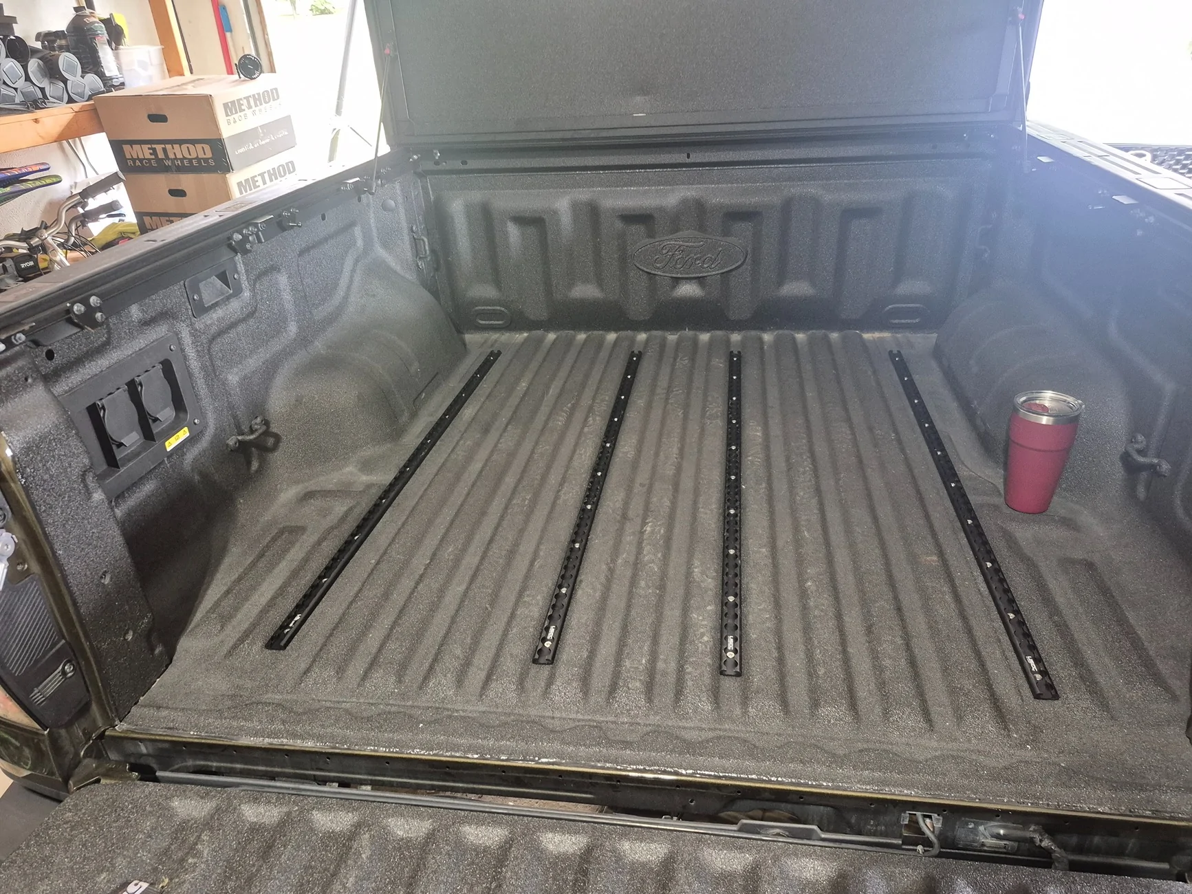

https://www.ranger6g.com/forum/threads/race-aircraft-style-l-track-install.31256/#post-460108
Take a look at my approach to using L-track. I did 4 strips with a slight variation in spacing, center two are a little closer together than the outer two.
This allows for a variety of configurations and sizes of cargo. You can mix and match, strip 1 and 3 or 2 and 4, or 1 and 2 and 2 and 3 etc. You can go straight across on the strap placement or do an X pattern for roundish cargo etc. Could even go from L-track to a tie a tie down.
But more or less this gives you a grid pattern to work from in terms of the stud placement when you hook them into the track rails.
Also when you have multiple heavy items your less likely to over load a rail. If you only do 3x rails, but are using all 3 strips, the center rail is taking double the load of the out rails. By using 4x, you can use them in pairs.

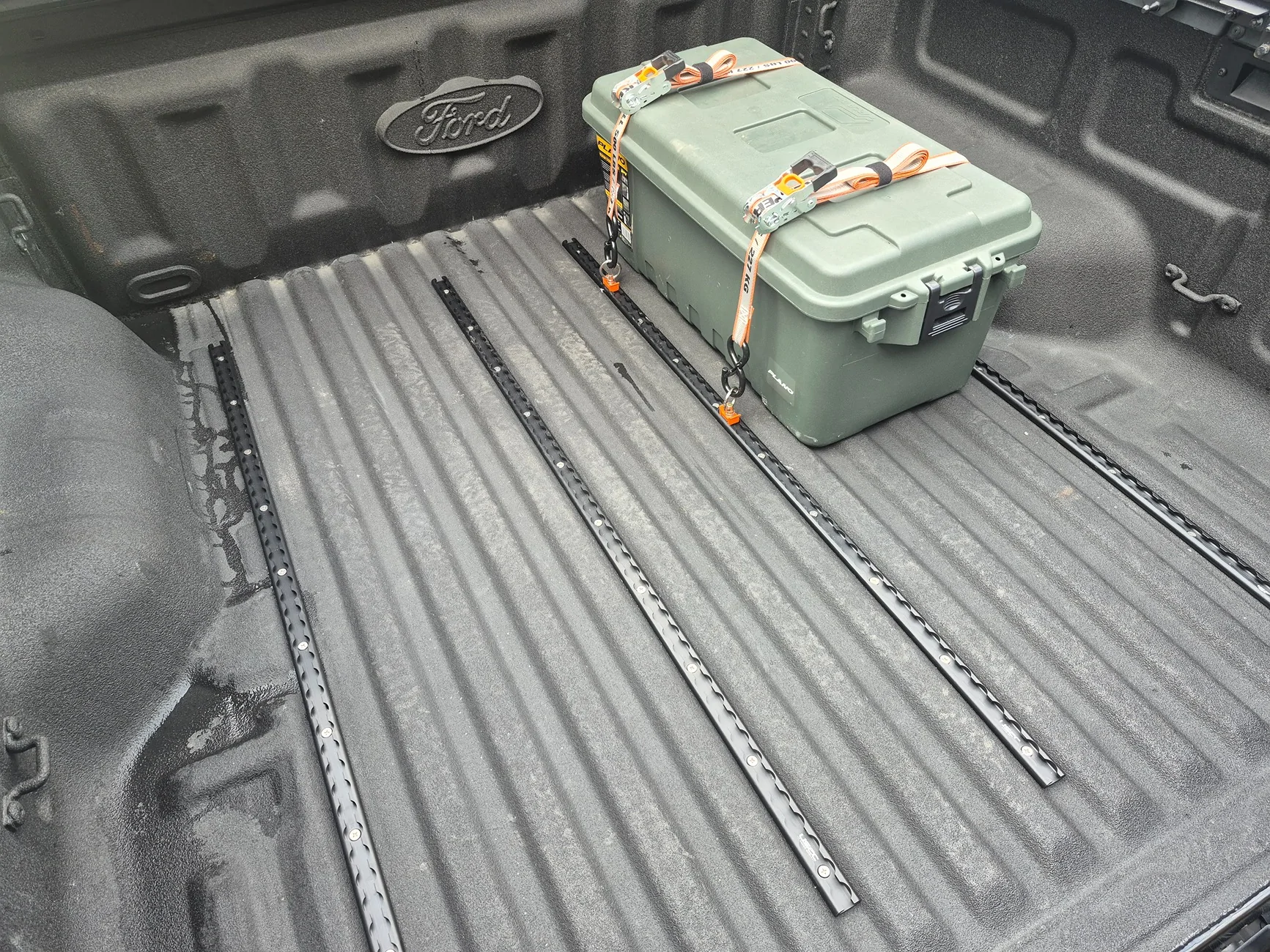

The US Cargo Control standard L-track fit perfectly between the ribs in the bed. Not sure about other brands, but those work and I personly like the black anodizing, but also offer them in raw aluminum if you prefer.
Their standard L-track has round chamfer in all four corners (bottom and top), they literally fit exactly in between the ribs in the bed.
I like your little storage caddy next to the wheel well. Who makes that? Also noticed your blue anodized nuts...is that just for aesthetics, or are those hex heads?
ADVNTURR
Sep 6, 2024
187
394
Cleveland, OH
The bed pockets are pieces I designed and had made. The only company I know making something similar right now is Pirate Camp Co out of Australia, but I am looking into making more of my design to sell.
The fasteners I am using are all from a company called ZSPEC Design. They sell mostly engine bay dress-up hardware but they also sell everything lose so I just buy it for projects to add a little custom touch (everything they sell is also either stainless, aluminum, or titanium so rust isn't an issue). I replaced the tie-down torx-plus bolts with hex drive titanium ones (they're about the same tensile strength as the factor bolts).

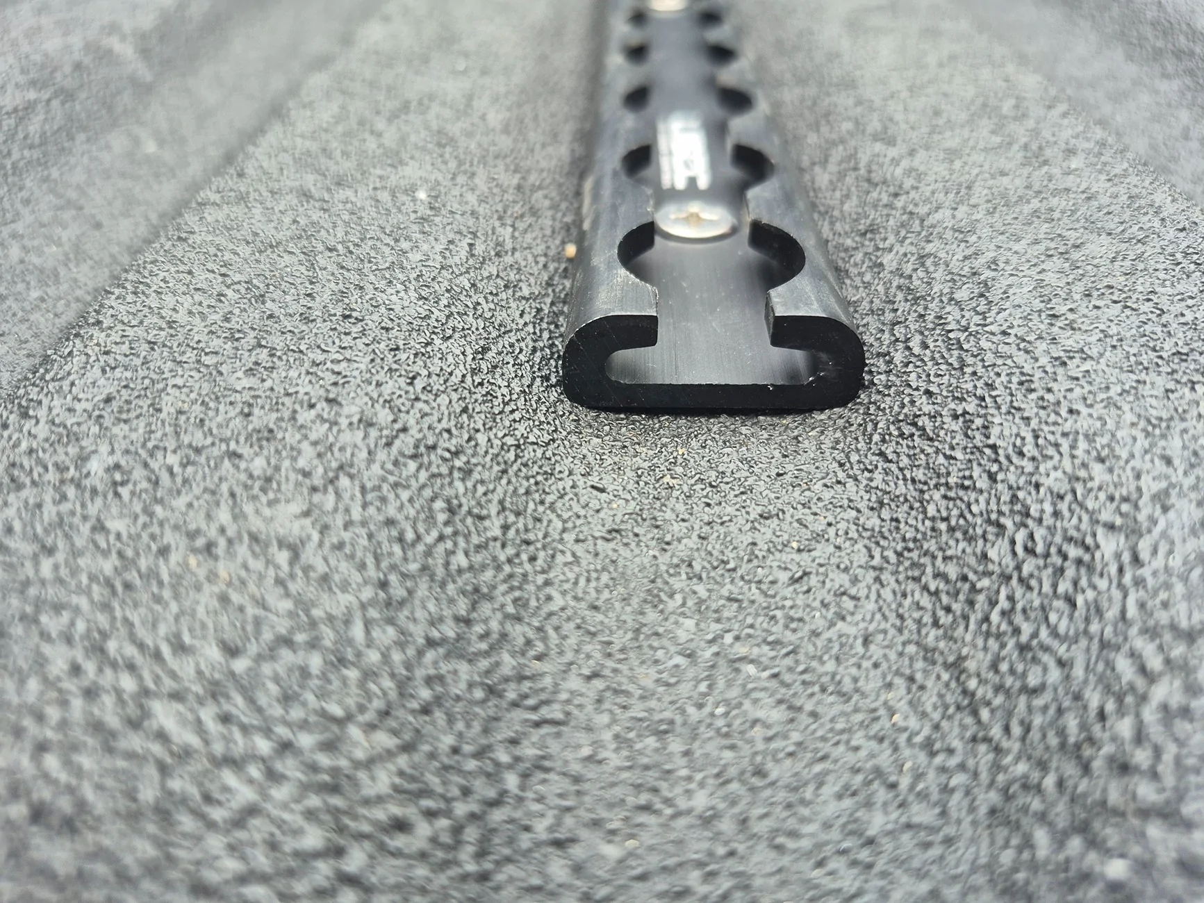

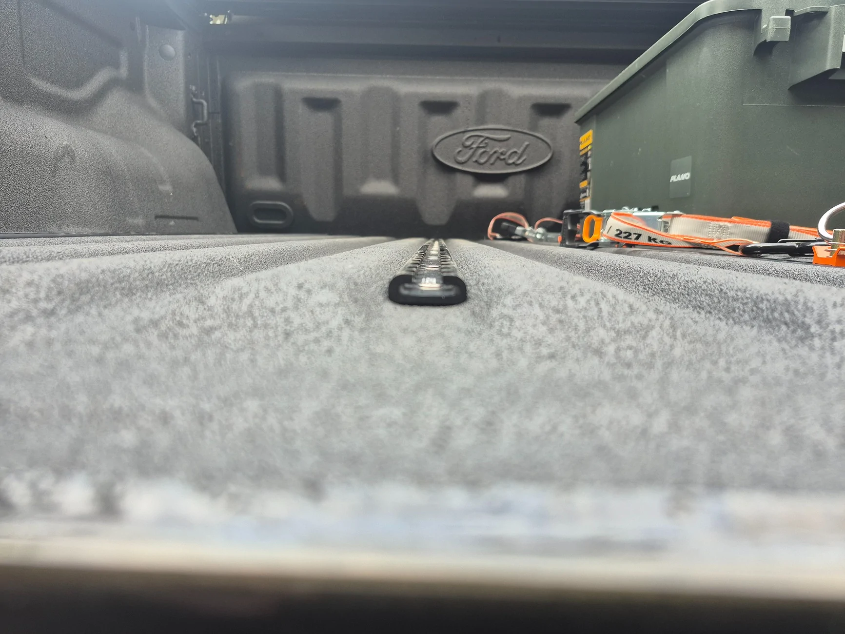

For those wondering, the US Cargo Control standard L-track fits perfectly between the bed ribs for the Gen 2 ranger. Raptors and standard trims should all be same.
Top of the rail is flush with the top of the ribs in the bed. My only cation would be if you have items that are sensitive to scratches, like furniture, throw a moving blanket down to avoid the edge scratching the item. They do make end caps but im too lazy to drill 8 more holes just to install plastic finishing caps. Im fine with the bare ends, its functional.
Plus if you put a load of dirt or gravel in the bed, the open ends make cleaning them out with a hose or pressure washer easy, just spray down the length of the track and it acts like a channel to push debris out.
