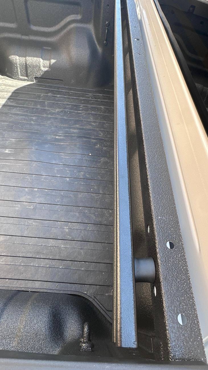

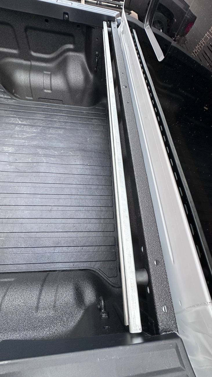

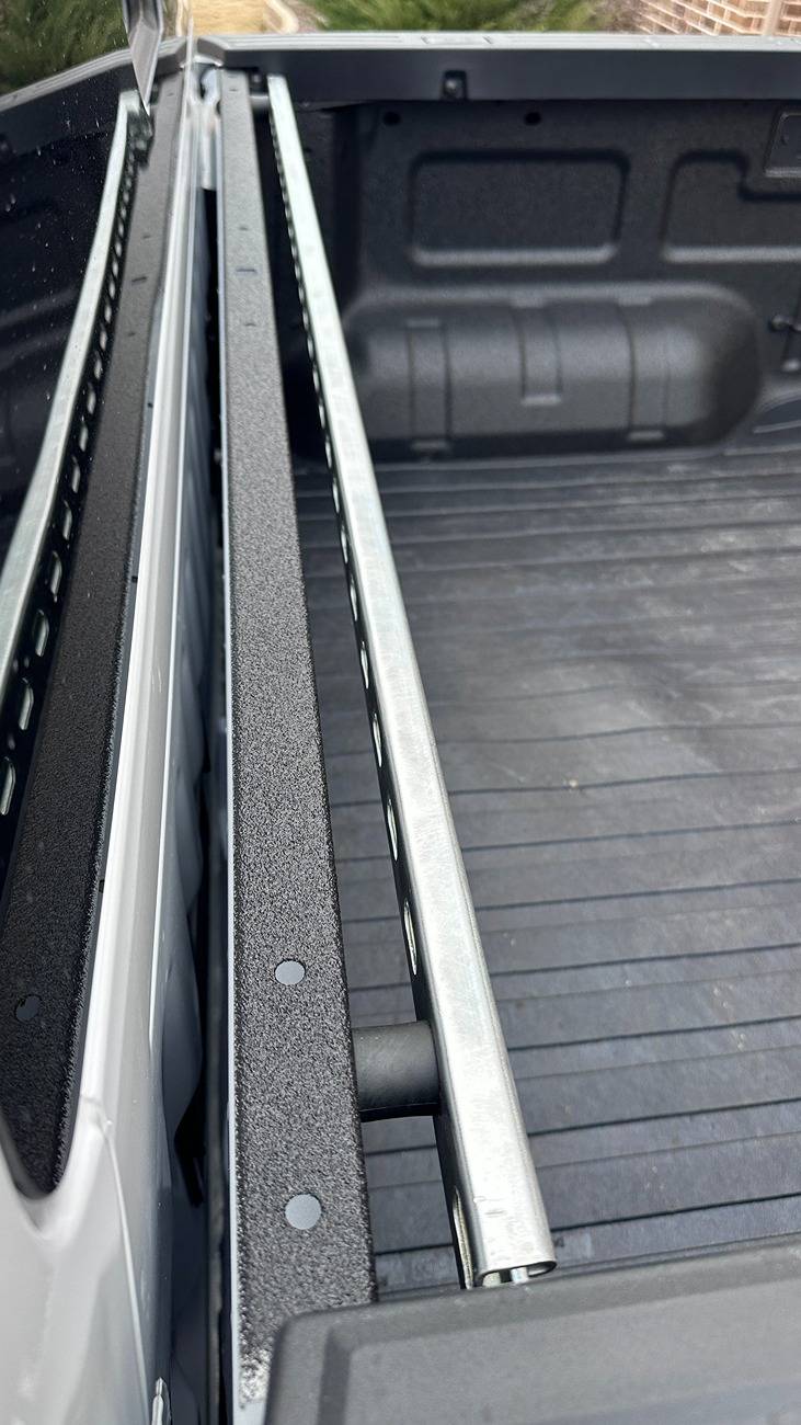

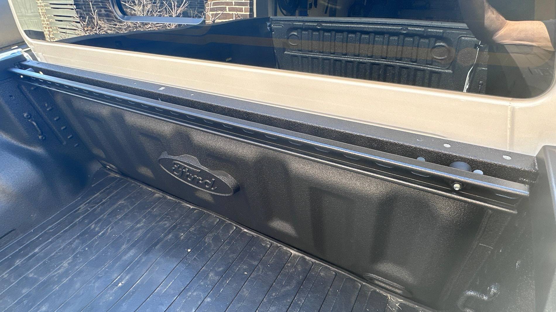

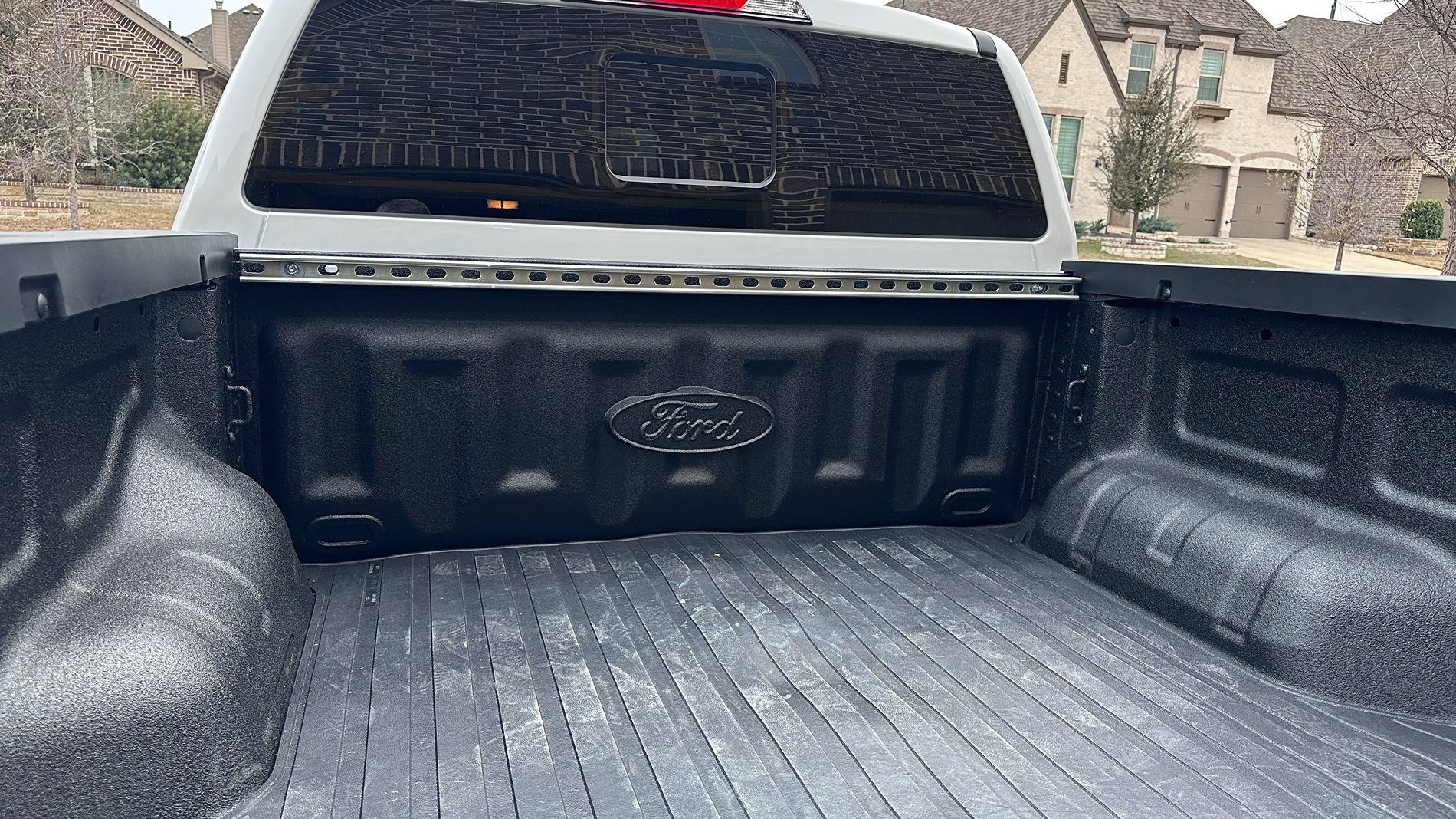

I don’t see why not. That looks perfect. I took the mount out after I snapped the photo because I don’t transport my bikes in the winter and don’t need this piece of steel soaked in road salt. I will use something similar to isolate when I reinstall. I may also put a third bolt through the center of the strut as there is hole dead center but it will require a fastener on the back side.
Do you remember the specs for the Unitstrut you are using? Thanks!
lifeline
Nov 27, 2024
58
Chicago
It’s 14 gauge 10ft unistrut. They usually have 12 and 14 gauge in stock in the electrical department. Either will work, one is just a little thicker. Should be around $30.

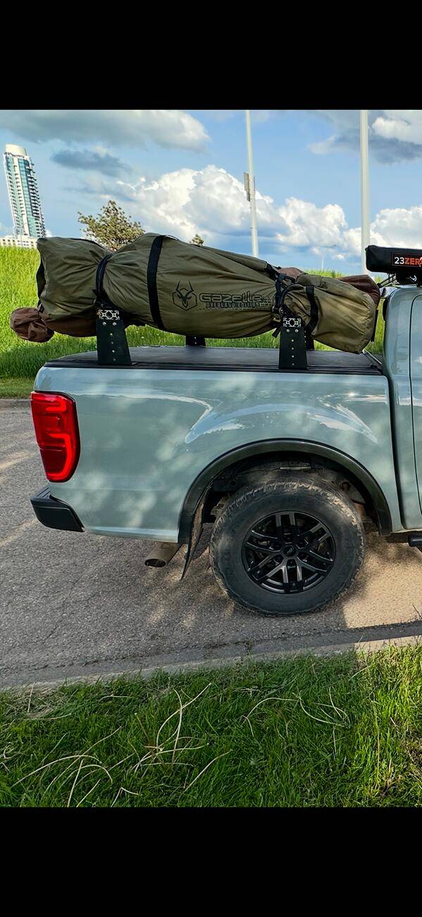

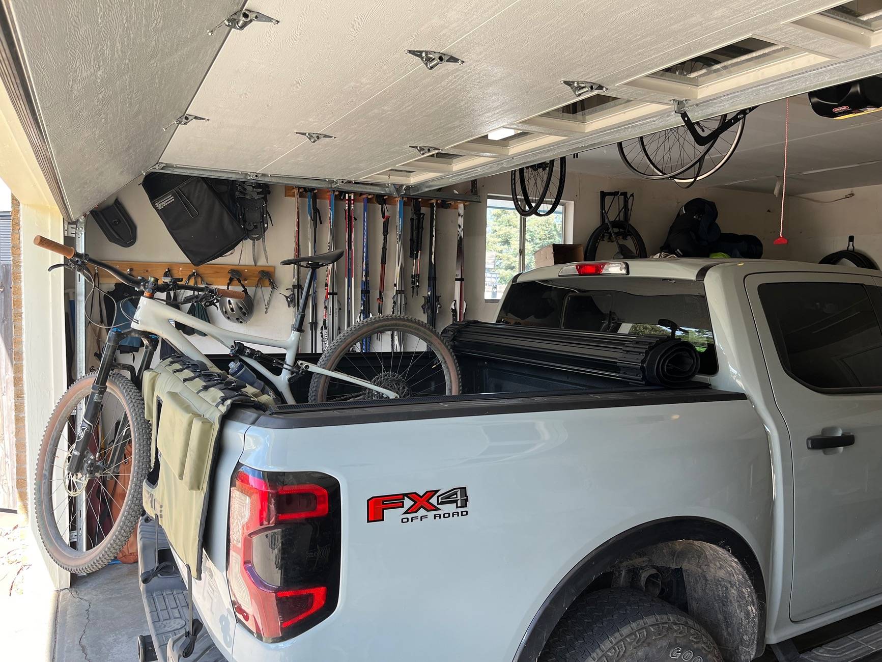

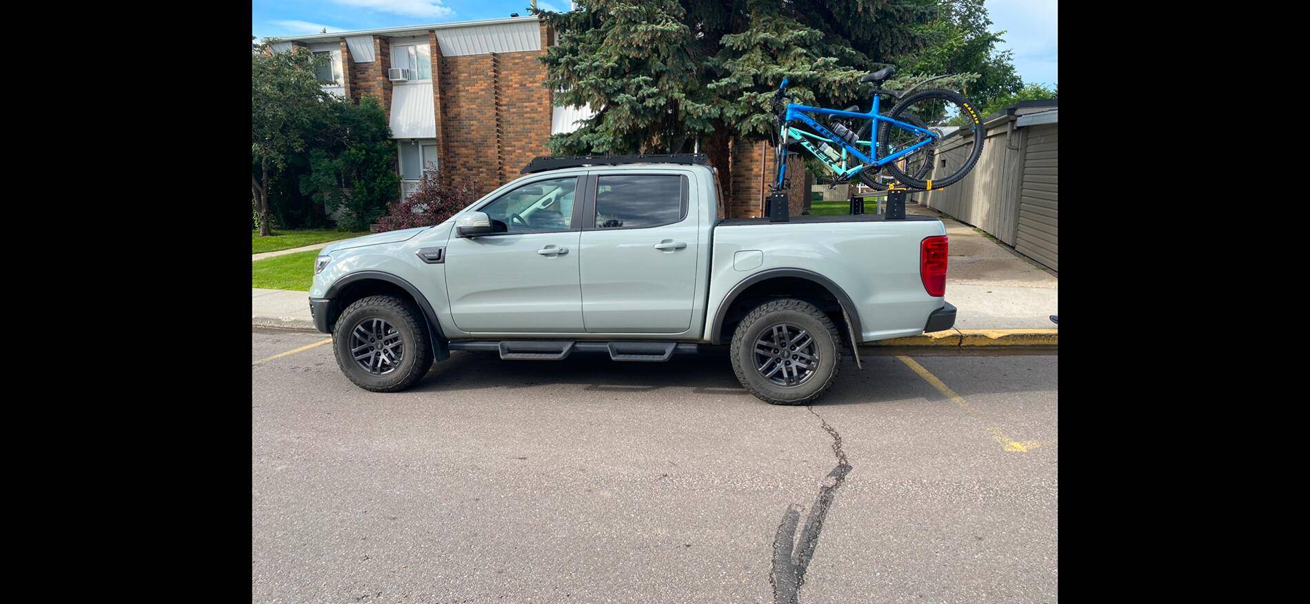

I added the BillieBars to my 2021. I cut the brackets and bolted them through the bed rails. Last summer I added a piece to raise the cross bar so I could easily roll up my Bak Revolver X4S. Took it off when I traded the truck. This Spring, I will make adapter plates to mount this using the stake pockets on my 2024.
A bed rack isn’t that much more than a good hitch rack. And it can do more than just hold bikes.

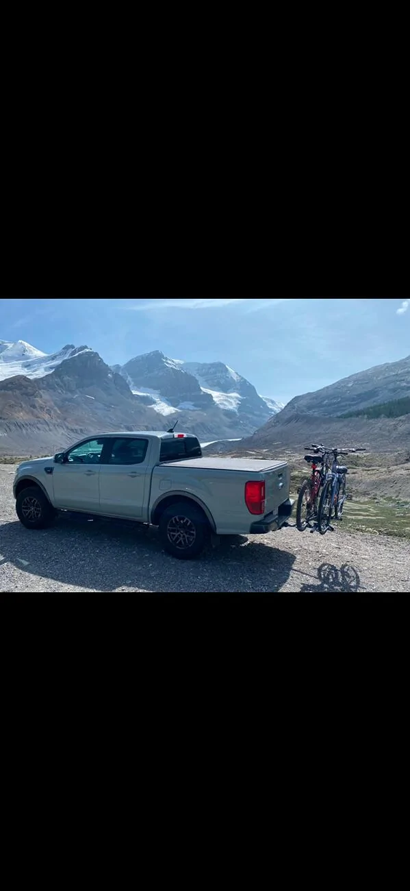

I had a hitch rack, and I never liked the bikes way back there. They moved a lot and blocked the tailgate.
A couple pics on the old truck.

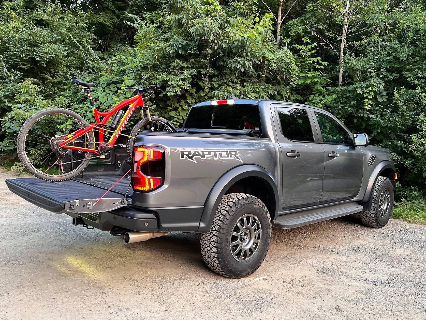

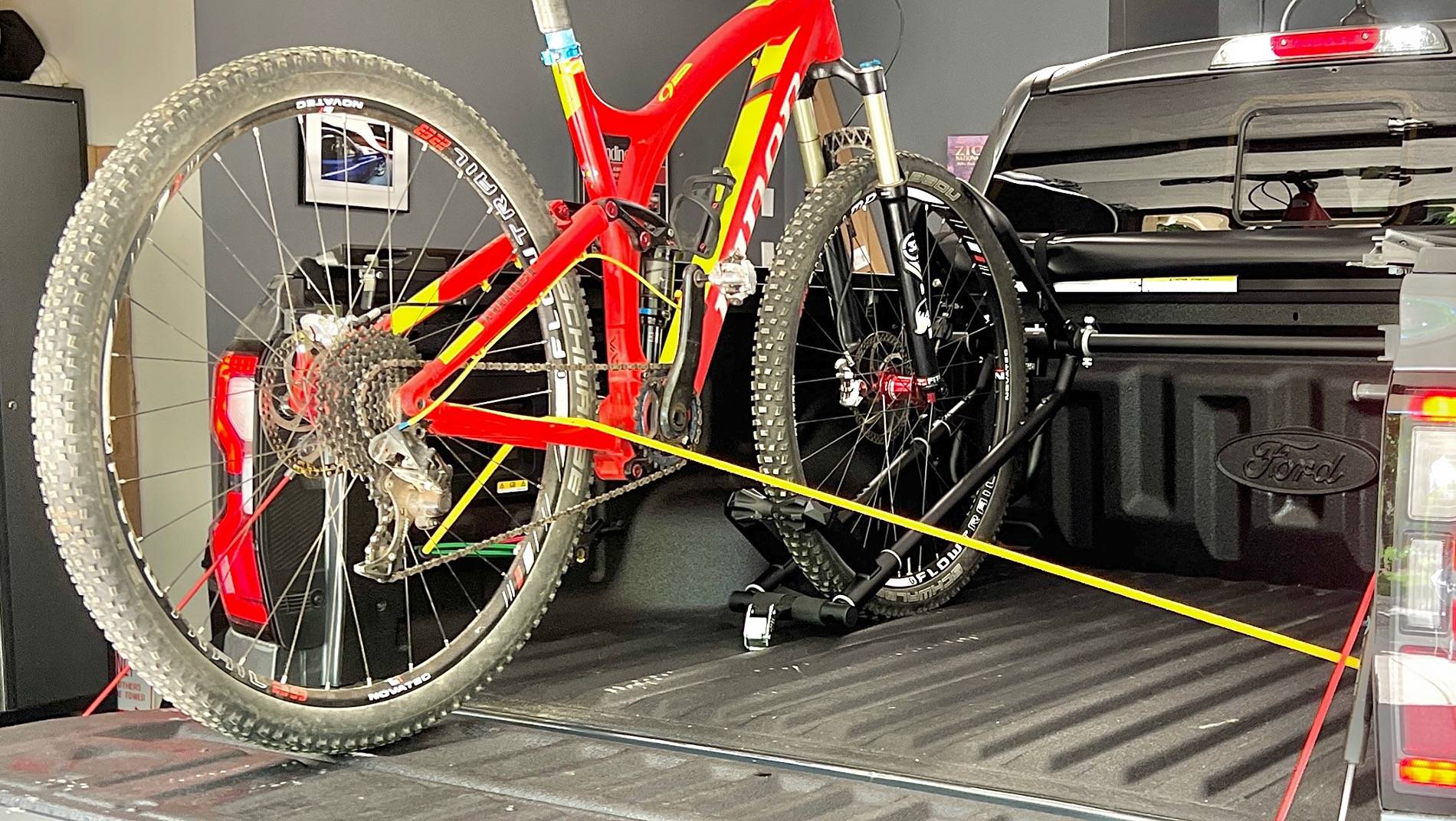

I’ve been really enjoying the ride88 mount. Can get the bike in and out in seconds. I should’ve mounted it closer to the cab with their utility track and single mount (that way I’d be able to close the tailgate) but haven’t bothered with it yet.
A big reason for going with a bed mounted solution was for winter riding, don’t want all that salt spray on a hitch mount/bike at the back of the truck.

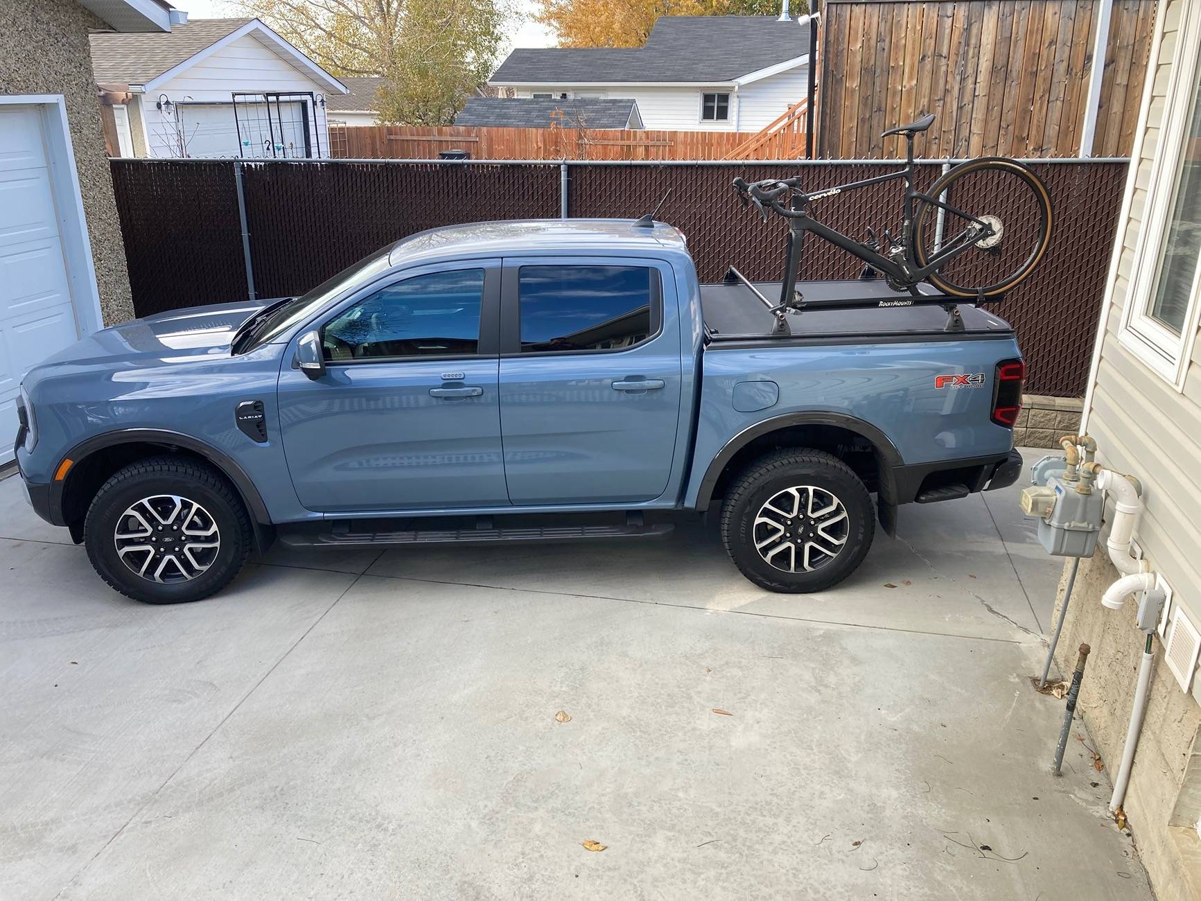

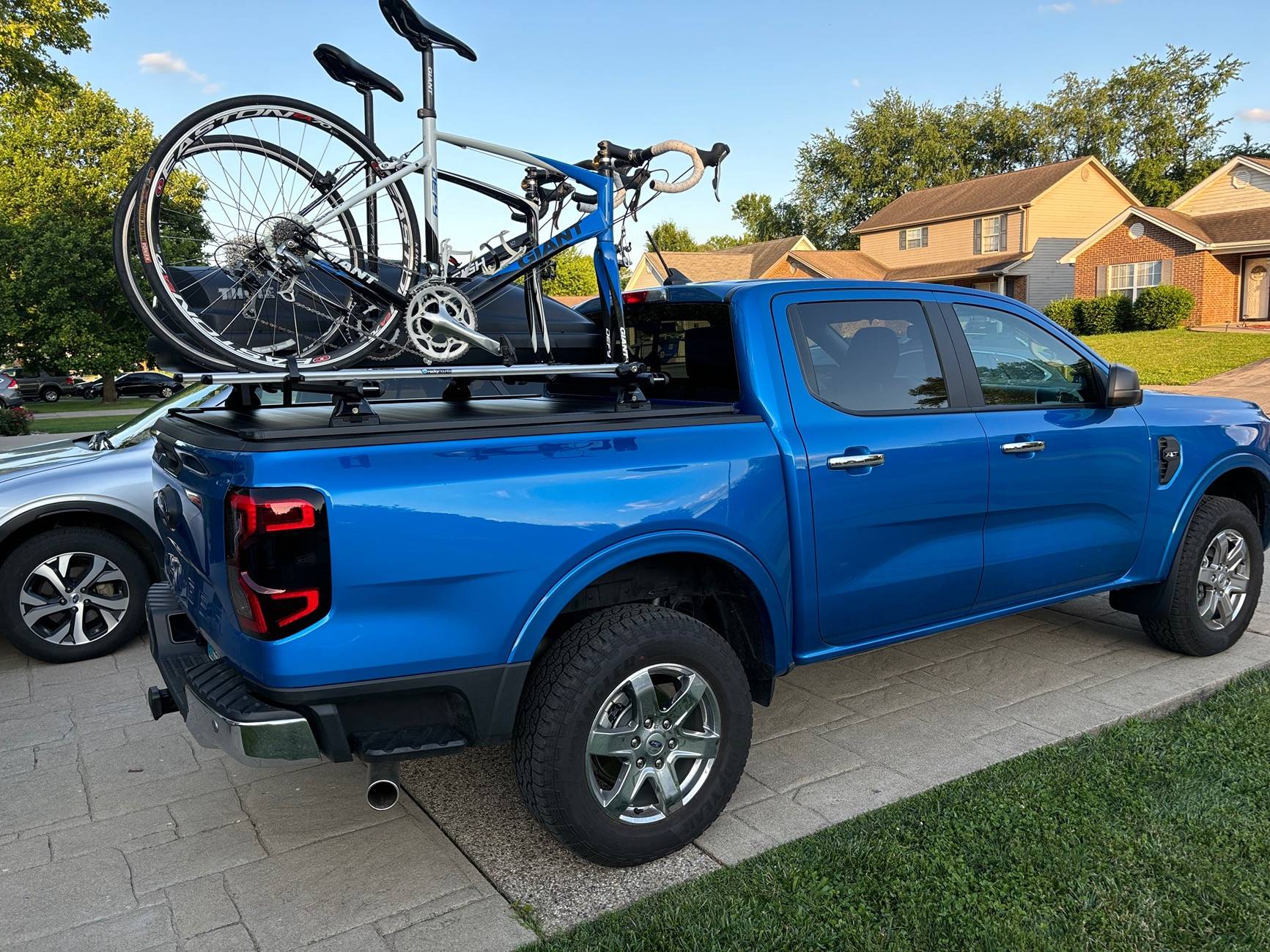

Sorry I am just figuring out how to post things, I hope I am attaching a photo. I want to be able to store wheels and kit under a tonneau cover so I got a cover with T slots no use them for my older round bar Yakima racks. I can also set it up to carry bikes across the bed if required. 4 bikes,front wheel off is very doable

Patriotic bike choice.

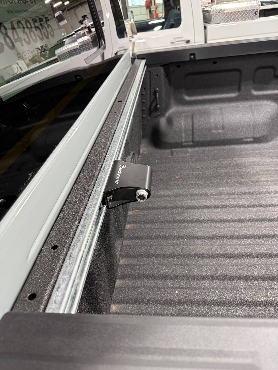

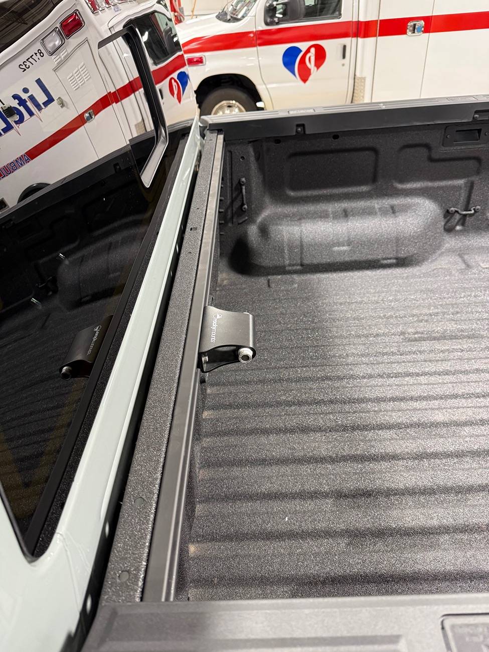

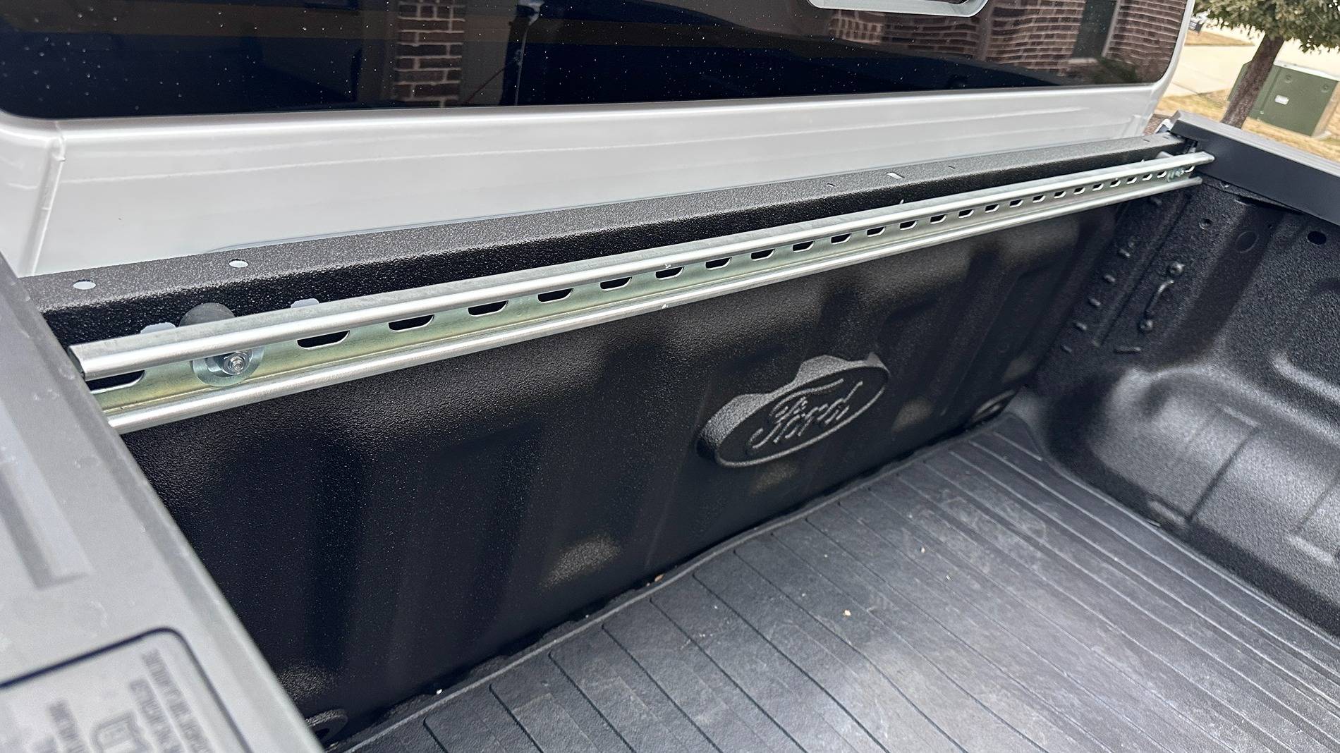

I bought a 10 foot piece of unistrut at Home Depot and cut it to size. I put 2 M8 bolts through the threaded holes in the bed to secure. I used my Rocky Mounts thru axle mounts that I was using with their F-150 track kit on my old F150 Raptor. It would be nice if Rocky Mounts came out with a custom kit for this truck but this will work for now.

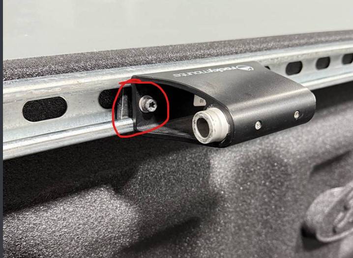

What hardware did you used here?
lifeline
Nov 27, 2024
58
Chicago
It’s the hardware that came with the Rocky Mounts rack I used on my f150 raptor. I’m pretty sure you can buy replacement parts from their website. Each bolt threads into a plate that when tightened squeezes against the channel to secure the bike mount.
Here you go:
https://rockymounts.com/products/track-hardware-kit.html

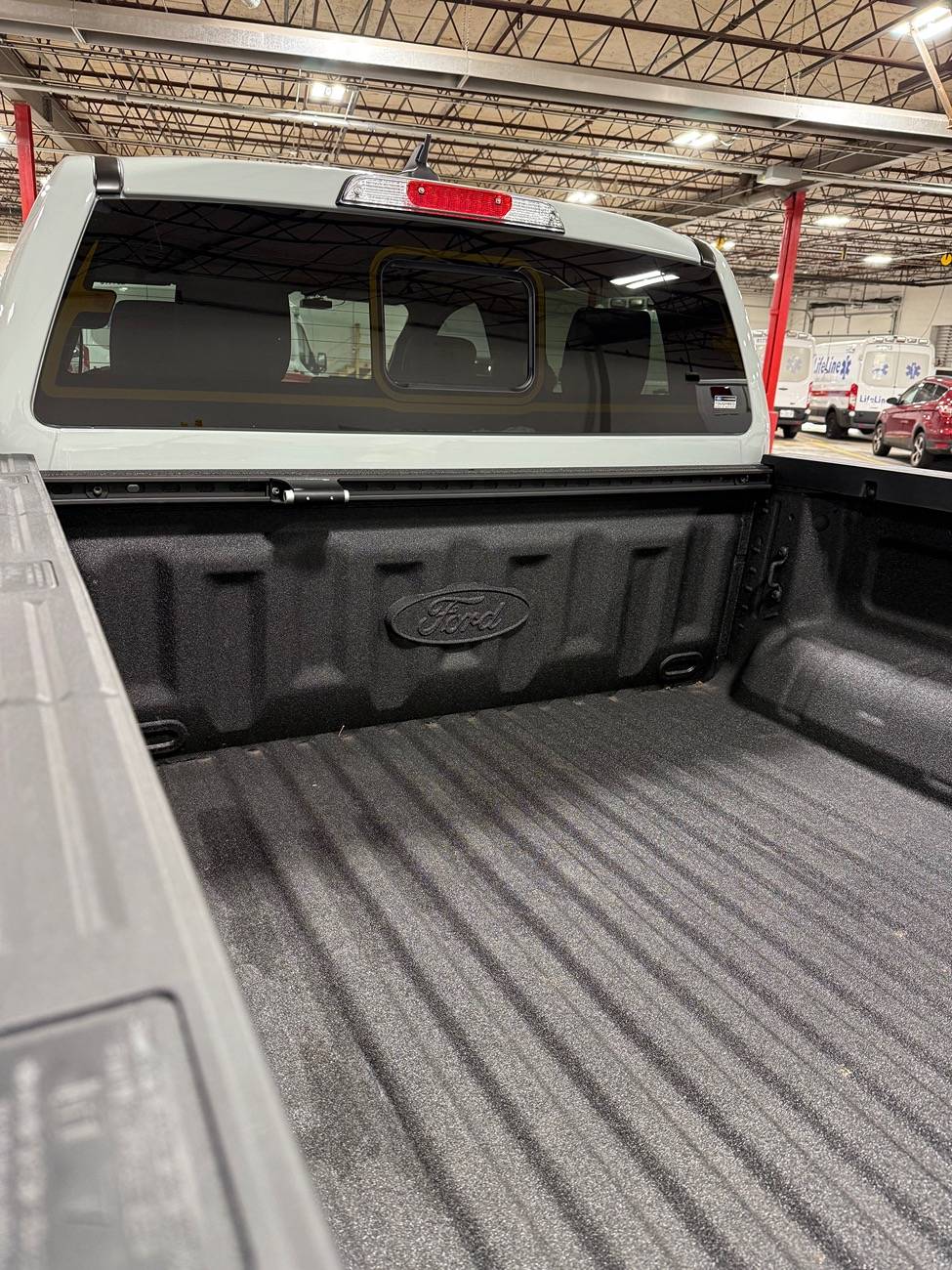

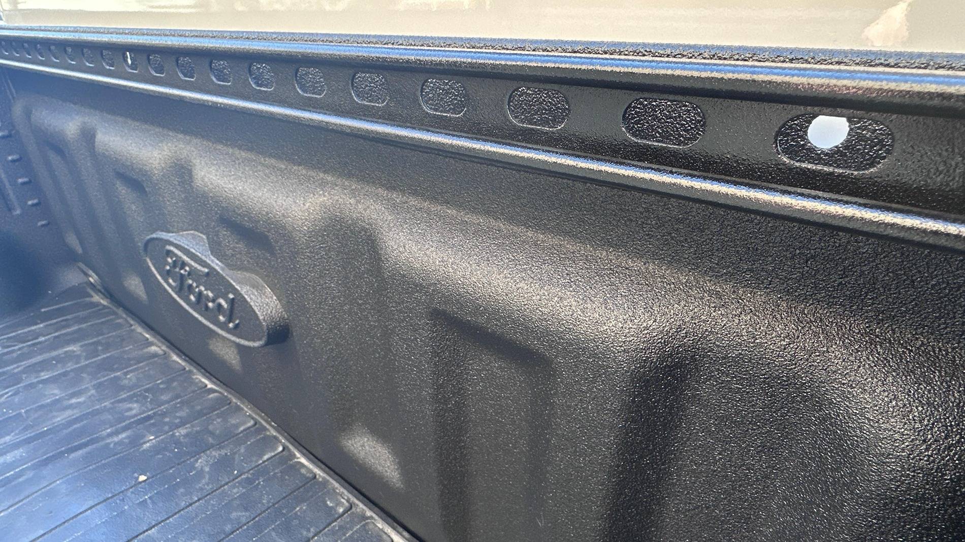

Instead of drilling directly into the bed to mount it, I'm looking into a few options using molle panels, a deck rail at the bed header, or even finding some sort of L-bracket that could utilize these two holes in the bed to mount the fork mount thing.
