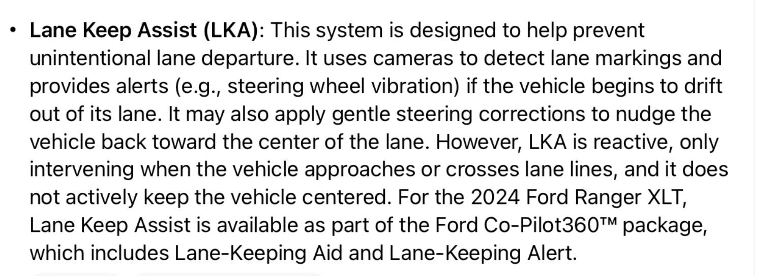

Lane Keep Assist is different than Lane Centering Assist. For LKA, you won’t notice anything unless you drift out of the lane markings.
Ford Ranger Lane Assist - what activates it? IMG_0126

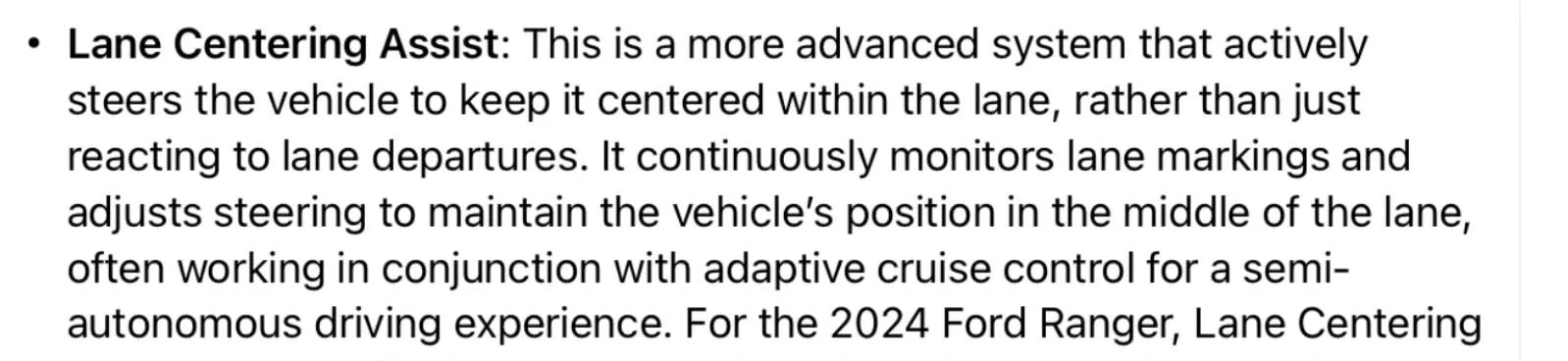

Lane Centering Assist is used in conjunction with Adaptive Cruise Control. If it’s not working, you may have it turned off within your settings.
Ford Ranger Lane Assist - what activates it? IMG_0127
