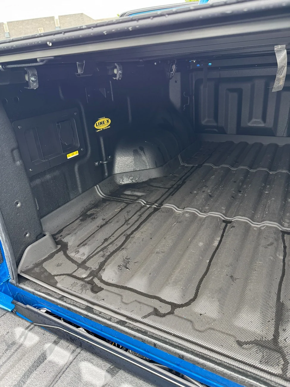

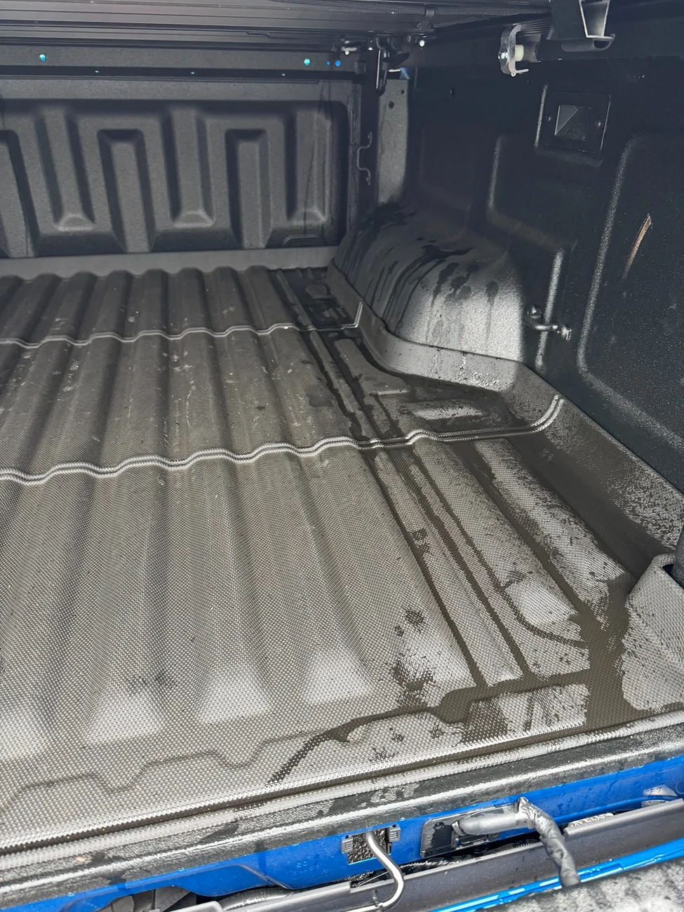

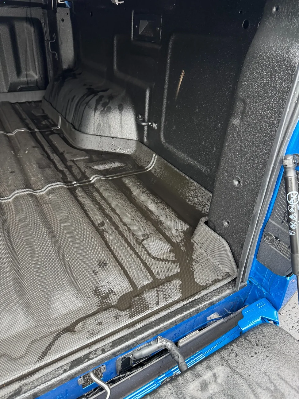

I just installed a brand new Lomax Trifold cover on my '25 Ranger Raptor. I followed what little instructions when installing and everything looks good. It set out in the rain yesterday during work and had quite some leakage for what I thought was a pretty leak-resistant cover. I used the method that I saw a few other members using to seal the rail pocket covers with closed cell foam. It also did not appear to be leaking from those when I looked. Is there some adjustment or something that I can do to get this cover to seal better or a trick that will help? Photos of the leakage are attached.

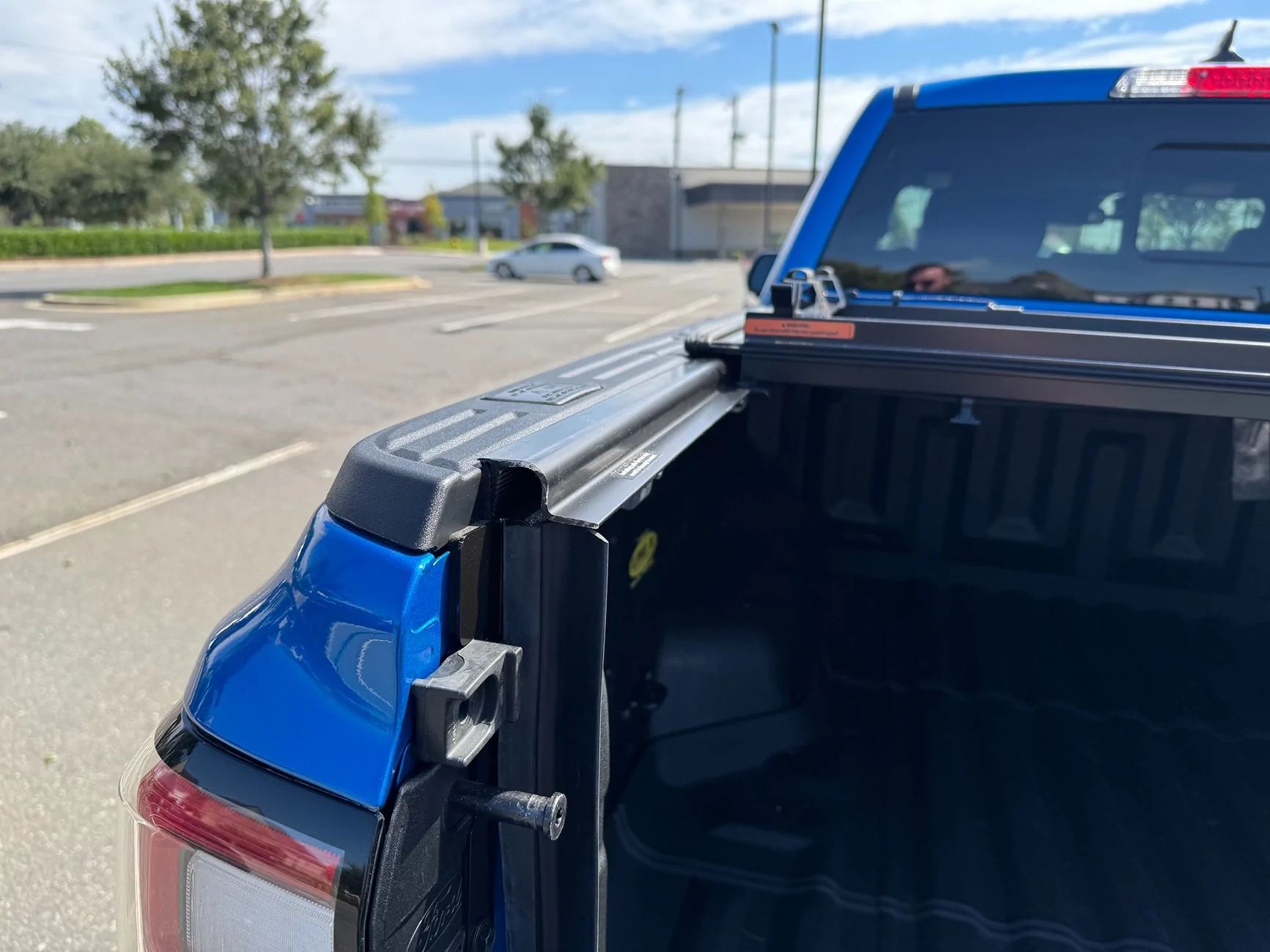

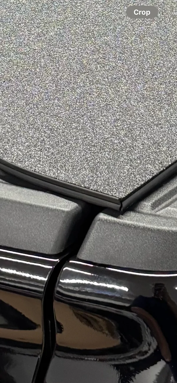

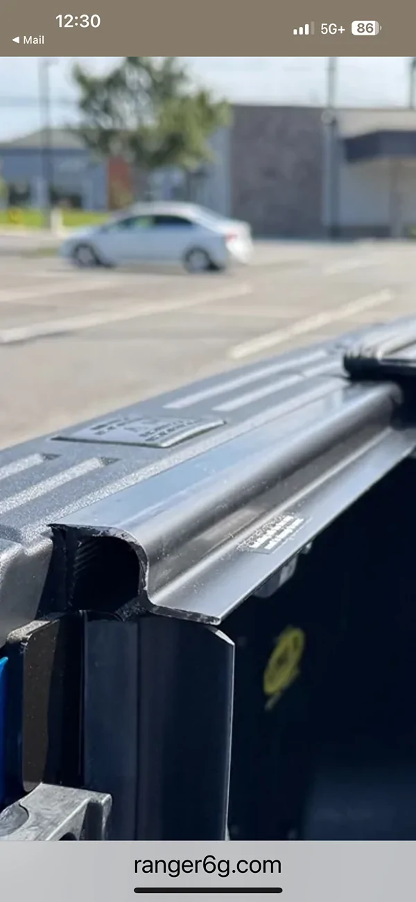

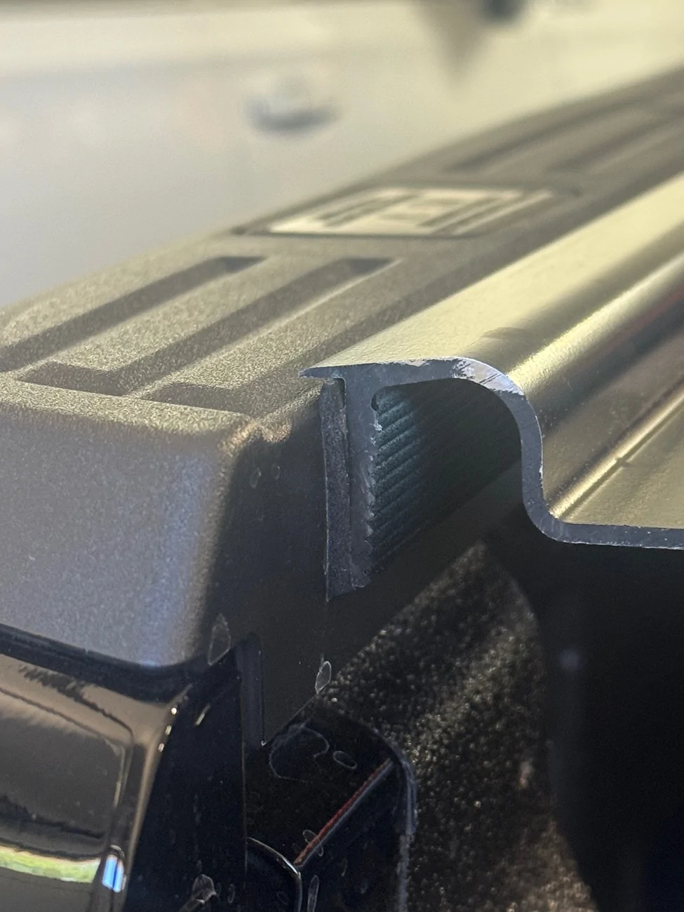

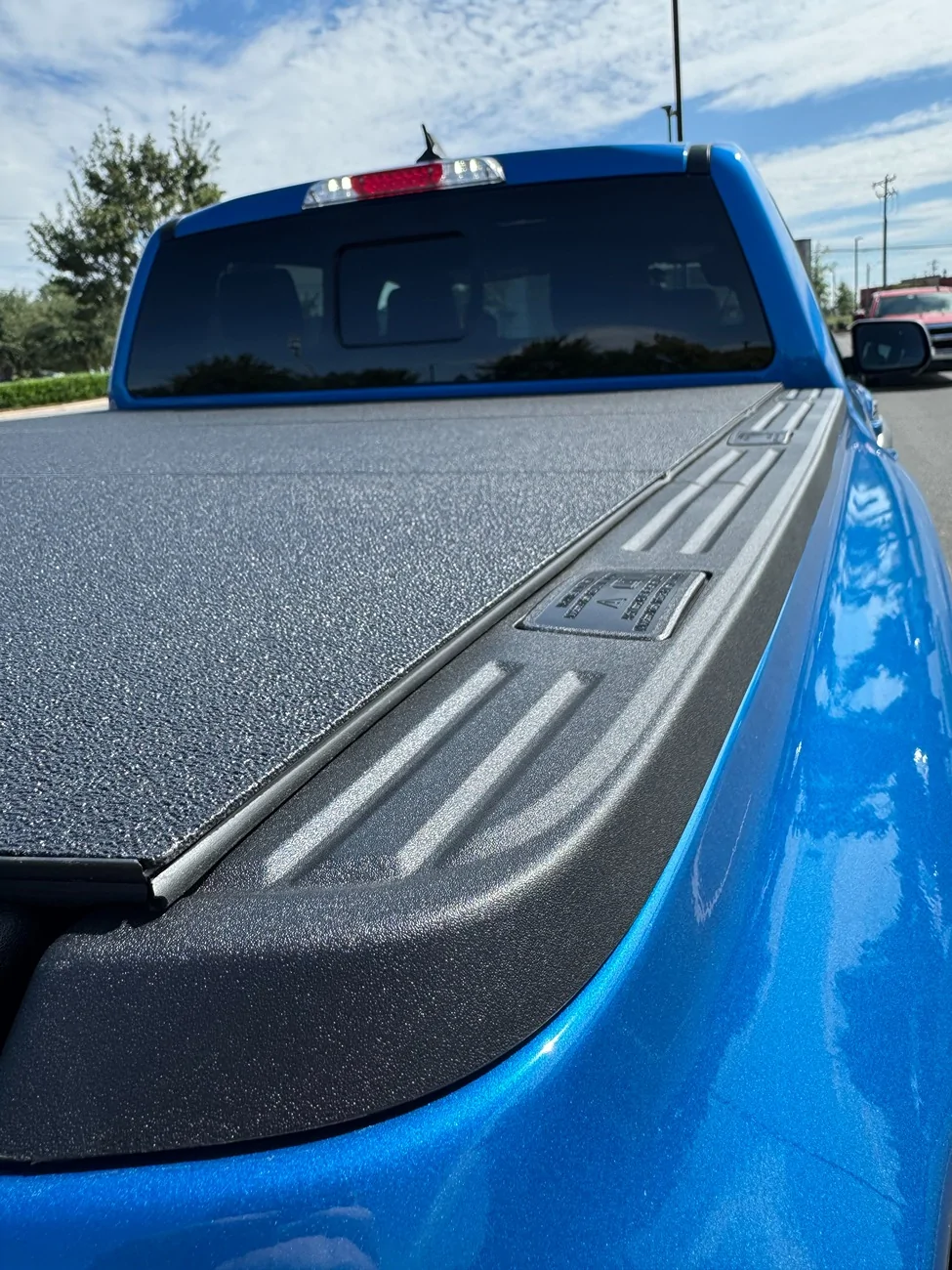

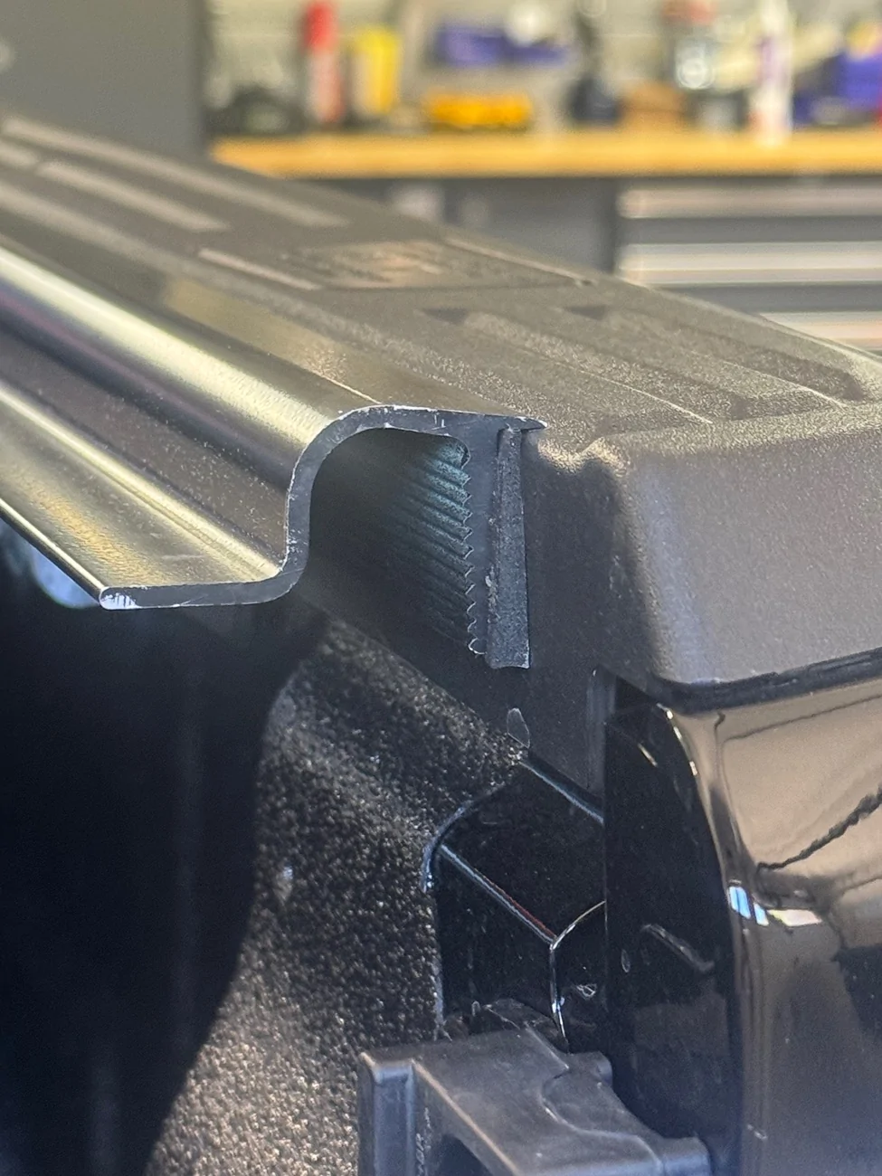

Here are some photos of how the cover sits on the rails.
Ford Ranger Leaking Lomax Trifold on Ranger Raptor IMG_7657
Ford Ranger Leaking Lomax Trifold on Ranger Raptor IMG_7658
Ford Ranger Leaking Lomax Trifold on Ranger Raptor IMG_7659
Ford Ranger Leaking Lomax Trifold on Ranger Raptor IMG_7660
Ford Ranger Leaking Lomax Trifold on Ranger Raptor IMG_7661
GiJoesGT
Feb 2, 2024
82
114
Alabama
F150
Air Force
It looks like you need to drop the rails a little bit, particularly at the rear. It looks tighter at the front. The top edge of that rail should be completely flush with the bed rail and the sticking up a little bit.

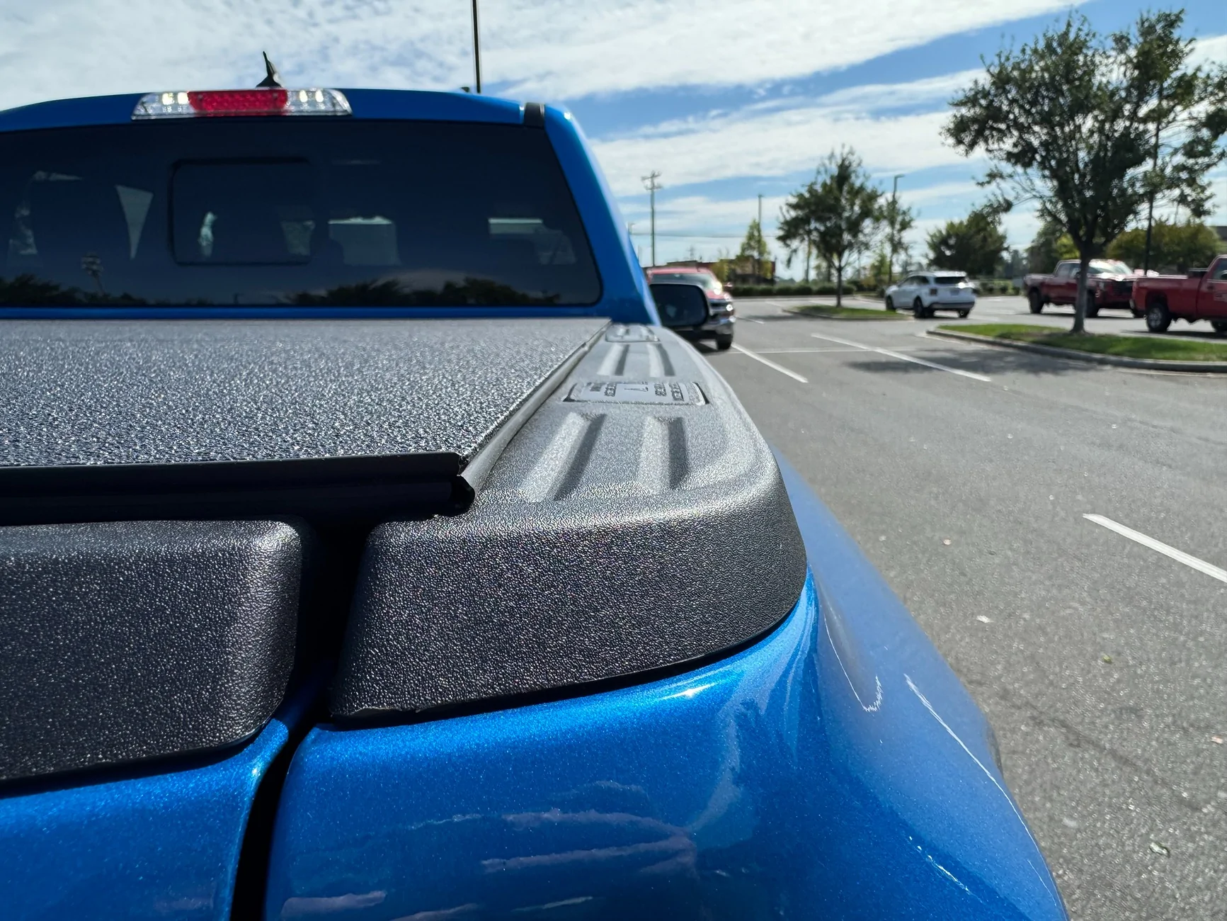

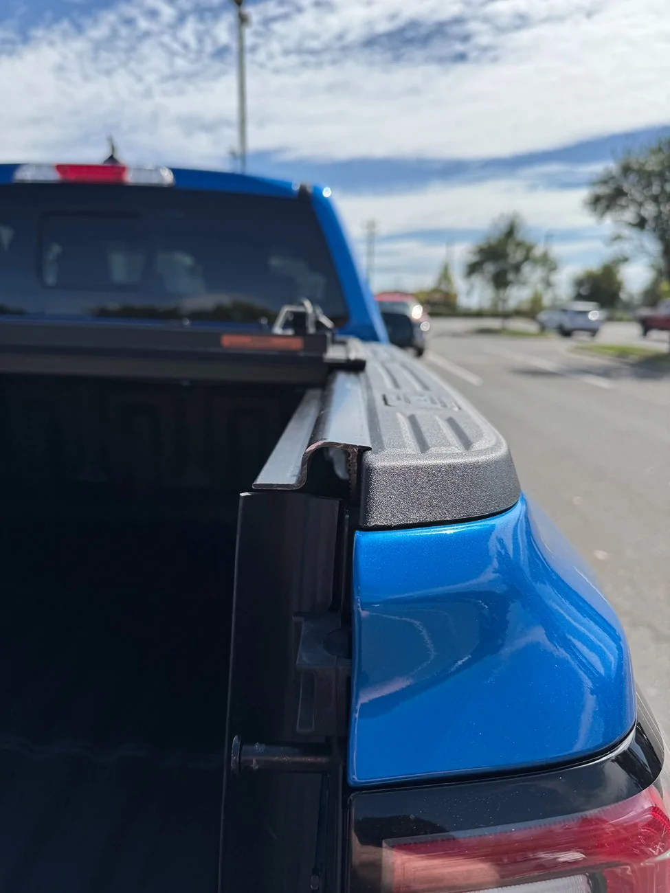

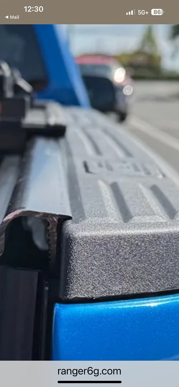

Mine doesn’t leak either except a tad bit at the back in that opening during a car wash.

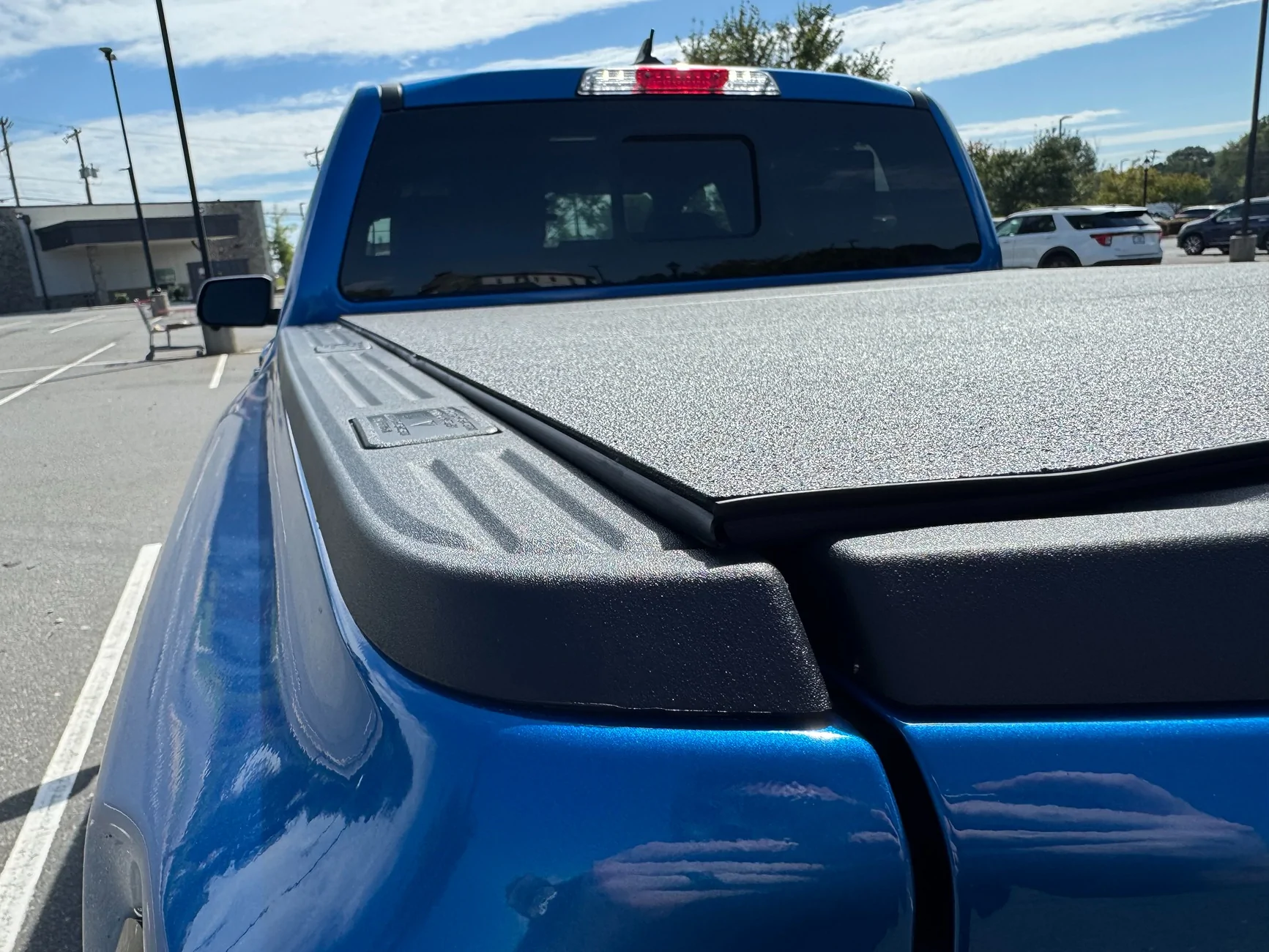

I’ve attached some pics. With the way the cover still on the rails, the problem almost has to be in the rails. The seal between the truck bed and the rails might have an ever so slight ripple. Or maybe the clamps holding the rail to the bed are not properly torqued. I see the seal sticking out slightly on the left side rail but not the right. If else fails remove and reinstall.
