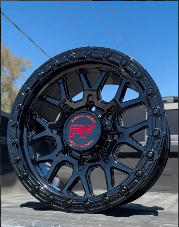

I'm ordering some new wheels for my truck, there a one piece forged wheel similar to Innov8 - it's a brand called parallel forged.
The wheel I'm going with is a 17", but the offset choices I have is 0 and +18 - I think +18 would be the best bet but I don't want to restrict myself if later on I want to do some intermediate off-roading with some very light jumps or whoops.
I tried searching for +18 offset wheels on google and on forums and didn't get lots of results. Do you think I will have any rubbing or issues? I'm sure regular urban driving no, but I was more concerned if I wanted to take it on a raptor run or something I won't be restricting myself.

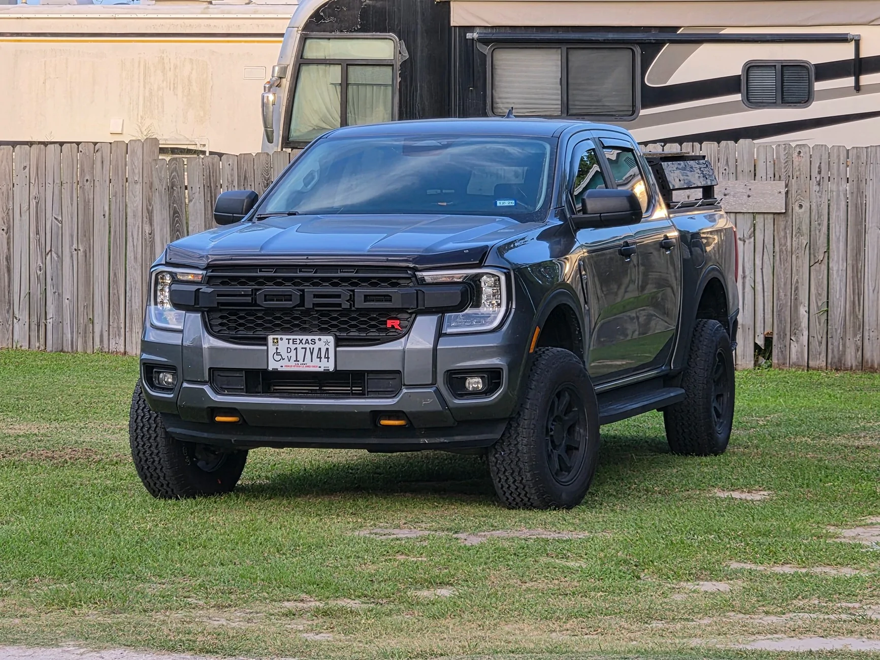

Both offsets will fit fine I have a 0 or -1 can't remember and they fit perfect. Got Cobb TR-01 wheels its oem size just lower offset.I went with the lower offset to give a more aggressive look and feel its perfect

You didn't say the width which matters too when looking at offsets. I assume it's a 8.5. A +18 will be best for off road and option to do a 35" safe, 0 is great for looks and mall crawling as it will rub on full flex. If you like the poke look go with a 0. It will sit about 25mm outside the fender with the factory tire size. Good luck!
Will be running stock tires for now but will move to a 35" soon. Rim will be 17x9
