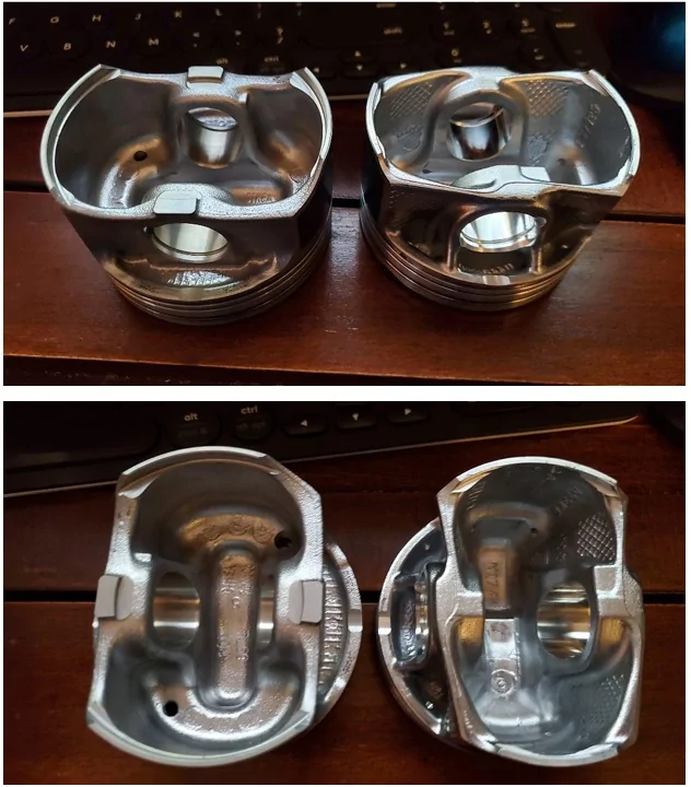

Look at the 3.0L block, it's a beast!

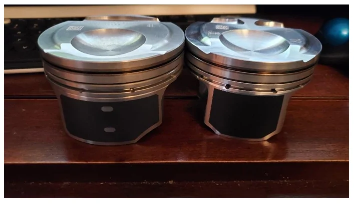

3.0L HO pistons vs. 2.7L NANO pistons:
Ford Ranger Long-term reliability Screenshot 2025-11-07 191006
Ford Ranger Long-term reliability Screenshot 2025-11-07 190950
Note the significant differences in skirt thickness and the oil cooling galleys in the 3.0L pistons, same as 6.7L Powerstroke pistons. Both feature cast-in-steel ring liners (top photo), much more knock resistant.

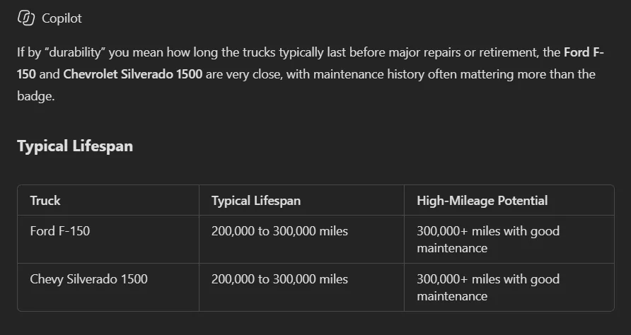

F-150 vs. Silverado 1500 (general query to Copilot AI):
Ford Ranger Long-term reliability 1791898628772-s5

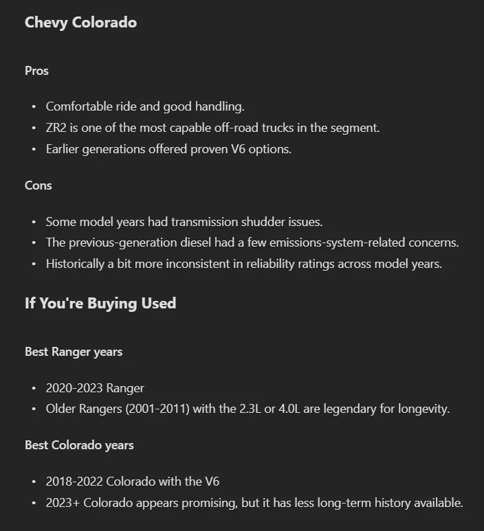

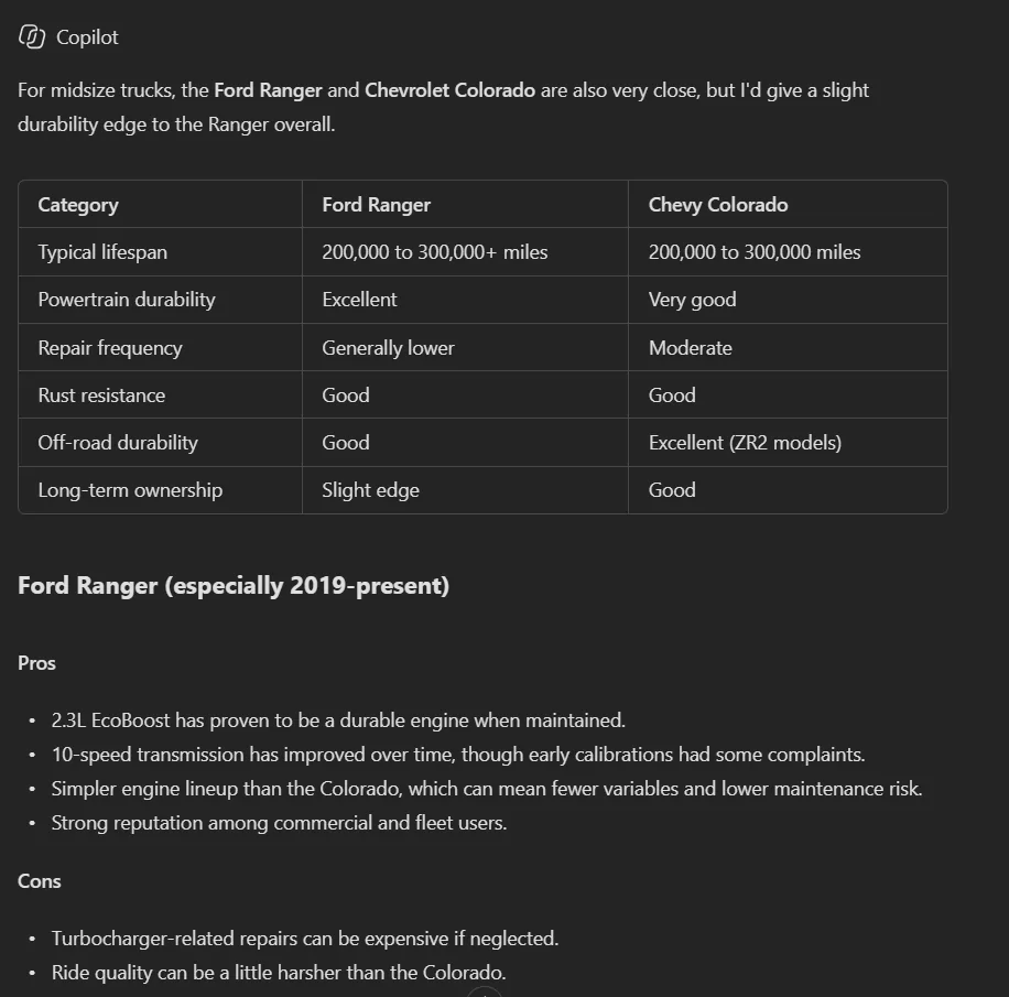

Now the mid-sized:
Ford Ranger Long-term reliability 1791898666801-y
Ford Ranger Long-term reliability 1791898699778-8

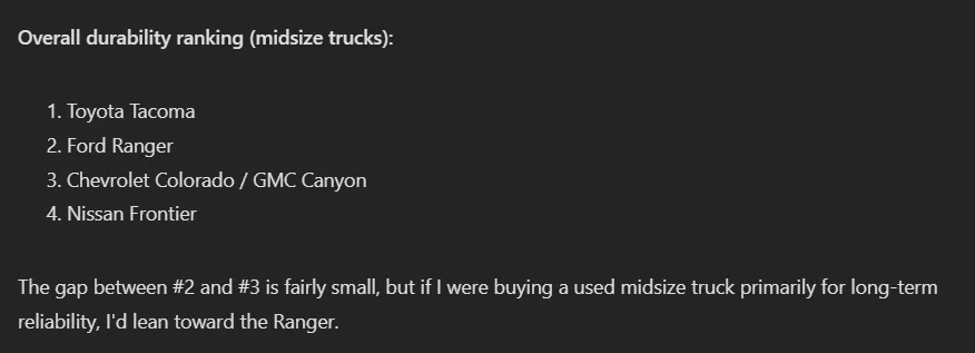

But you'll get people swear that Ford's are massively better than Chevy's, or visa versa...I call B.S. Pick what you want based on balancing features, cost, use cases, aesthetics and builds.
Ford Ranger Long-term reliability 1791898846003-5z
All four options are good. Toyota probably is not really #1 anymore if you buying a Gen 4 with the turbo engine. The older Taco's were massively UNDERPOWERED = very low stress engines. That and mfg. quality were the key to their durability. Now that they are making a lot more torque, your seeing more comparable issues, like we've seen taco's snap front diffs, break suspension parts and have transmission issues in the Gen 4's where the older Gen 3's kinda just putted along.
