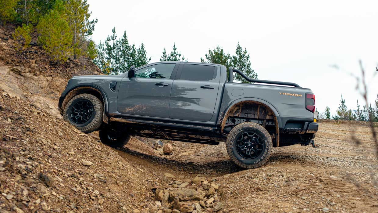

That’s actually a really good question. And something I honestly hadn’t considered.
Appears to be on the left down there as well however:
Ford Ranger Looking for affordable long range tank Ford-Ranger-Tremor-2024-18
