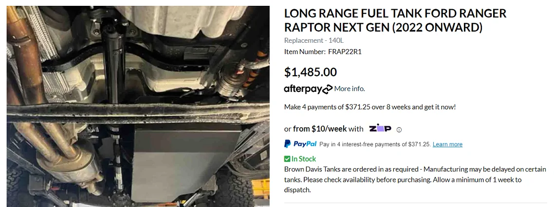

Brown Davis is a major manufacturer of truck accessories in Australia. I would have no qualms dealing with them.

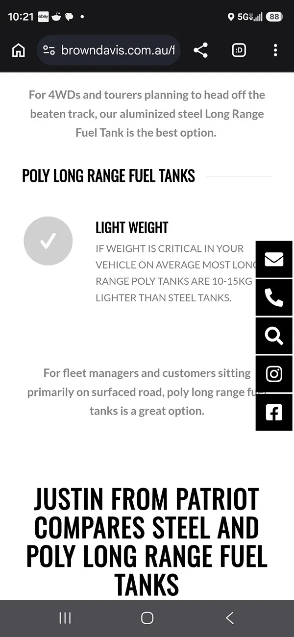

I checked with them they are currently taking pre-orders for tanks here in the US and have a shipment leaving from Australia soon. They are about 1k cheaper than the long range America tanks but they are also made of polymer.

Interesting on polymer vs. steel - I'd be a little worried if there was not skid plate protecting it on a RR. If I had a base Ranger and/or wasn't doing Raptor things, I wouldn't care.
But also - I presume it's a lot lighter...
Hang on - where do you see polymer? The website refers to steel construction.

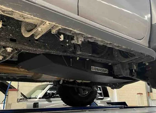

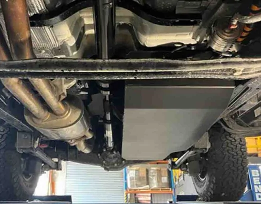

Raptor was only steel when I reached out to them previously. Poly was for diesel and 2.3L. And after getting under the truck, I don't think the aftermarket tank is any lower than the factory tank. It looks like it in photos, but that's because it's longer. Sort of an optical illusion.

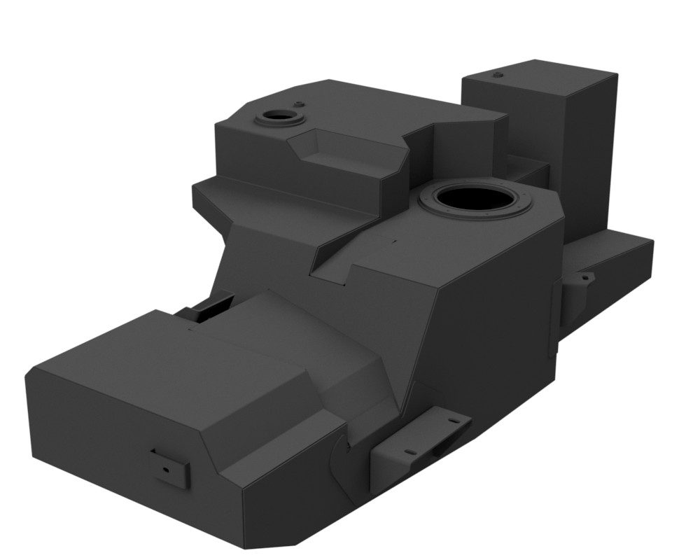

So I reached out to them today, less than 8 hrs later they responded, here is what they said and it makes me think that there won’t be a poly tank for us gasoline guzzlers…
The Brown Davis tank to suit the Ranger Raptor (FRAP22R1) is a steel tank. We used 2-mil aluminized steel, which is not suited for poly because the Ranger Raptor is a Gas/Petrol variant that reacts negatively to that material. Steel is also a better option since it allows us to add baffles to the tank, a swirl pot, and a drain plug that can't be added to poly tanks.
