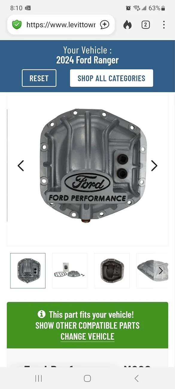

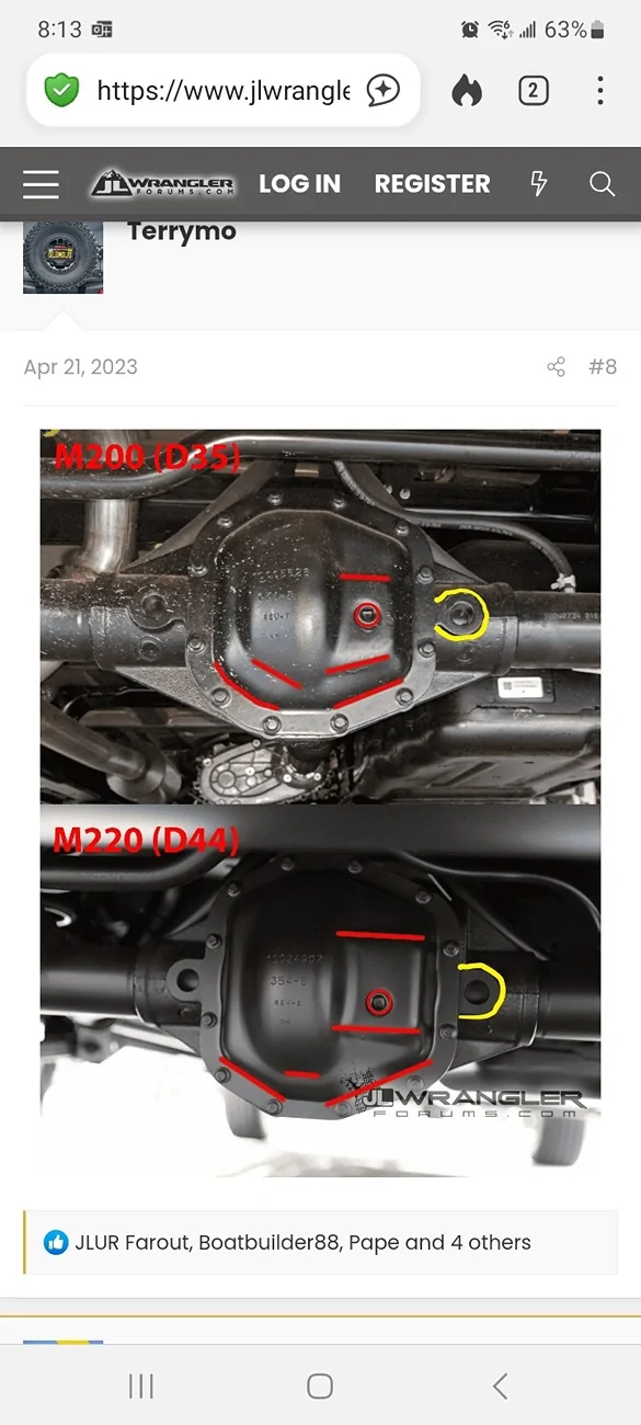

Ford Ranger M220 oddities Screenshot_20251002_201318_DuckDuckGo
Ford Ranger M220 oddities Screenshot_20251002_201020_DuckDuckGo
You guys notice 2018+ jl jeep wranglers and the chevy colorado /gmc canyon also run the m220?
How odd thay all the american truck companies run the same rear axle on their midsized trucks?
Good for us but still odd
