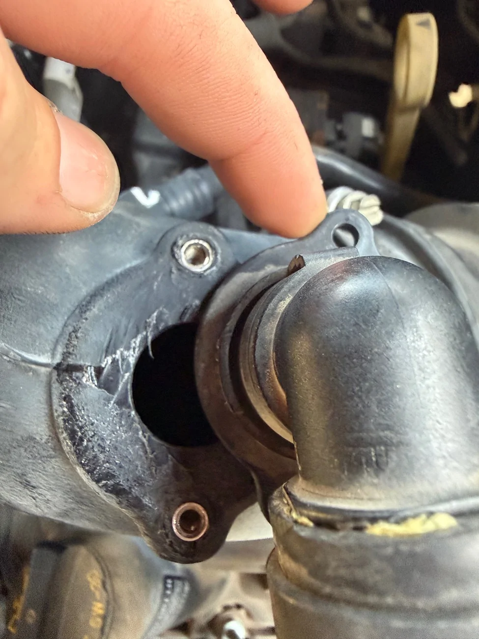

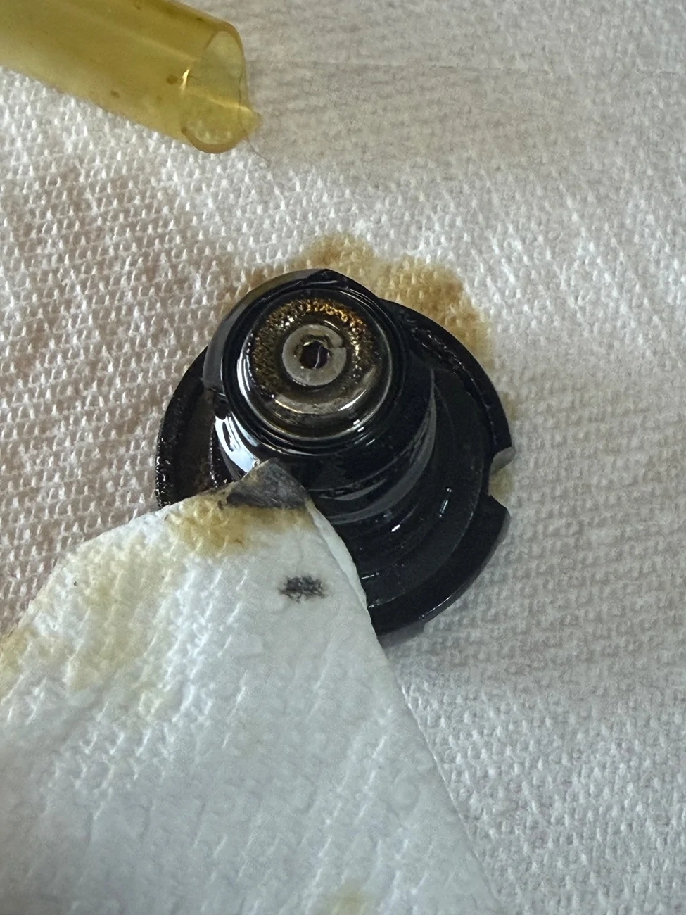

Yea, but this truck is a champ, didn’t even need to get an alignment… but definitely gotta be more meticulous about putting loctite or thread locker on certain stuff… my S&B CAI BOV recycle port screws backed out which caused my intake to be exposed to the dusty environment downstream of the air filter… which resulted in some metallic particles attaching themselves to my oil drain plug :(
Ford Ranger Marfa, TX Raptor Run 20260606 IMG_0118
Ford Ranger Marfa, TX Raptor Run 20260606 IMG_0317

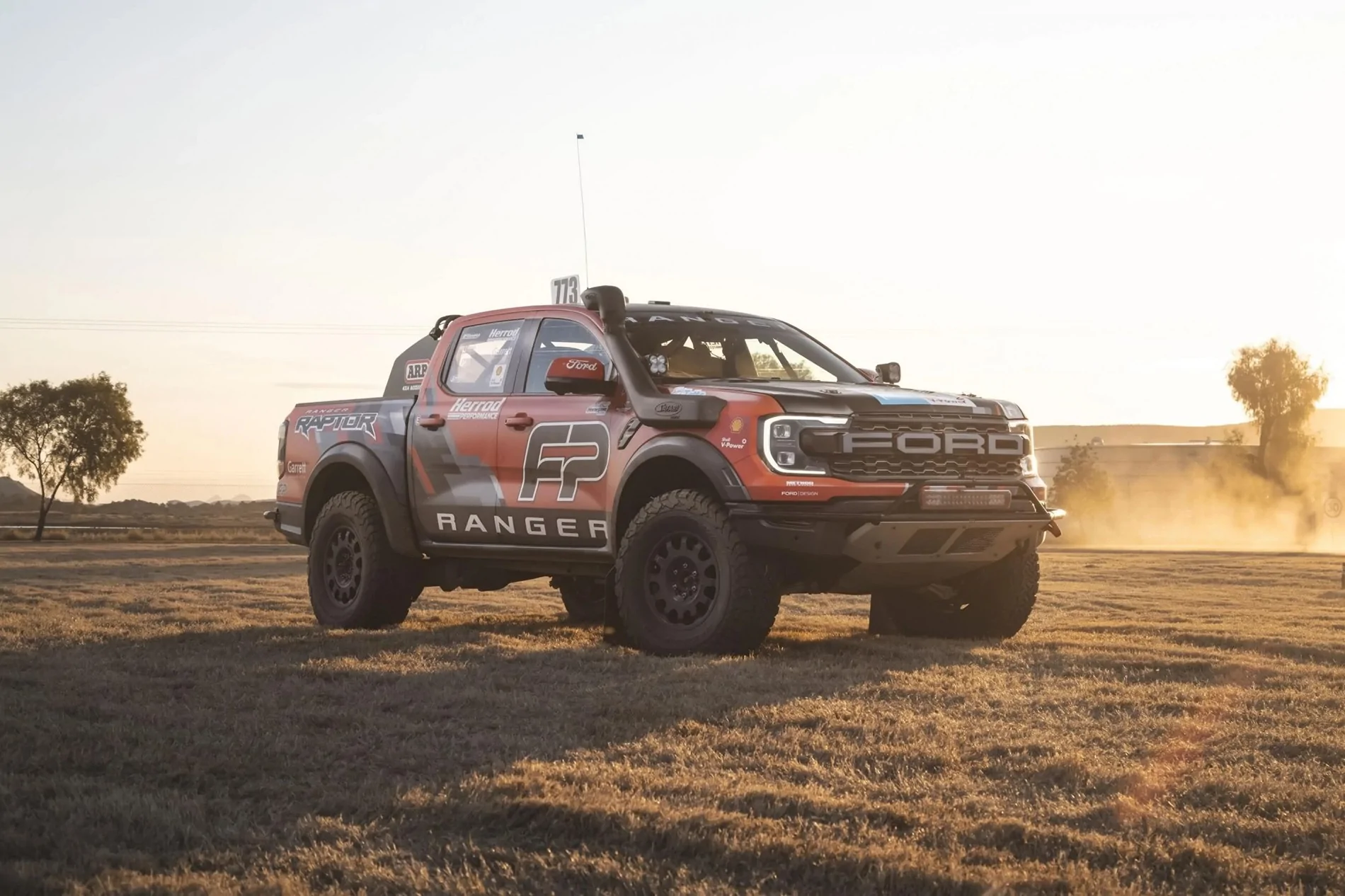

Now this is a legit pre-runner built for speed:
Ford Ranger Marfa, TX Raptor Run 20260606 1782264531113-y2
35" tires, stock shocks, no lift, only perch collars up front to adjust ride height and limit straps for shock reliability with additional preload. This was in part due to class rules, so they sacrificed some travel for ride height adjustment and to clear 35s along with some fender trimming.
There are plenty of photos and videos of them taking corners pretty hard, no roll overs.
If I ever do 35s, im gonna do custom fender mods to avoid needing a lift. Rear will actually take 35s with very little trimming and no lift, its the front that needs more trimming to clear 35s, but for quite a while im sticking to 33s, at least til its well out of warranty.
