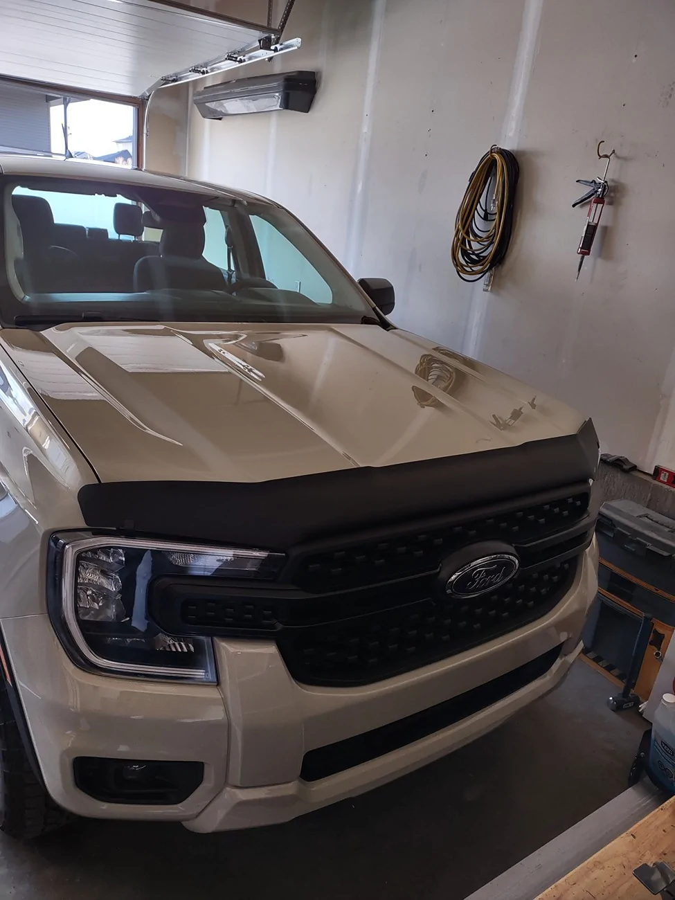

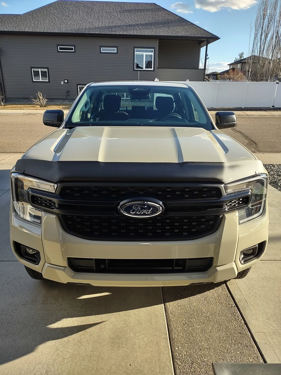

It's finally warming up in Alberta Canada. Washed the truck and installed the Airplex Hood protector I ordered off eBay before Christmas. Very easy to install. The only thing I noticed on the final steps was the plastic clip that is on the corners is so tight it tears the protective film you put on the corners of the hood when pushing the clip on. Other than that. Perfect fit and look!!

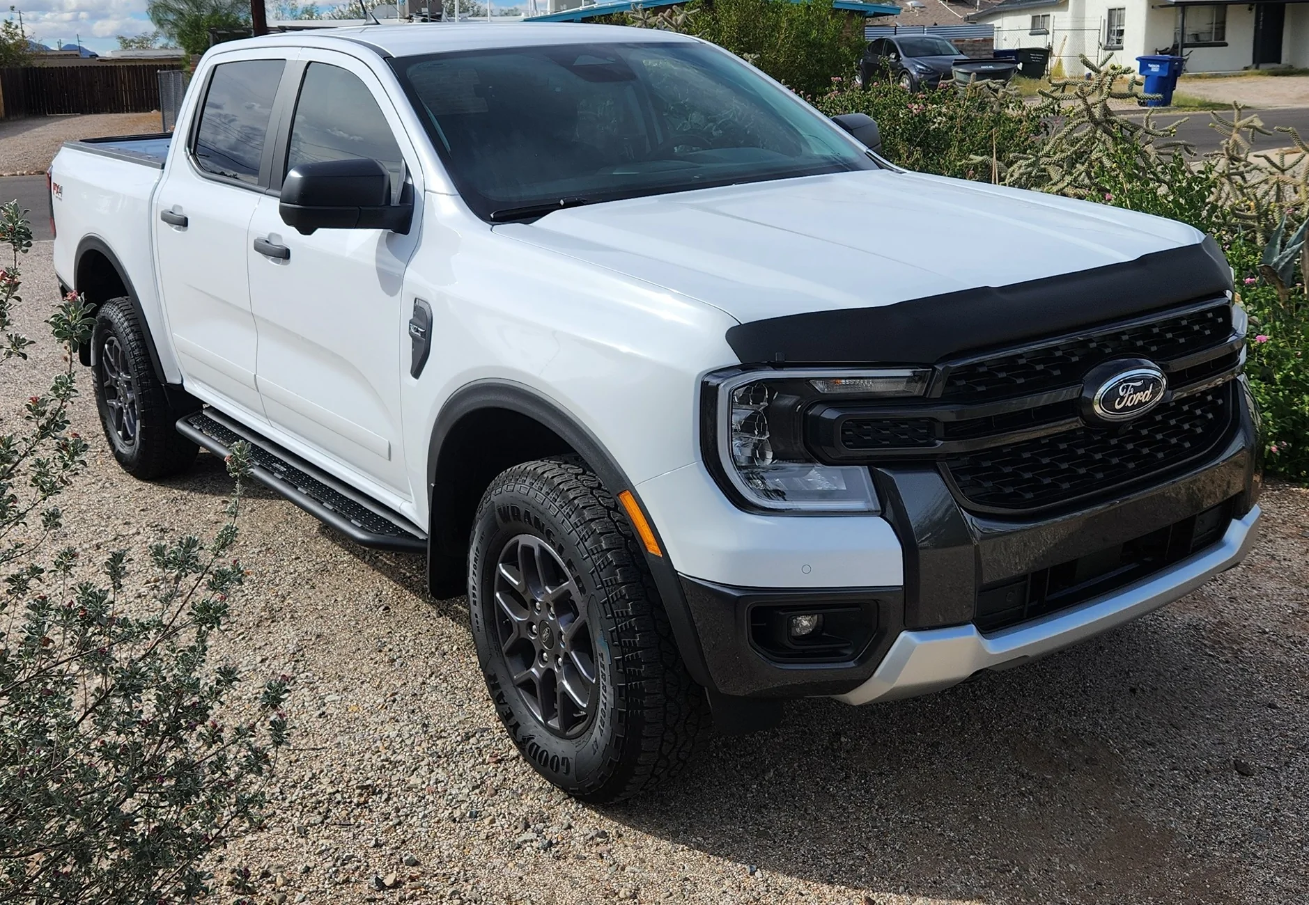

Looks good! On mine I didn't use the thin pieces of film they gave me, instead I cut some slightly bigger ones out of some 3M PPF I had on hand. I also warmed up the clips with a heat gun so they'd soften a bit and go on easier.
I'm happy with mine, in fact with all the black on the front of mine it makes the truck look taller. I want to eventually paint that gray lower part black as well, I think that will really make the front look like it means business!

Yours is looking great too!. Definitely good advice and pointers. I was afraid of making the clips too loose by warming them. Mine are definitely not going anywhere 😁
