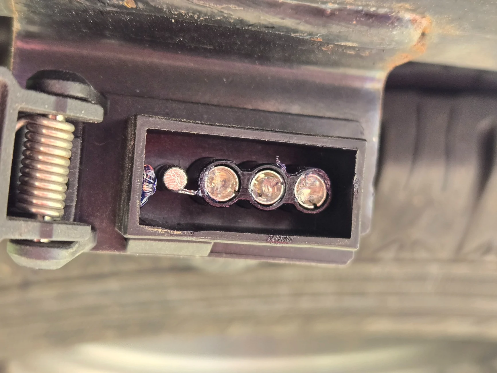

On my 2024 Ranger STX there is a connector under the rear bumper to the left of the safety chain mount. Can somebody ID it for me? Can't find any reference to it it Manual.

Im guessing youre STX didnt come with tow package, and that is the connector where the 4/7 pin harness for the 4/7 pin trailer plug would connect to.

Can this connector be used for LED light strips?
I would assume so, if it doesnt or if it throws any errors you can check the DIYs, i did one for tailgate light bar/strip that should offer an alternative/solution if you need it.

Technically all rangers come with the tow package. but only the top 2 show on the window sticker.
ford has the towing packages divided over "3 levels"
Tow package level 1, bumper ball hole, 4 pin electrical, and saftety chain hooks.
AKA No tow package
tow pack lvl 2. 2in reciver, 7/4pin electrical.
AKA tow package(shows on window sticker)
tow pack lvl 3. 2in reciver, 7/4pin electrical, and intragrated trailer brake controller.
AKA advance towing package
then you can tow package lvl 2 and lvl 3 with technology package(360 cams, trailer backup assist. etc)

Was there a cover on that or was it open like the picture shows?
