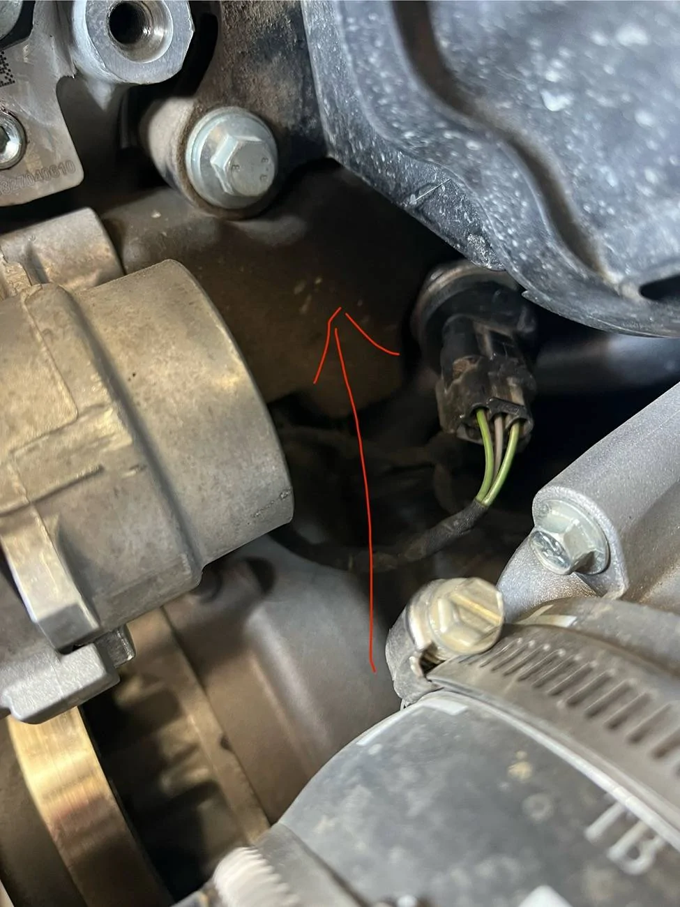

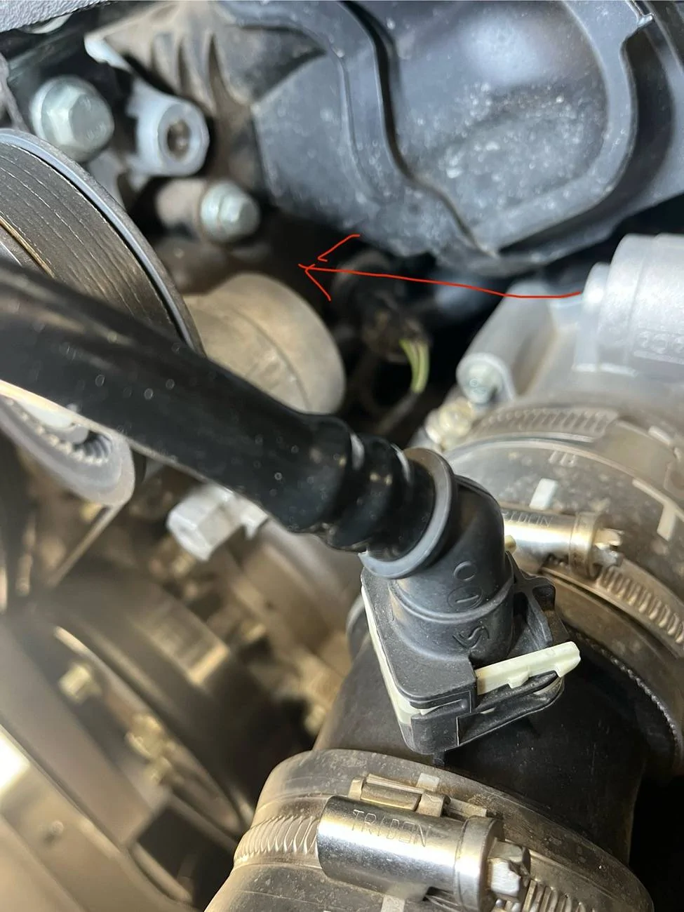

FWIW my 2022 Tremor with the 2.3L Ecoboost has a foam sound damping panel mounted over the injector area beneath the intake manifold. Maybe this has been deleted on the 6G’s?
It 100% has been removed in the 6G
