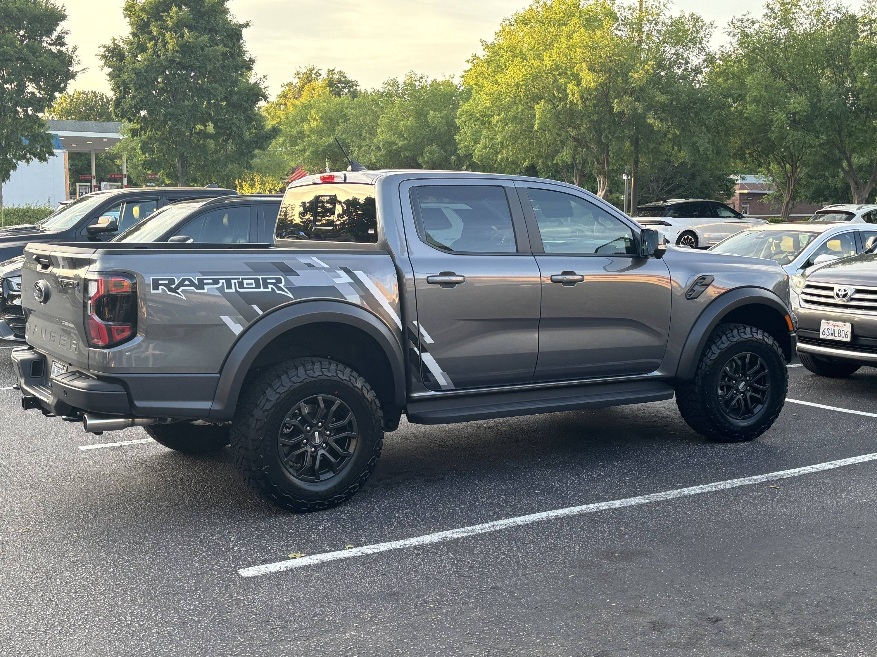

All…new to the Ranger Raptor platform and was looking to level the front a little.
Was wondering if a regular Ranger top hat spacer has the same bolt pattern. I only see 2 inch spacers for the Raptor and would like to keep a tad bit of rake.
Does anyone make a 1 or 1.5 inch spacers?

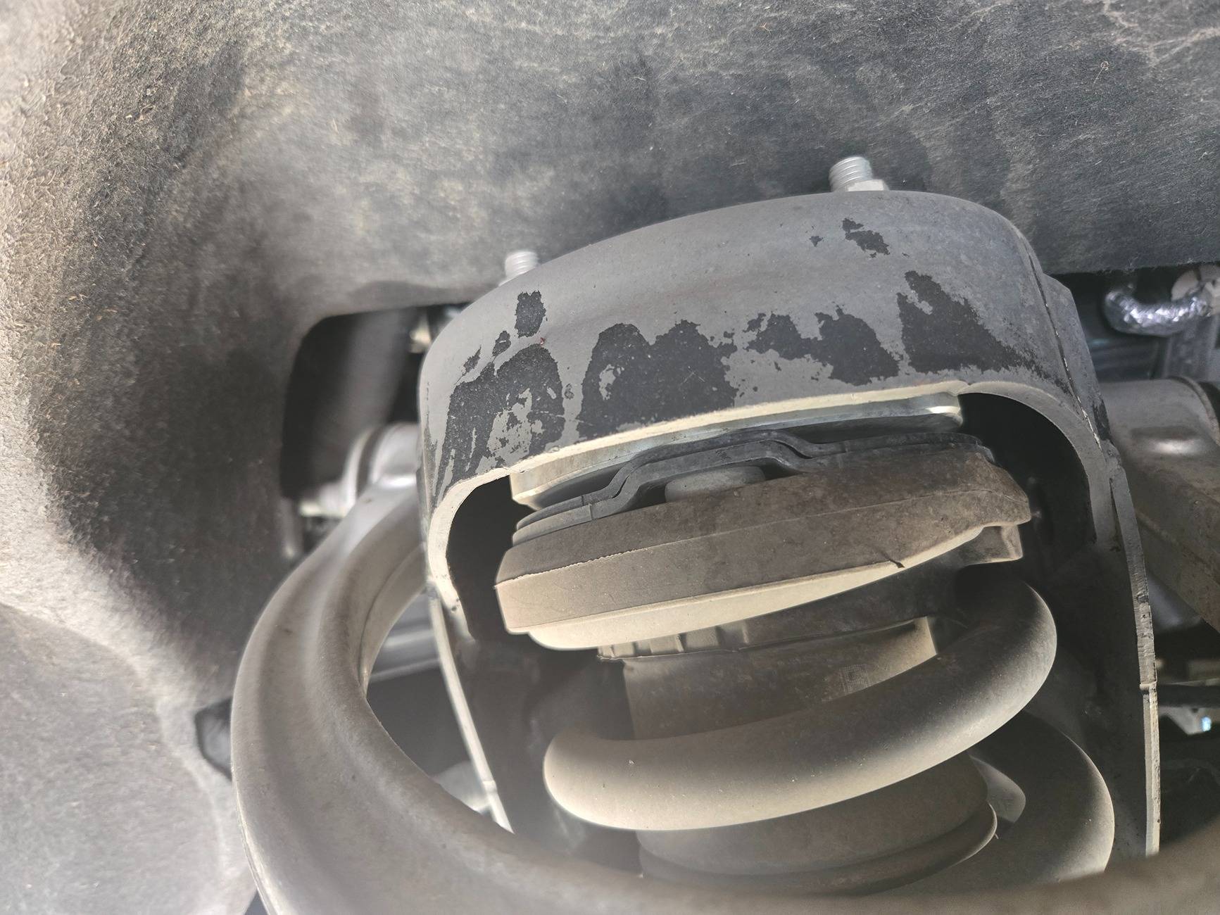

FYI, I am not trying to debate which is better, perch collar or strut top spacer.
I have seen quite a few people here that have used spacers for a Bronco.
Do a search for Raptor lifts and scan thru some of the post and you will run across the post with spacer lifts.
I added one post below.
Yep, on my F150 Raptor, I could feel the firmer ride with a Perch collar. On my Ranger Raptor with the 15mm strut spacer, it feels exactly the same as stock. I ordered it from this site in Australia. Overseas shipping was economical and it arrived very quickly.
https://shop.snakeracing.com.au/ranger-raptor-front-coil-strut-spacer-kit-25mm-lift/

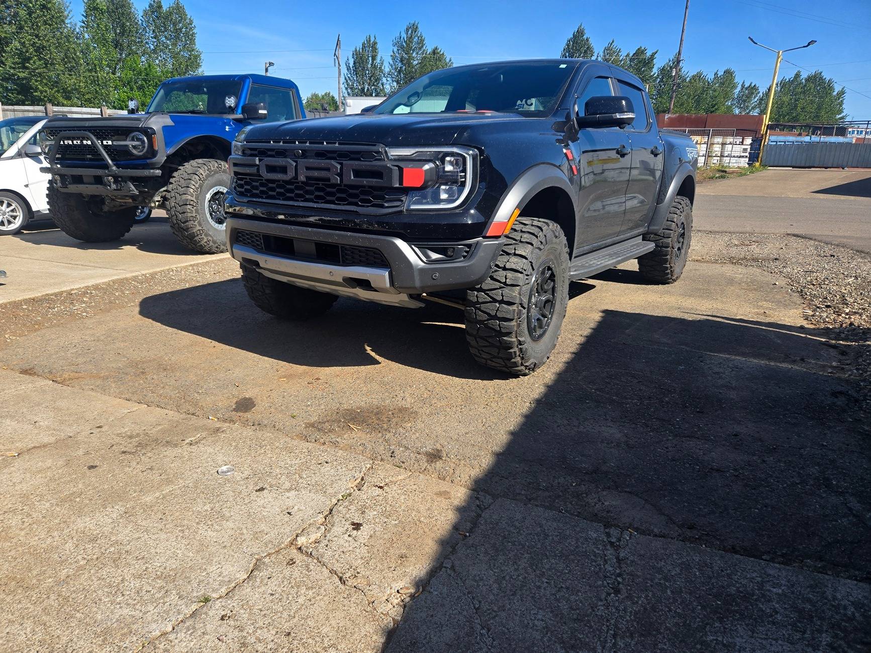

2021 Bronco First Edition, 2024 Ranger Raptor
self
readylift has a 1.5 also
