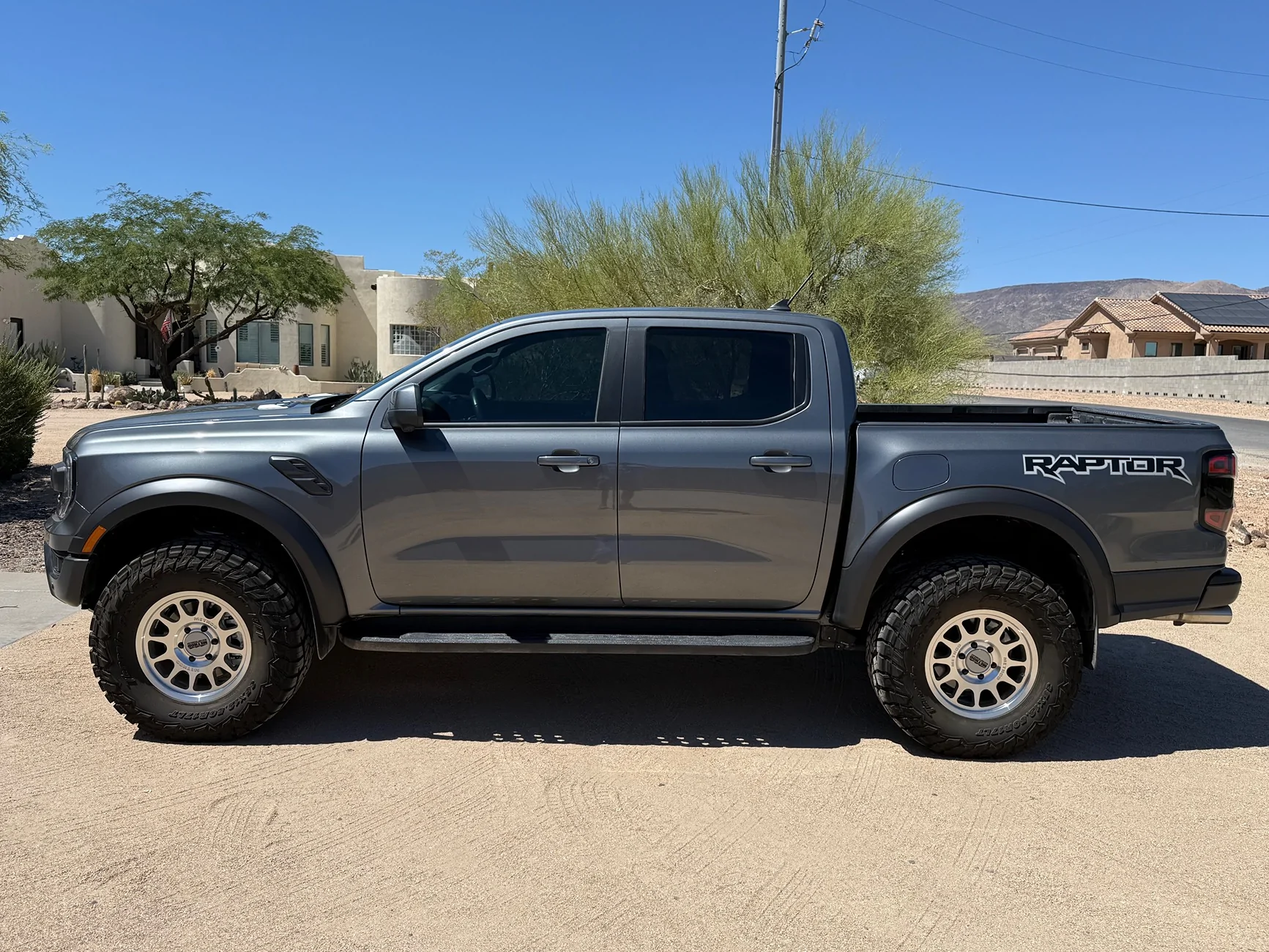

I went with the 2/1 for my '26 Raptor Ranger from FordRangerLifts.com. This company is owned by Robby Woolworth and he has a lot of experience as a desert racer and designed these. I also has him do the install at his place in Las Vegas as I am in AZ. This allowed me to mount 35s on the RR after only replacing the crash bars.
https://fordrangerlifts.com
I also did 2 and one goat off-road. I'm on 35s and didn't remove the crash bars at all. Tires don't even come close
Tires may not come close, but I do some rock crawling with my Jeep friends and I didn't want to find that they are in fact close, or rubbing, when turning the wheel and they are traveling upward.
Yeah, I have to say that I don't do much off-roading with the wheels fully cranked. I do off-road in the desert a lot though. Getting air and with full compression and they've never touched anywhere
