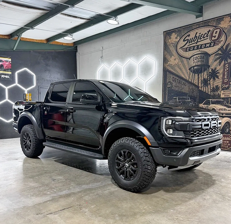

First off was a full ceramic coat and window tint. I went with an 8 year ceramic with full paint correction, it really makes the black pop. Window tint is 15% all the way around with 30% windshield and 5% sun strip. All ceramic Tint as well
Ford Ranger New member, black Ranger Raptor w/ mods so far 95721-17345a4758c7f1634bbc5489f473d87f

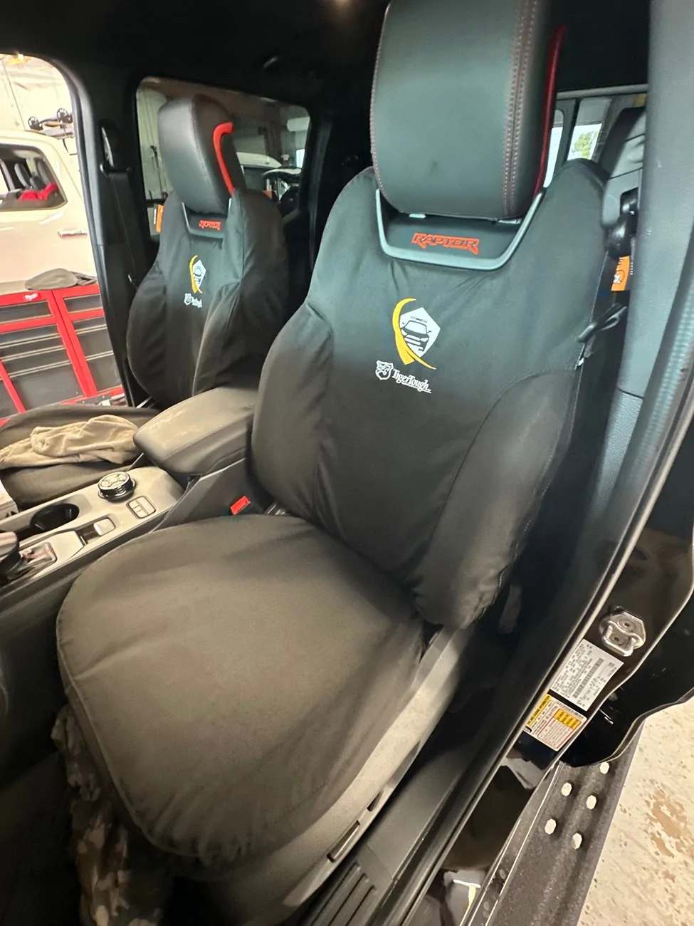

next up was some custom seat covers from TigerTough. Had them do my company logo along with theirs. I sell their seat covers to most of my departments, so this was a no brainer to help showcase their products
Ford Ranger New member, black Ranger Raptor w/ mods so far IMG_3850

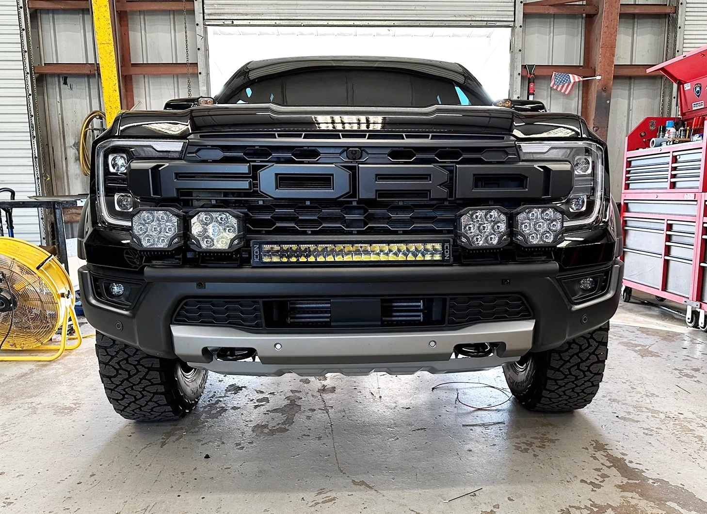

today I added the Foutz front light bar, along with some Morimoto big banger lights on it, 2 flood (outer) and 2 spot (inner) along with a Federal Signal Icon light bar. This light bar has an upper row amber marker light and a dual lower row LED spot light. None are wired up just yet, need to get the other lighting installed and controller. Will update this thread once that’s done.
Ford Ranger New member, black Ranger Raptor w/ mods so far 95723-384a3fa77ee21cf2dcbf145332036d52

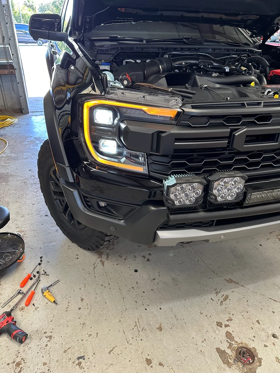

I also added the Amber DRL drivers. Definitely worth the effort to do these.
Ford Ranger New member, black Ranger Raptor w/ mods so far IMG_3883

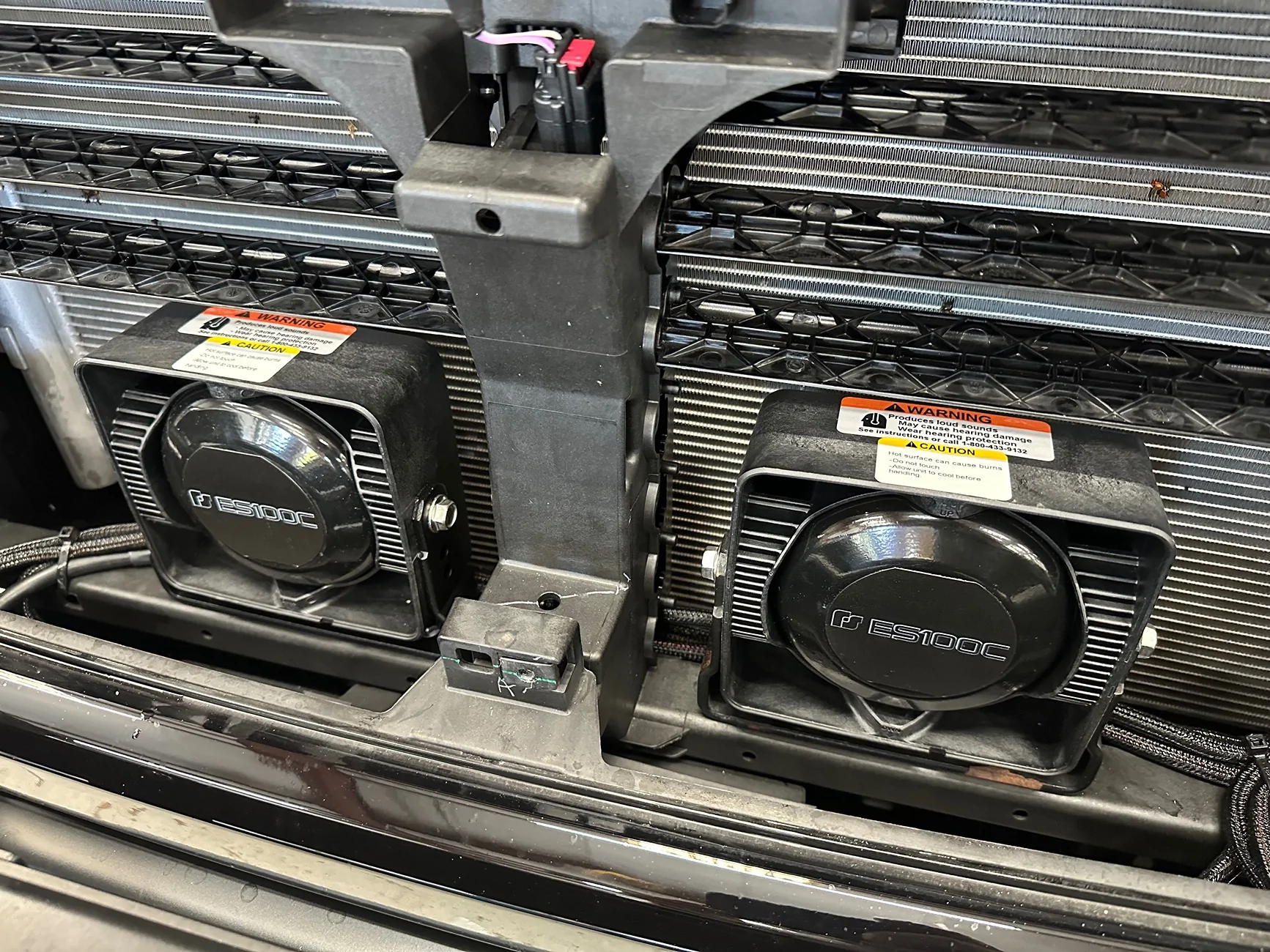

When I did my brothers truck, I put a couple speakers behind the grill. Had to remove a couple of the grill shutters but they fit really well. Only removed the lower 2 or 3 so the rest of them are in tact and still function. I will likely do the same thing on mine.
Will get some pictures of my install when I get it going.

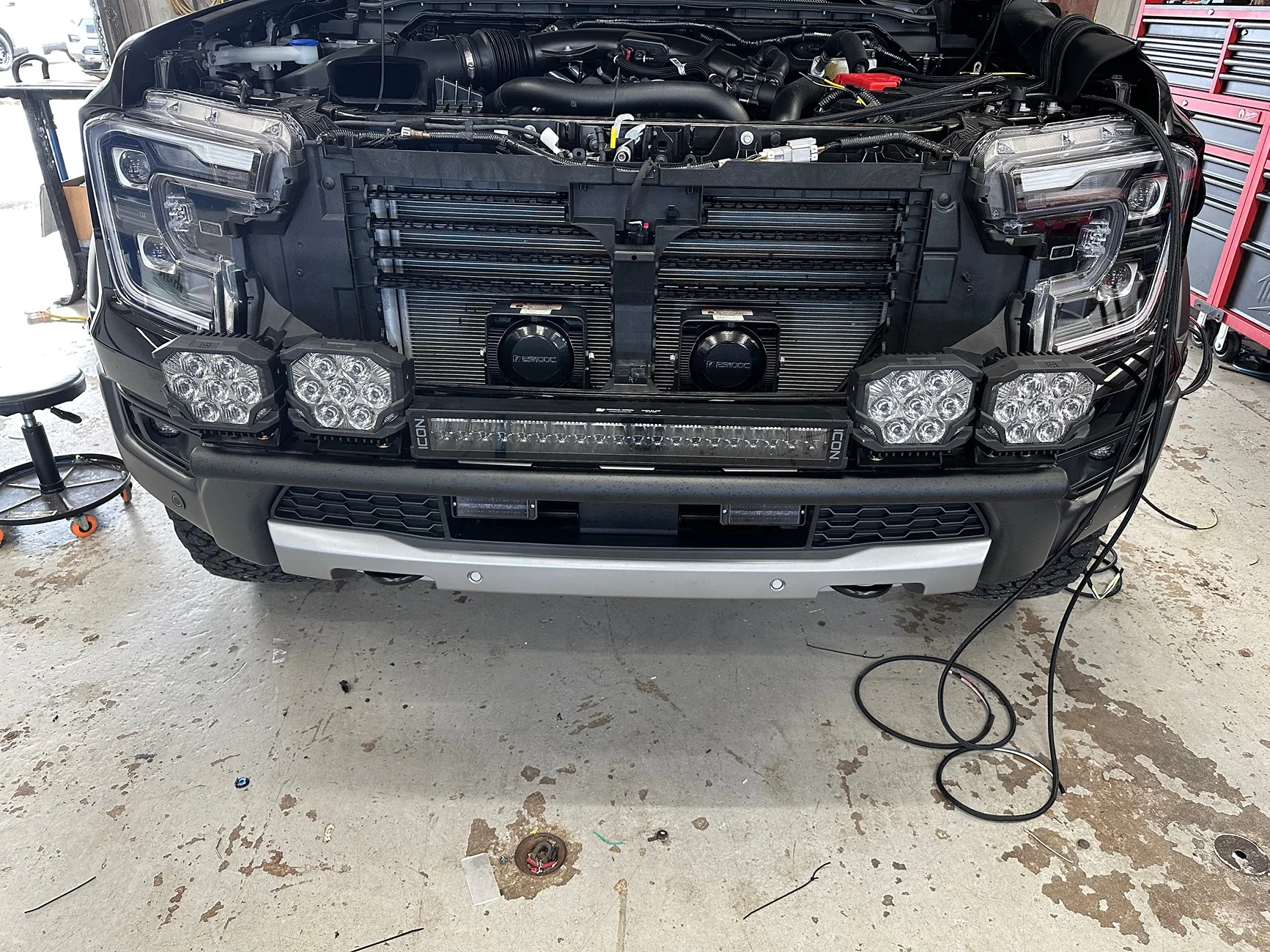

So this is where I mounted my speakers
Ford Ranger New member, black Ranger Raptor w/ mods so far IMG_3920
Ford Ranger New member, black Ranger Raptor w/ mods so far IMG_3921
took out the lower 4 shutters, bolted a basic universal speaker U bracket to the lower bar of the grill shutter surround. Very stable and the upper shutters still open and close fully.

Awesome. Thanks for the pictures. How do you remove the shutters? I guess you just bend them and you can pop them out?
CrankCase
CrankCase
Feb 29, 2020
Melbourne, FL
Owner- Frontline Vehicle Solutions
Yup, they just have a pin that locates them on either side, pull or push it in the center to bow it, and it’ll pop right out.
