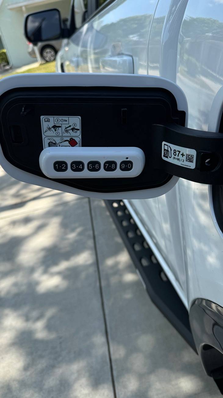

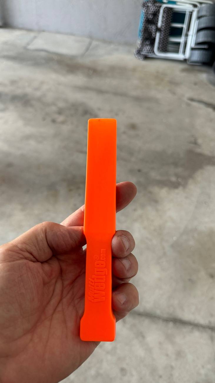

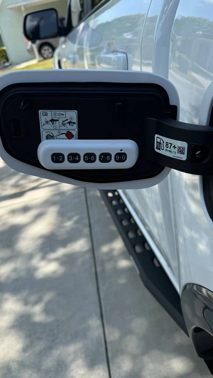

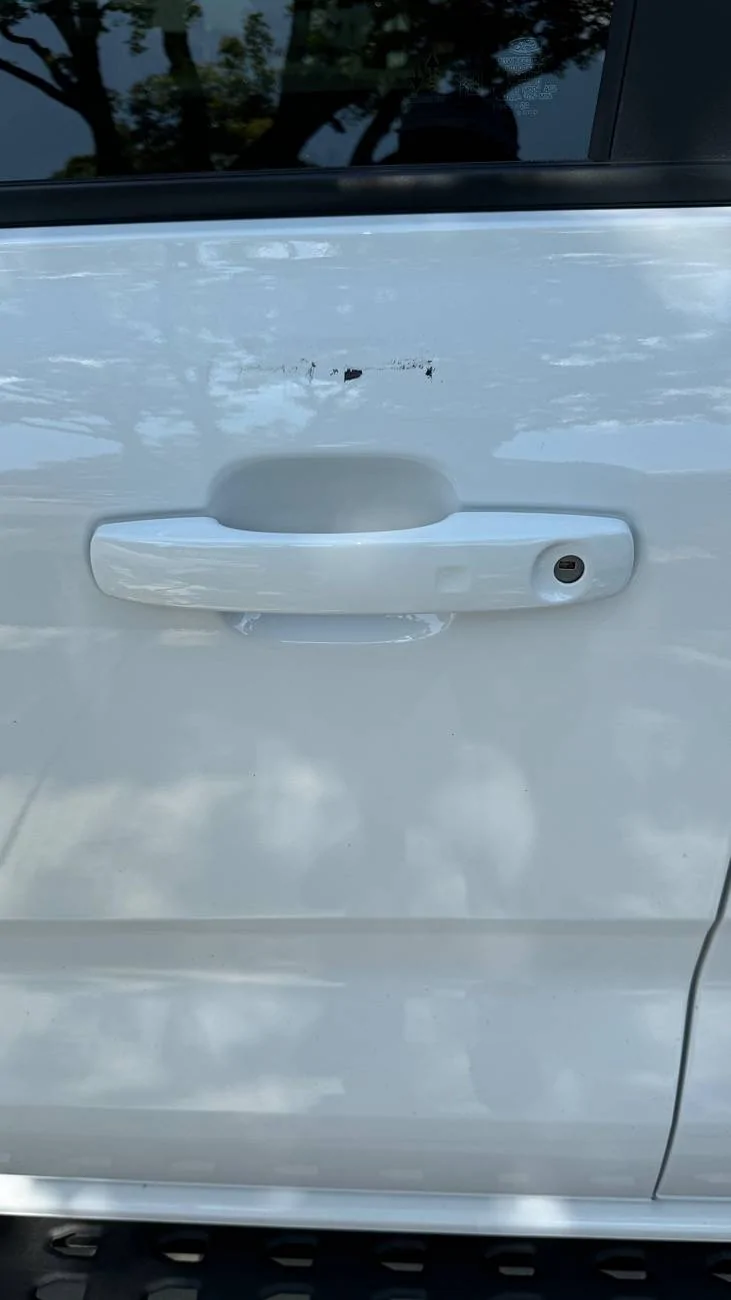

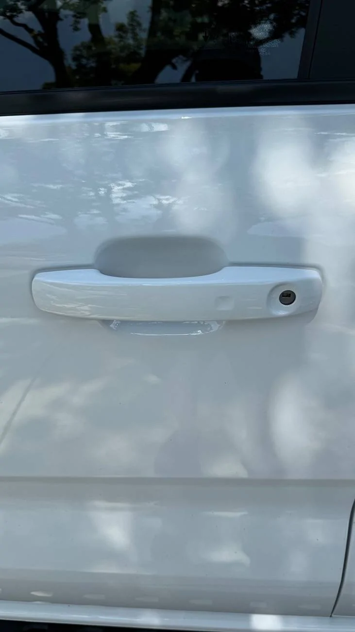

Got my wife’s hair dryer out and used a Harbor Freight plastic pry bar and gently lifted it off, stuck it back on the back of fuel door and got the Goo Gone and got the door back to perfect without any marks, shadows or damage. The door looks so much cleaner now. ✅

Wow, nice! No trouble working? Being that it is farther from the control module now?
