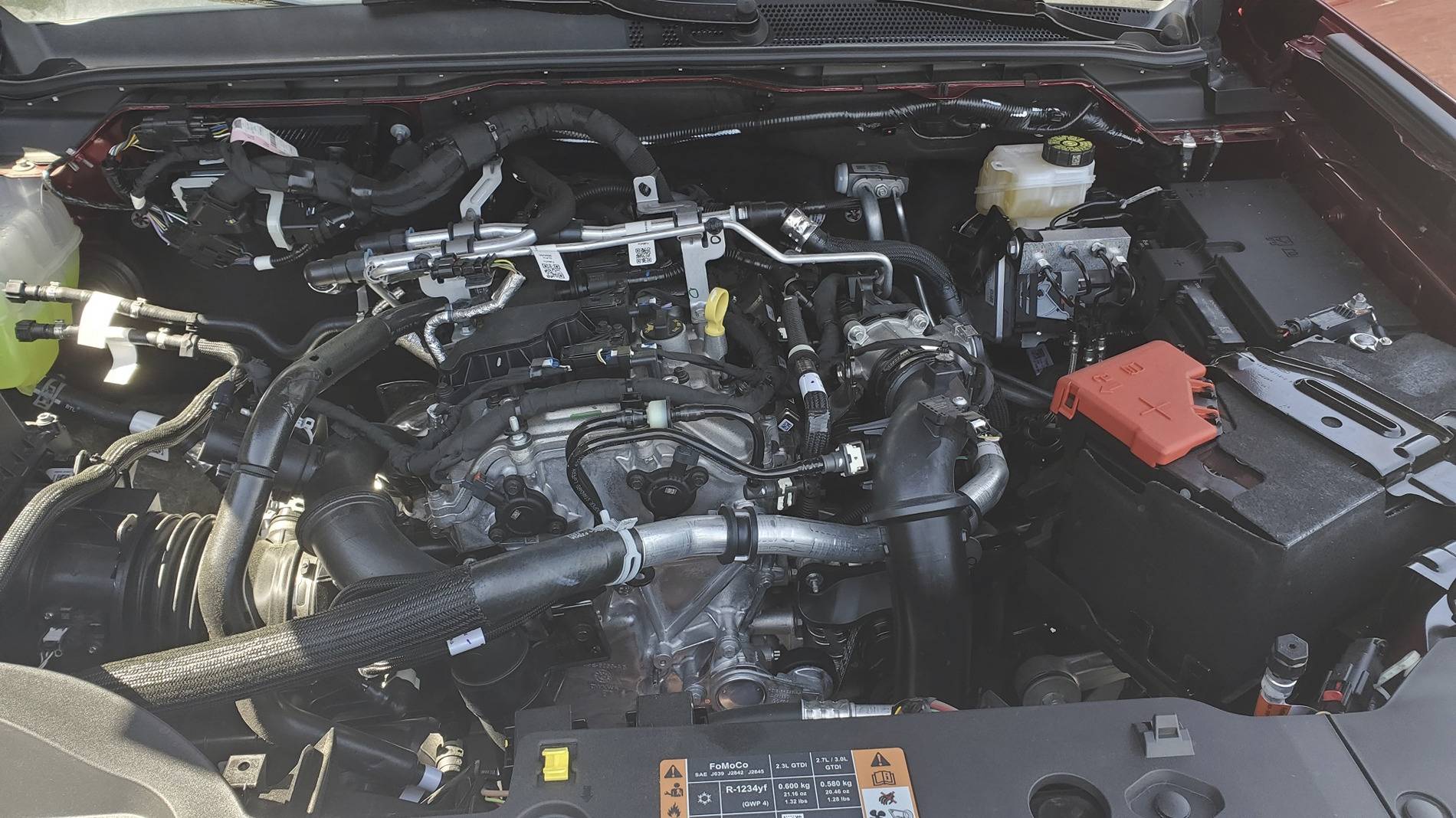

2024 Ford ranger XLT FX4 2.3L POOR STOPPING DISTANCE.
bulldog36526
Dan
Apr 2, 2025
33
Daphne,al
2024 Ranger XLT FX4 2.3L
I have the old style. Thanx
