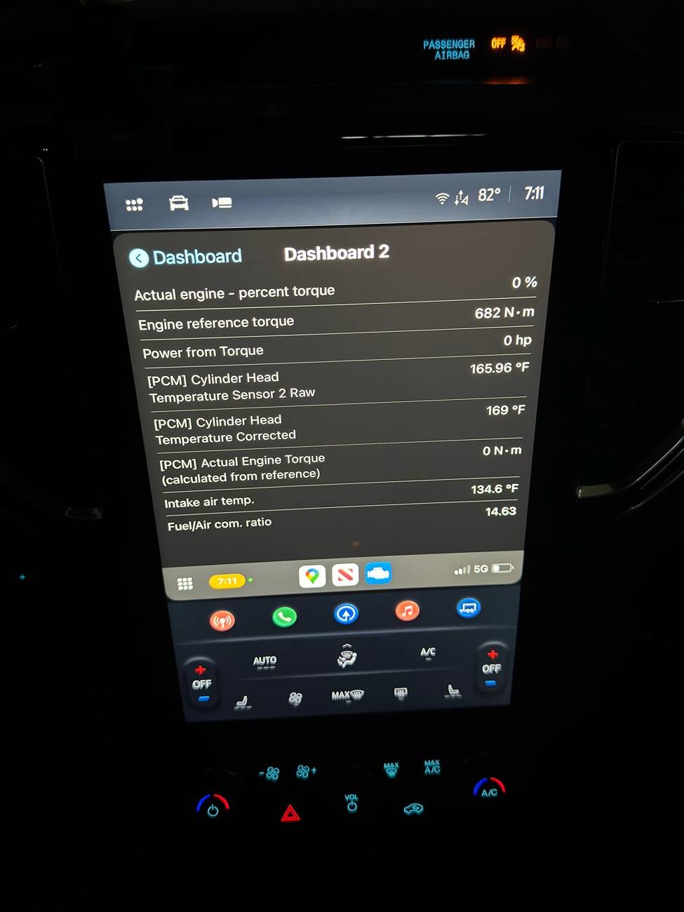

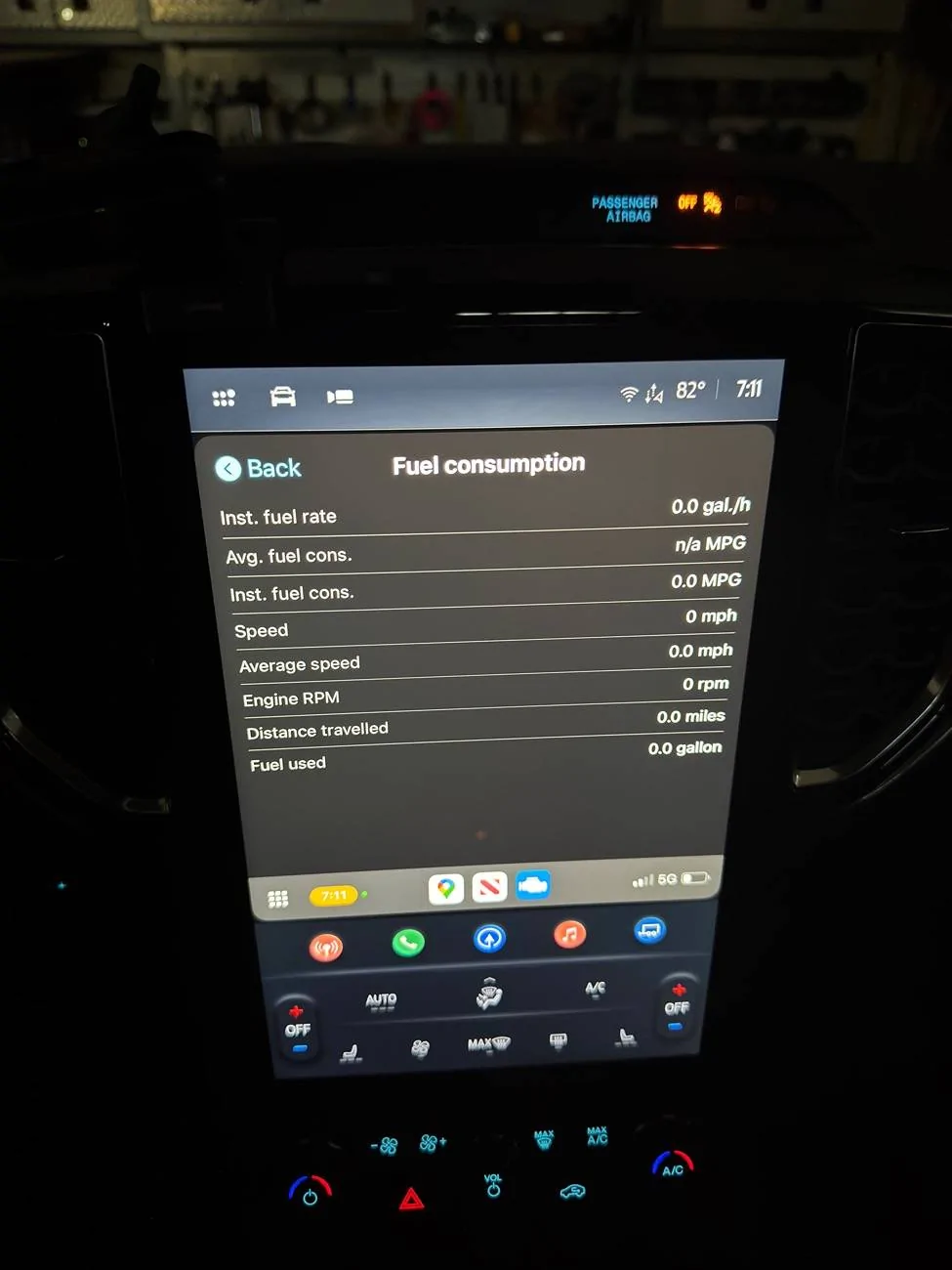

I wanted more information than the instrument console provides (transmission temp, what gear am I in?, rpm number, boost pressure, etc). I thought about purchasing a ScanGauge (2 or 3), but did not like the idea of having to mount it somewhere in addition to the cost. Is there an OBD2 app that works in CarPlay? Yes, I found two for my iPhone, OBD Fusion and Car Scanner ELM OBD2. I decided to try the latter first as it is free. Oh, you will need an OBD2 scanner as well. I bought a new bluetooth model (Veepeak BLE+) as my old reader was WiFi and difficult to connect to. I found the Car Scanner app to be pretty easy to configure. You get three screens with the free version which is plenty. Here are some photos of the CarPlay display, I was parked in my garage so not many actual values.
Ford Ranger OBD2 info displayed in CarPlay obd_dash_1
Ford Ranger OBD2 info displayed in CarPlay obd_dash_2
Ford Ranger OBD2 info displayed in CarPlay obd_fuel

Looks super helpful! Might have to get myself the same. Random question but is your IAT usually around 130? I swapped my intake and didn’t record numbers beforehand!
That temp reading was while sitting in the garage after having driven the truck for a bit. My guess is that 130 was a higher reading as no air was flowing in. I will get back to you on what it is during normal driving.
So, I don't know much about intake temperatures and such. There were two intake temperatures availble through my reader. The first was close to the outside ambient air temperature. The second was usually about 18 degrees higher. Hope that helps. I guess that an after market air intake is supposed to lower that delta?

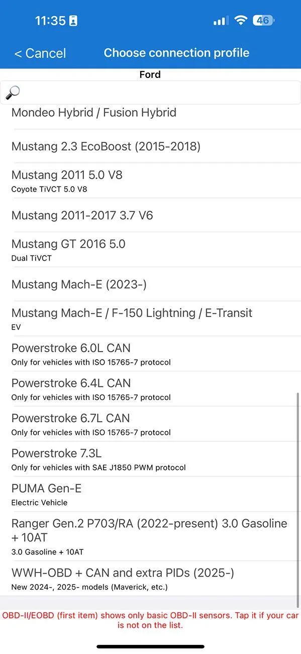

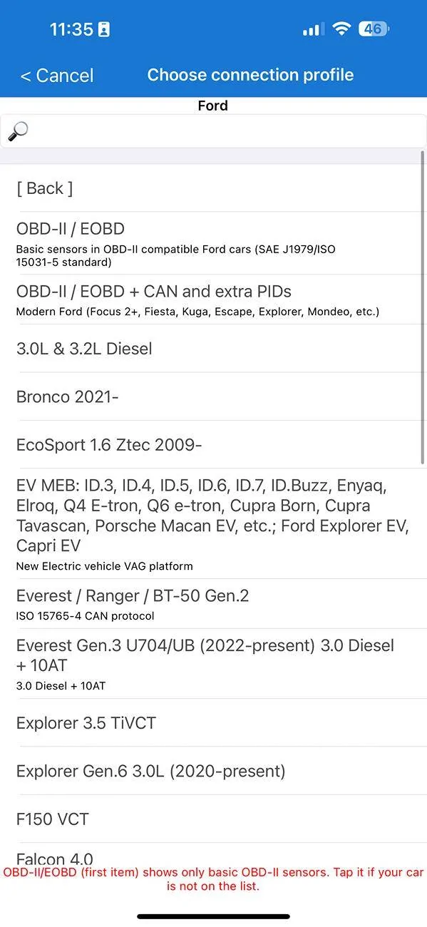

Anyone know which setting is for our 2025 ranger when setting up the scanner. Thanks!
Ford Ranger OBD2 info displayed in CarPlay IMG_1268
Ford Ranger OBD2 info displayed in CarPlay IMG_1267
