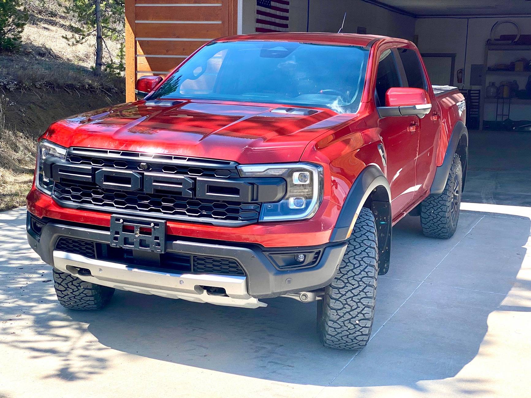

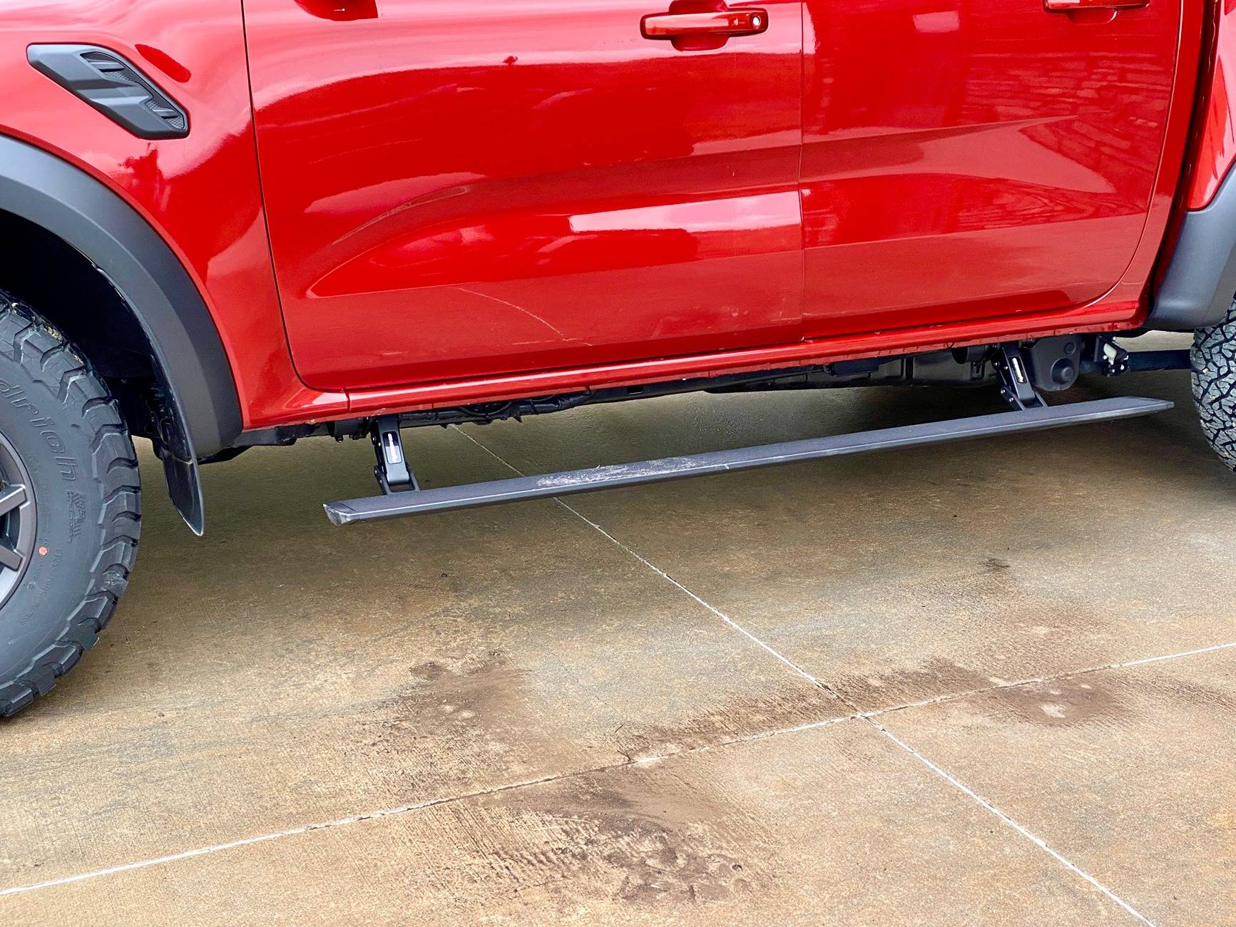

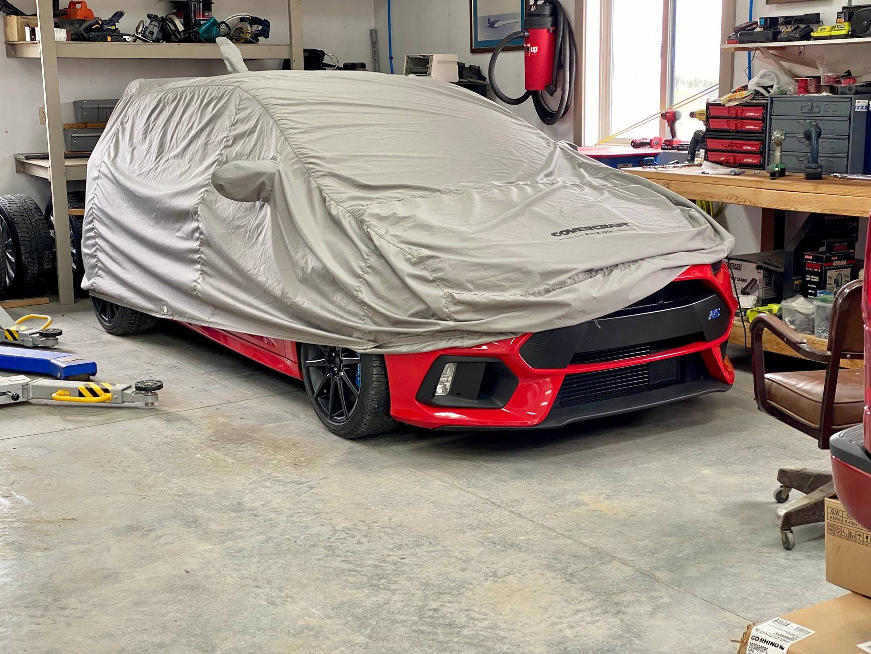

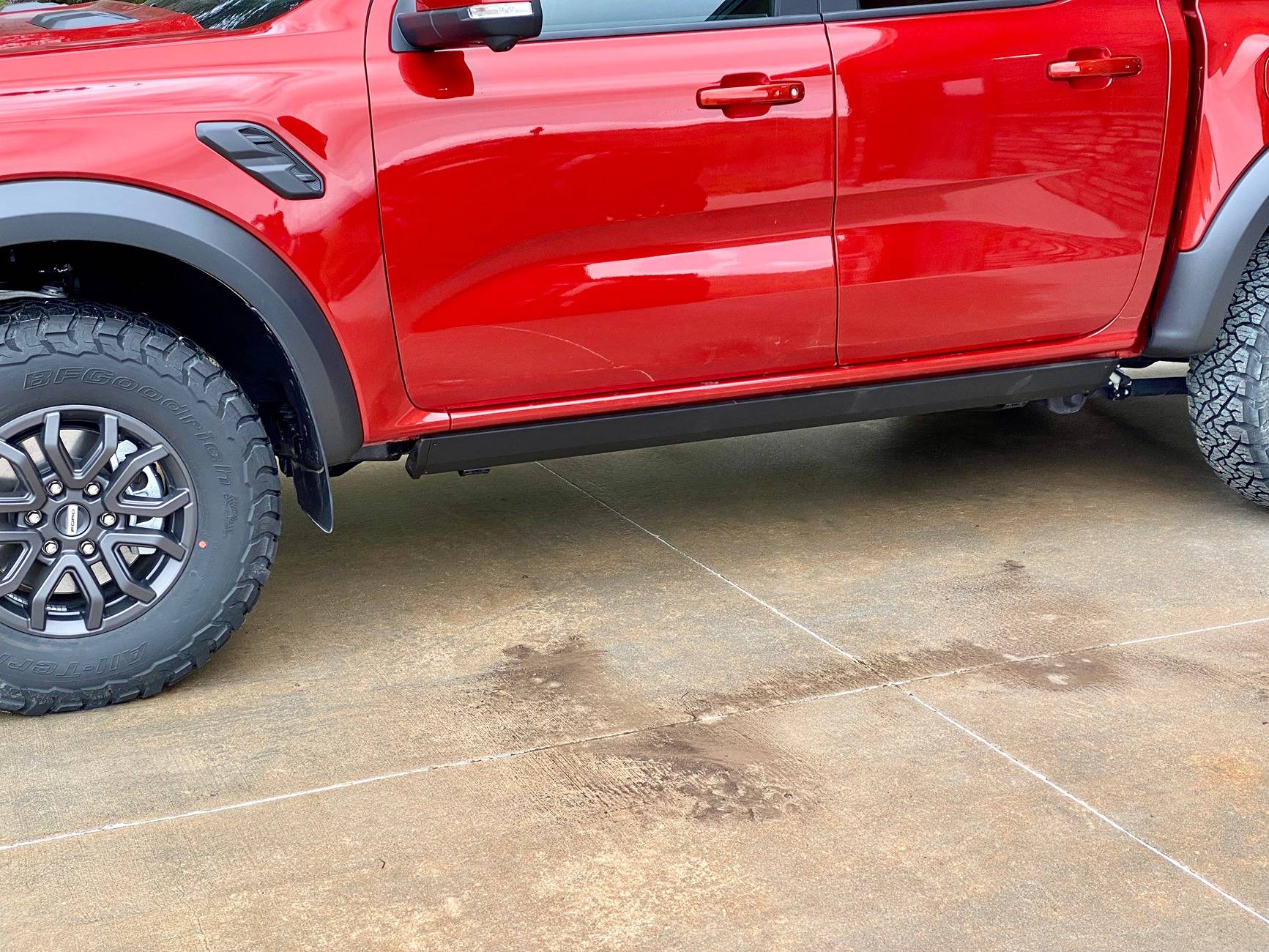

@ Telenerd. Took my time and boards worked fine the first time. Fit was excellent too. Couldn't resist a photo of my '18 RS.

Just a heads up, one of the threads on here said their power running boards retracted too hard a couple times and put small dents in the rocker panel. My wife has a white Ranger Raptor and I just ordered an identical one and was thinking of doing the same. Nice truck my friend!

@Johnny 5. I saw the post about the damage to the rocker panel. As a result of that post I double checked the clearance between the boards and the body. There is about a quarter of an inch from one end to the other on both sides. I have a certain amount of apprehension about the mud and slush I will experience next winter, but will lube the joints and pressure wash when it gets bad - and it gets bad here with our clay based soil. It's also why I purchased the Go Rhino - there is a motor on each of the four mounts to the body which should be better than one larger motor on each side. We'll see.
Since you are considering ordering electric running boards you've no doubt done some research. I strongly suggest you consider running the PAX side wires in the back seat. So much easier than trying to run wires under the carpet of the front seat or up in the dash.. I removed the two storage "buckets" under the rear seat. Threading the PAX side wiring was then easy and painless without having to deal with the console. I drilled a just-large-enough hole on the driver's side rear between the upright steel supporting the rear seat and the kick panel, and after running the wires filled the hole gap with RV rubber cement. Depending on the brand, AMP or Go Rhino, you may have to extend the wires, but that's not a big deal. I was careful to tuck the wiring up and out of the way on the underside of the truck so rocks and off-road scrapes will not damage those wires. Frankly the biggest concern were the wires to the battery. They go next to the driver's side catalytic converter and the concern is heat. Be careful there.
