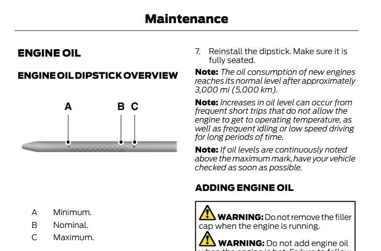

I just double checked the manual (pg. 406) and it looks like the 2nd dot is "ok", but not ideal. It's listed as the maximum, with the nominal spot being just at the end of the crosshatched area. Realistically, if you shoot for the center between the dots you'll be fine (which is what I've always been taught).

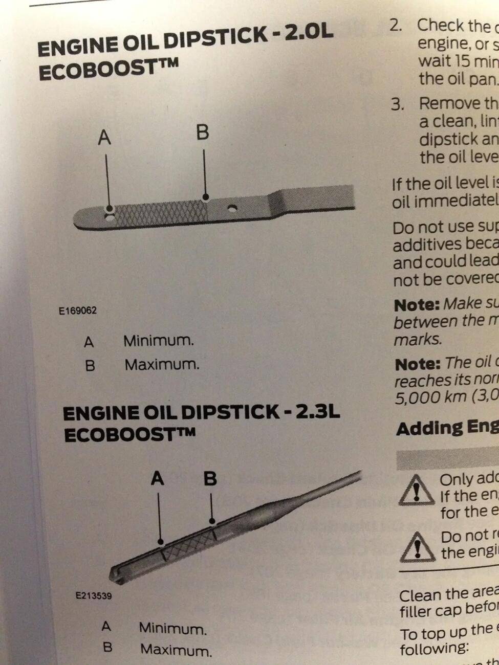

I don't know why manufacturers can't come up with a consistent way to measure your oil. For example, here's the instructions for the 2.0L and 2.3L EcoBoost engines, which is why I always just shoot for the middle and call it a day. The 2nd dot for a 2.0L engine would have been overfilled in this case.

So your answer is: read the manual! Thanks for the response, which I should've have needed. I just looked at the manual for my 2.7 l Ecoboost. It's written more vaguely, but essentially echoes your manual.
