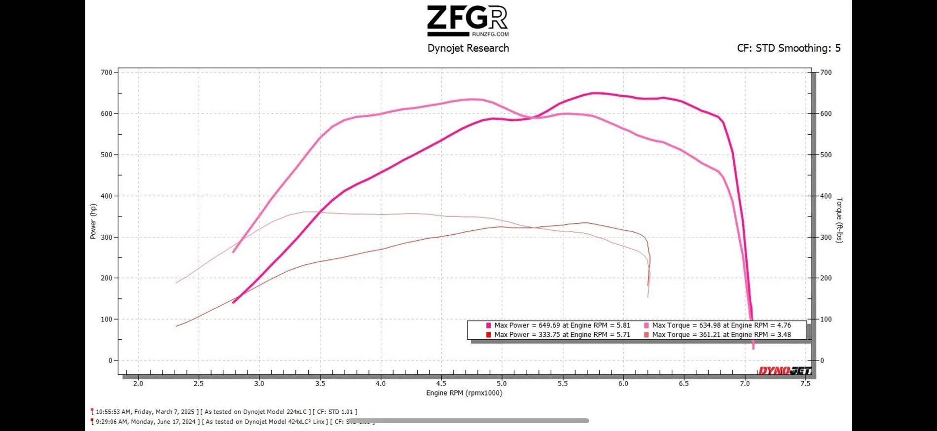

You’re welcome. I agree about the transmission needing to be upgraded if you go all out but I think the engine has a lot more in it for sure.
Here’s factory turbos massaged by CRPerformance. Had a little more but had to get off dyno before we were finished.
Ford Ranger Poll: Stock or Pro Cal (What's your experience, Good, Bad, Meh?) IMG_7738

Welcome to the community!
Factory size tires/wheels/weight then stock transmission around good for around 525 rear wheel torque.
Bottom end/cradle 700rwhp, hopefully 750, let you know soon.
If that's the case, then the Pro Cal is NO WHERE near that max, so should be about as long term reliable as the factory cal.
BTW, 525 WTQ * 1.14 = 598.5 lb-ft of input torque to the 10R60....which is rated for up to 600 lb-ft of input torque. SO that makes perfect sense and lines up very well.
The Pro Cal is only putting down about 430-460 WTQ at BEST. With crappier weather and altitude, less. So, I can buy that 525 WTQ is about the limit.
Also, any transmission should be rated to last, it's full severe service lifespan of 150-200k at MAX input torque. So even with a Pro Cal, with proper maintenance, it should last the life of the truck.
Although I doubt drag racing it with brake boosting constitutes "severe service" conditions...that's beyond the scope of normal use so your mileage may vary...
Is that on a built 10R60 or you just running the stock trans until it blows up then rebuilding it? I'm assuming since your on-factory turbos, the bottom end is also factory.
Deleted member 9086
Ask him how many times he’s blown the rear end out of the truck and the other issues he’s had? You’re only hearing half the story.
If he pushes it to what he claims, it will be a new engine, new rear-end and new trans.??

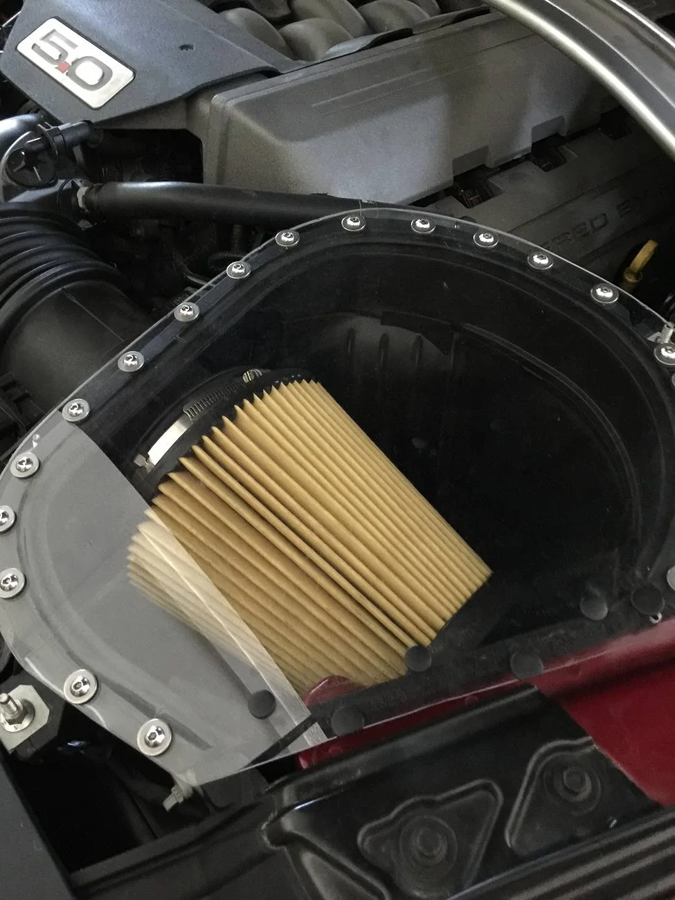

I guess one caveot would maybe be a CAI, then toss the re-usable filter and fine a paper conical filter that is the same size. There's a ton of conical paper filters for big trucks that will flow better than the stock panel filter you could use with a CAI to increase flow and dust capacity more than stock, but avoid the contamination issues of oiled cotton filters and AFE dry filter types.
The Stage 2 Power Pack for my GT did that, had a large conical paper filter from the GT350, which is a production track car. They used OE type filtration media for a reason!
Ford Ranger Poll: Stock or Pro Cal (What's your experience, Good, Bad, Meh?) IMG_0075
Thats the Ford OEM GT350 intake (with throttle body) that comes with the Stage 2 Power Packs for 2015-2017 Mustang GT's with the 2nd Gen 5.0L. I just sealed it off at the top since the hood seal didn't work well and used custom ram air ducting up front like the actual GT350 did to build a small amount of pressure inside thus reducing restriction.
Still, the warranty thing...if you don't care, by all means. For me, the Pro Cal doesn't throw any visual red flags and it's done by Ford Performance which is stamped all over the truck...and it's installed by the dealer. That's a very winnable warranty repair scenario vs. other mods.

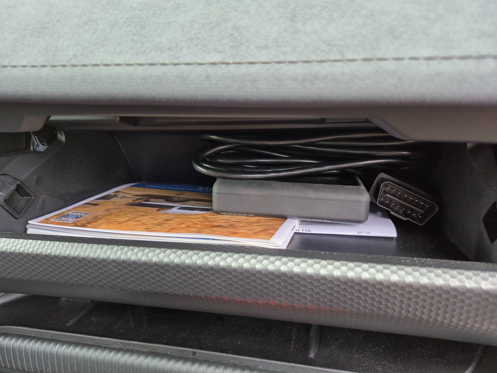

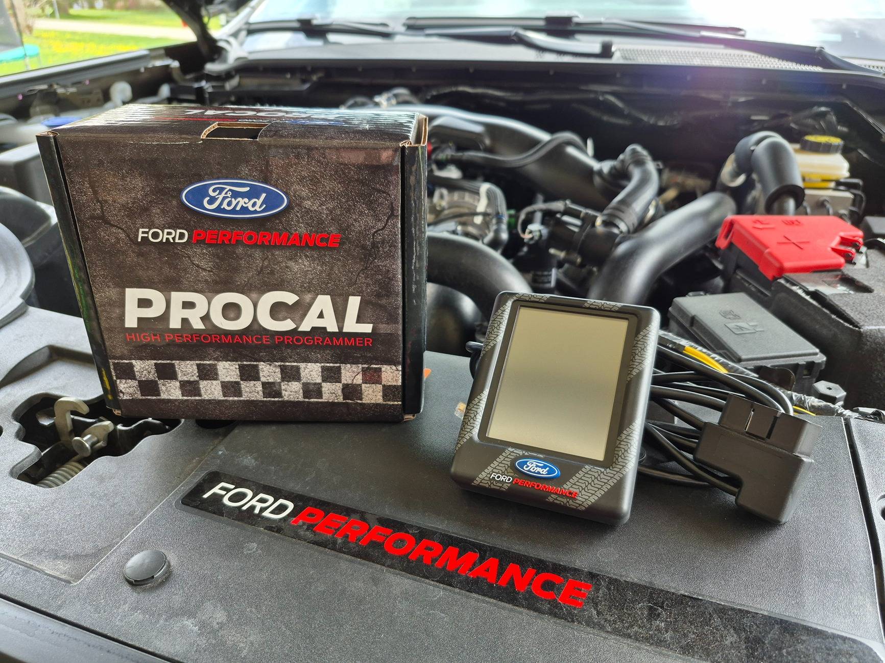

Got mine installed today, $167 after taxes. Took it out for a spin (well, the trip home was about 31 miles), nice improvement in shift points and I think the transition from no boost to boost is much more linear than before.
Factory cal, in normal mode, it kind of felt like I'd get no boost or really get into boost quickly, there wasn't much of a "50%" region, so I agree with others the transmission tuning alone was worth the price of admission.
Even though it hasn't gone through a drive cycle to do the "learn" yet for full power, I would say the mid-range torque is already there (most dyno runs show the same, some of the mid-range torque is immediately available).
It's impressive to me already between the trans tuning and mid-range torque. Although I do periodically get a burning smell, almost like oil. Not every time. At about 5k miles on this oil change interval with Motorcraft FS and it's still at the top of the dipstick, so it's not burning oil (or if there is oil vaporization its extremely low).
Note that I've had this intermittent burning smell off and on since the truck was new, usually after running it hard.
I've read a bunch of posts from owners of Bronco's and ST's experiencing that periodically as well. Anyone else get that and know the source? My guess would be contaminants spraying up into the engine bay from the partially open wheel wells burning off the turbine side of the turbo housing.
I checked both turbos and don't see any signs of oil or coolant on either. Don't see any leaks around the valve covers, nothing under or around the pan. Not a drop. It's not all the time either, just sometimes.
Ford Ranger Poll: Stock or Pro Cal (What's your experience, Good, Bad, Meh?) 20250425_135014
Ford Ranger Poll: Stock or Pro Cal (What's your experience, Good, Bad, Meh?) 20250425_134851
