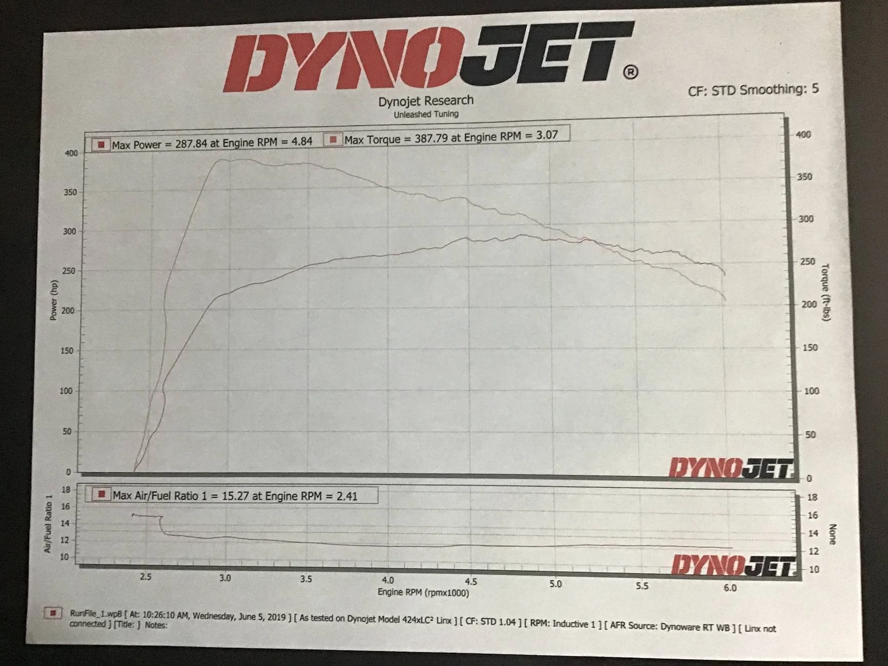

Unleashed stock 93 octane 2019 Ranger XL ..2.3 ..
Ford Ranger Poll: Stock or Pro Cal (What's your experience, Good, Bad, Meh?) IMG_0041

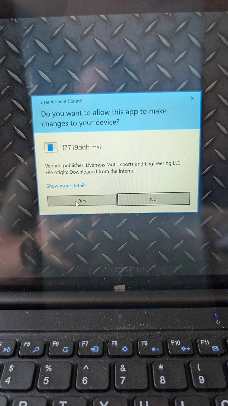

Actually Livernois motorsports are the ones who developed the tune. They cracked the 2021+ Ford F-150 first too. Ford ran with a watered down version of their tunes. It litteraly says Livernois when you're uploading it.
Ford Ranger Poll: Stock or Pro Cal (What's your experience, Good, Bad, Meh?) PXL_20250621_183046867

FP has worked with Livernois in the past, may be possible they are using their base sw platform (i.e., the programmer is a private label), however that doesn't mean they developed the ecu calibration. FP uses a lot of different vendors and suppliers for hardware that meets their requirements, sometimes its an off the shelf part with their own modifications like the Bronco Method 703s other times its from scratch.
