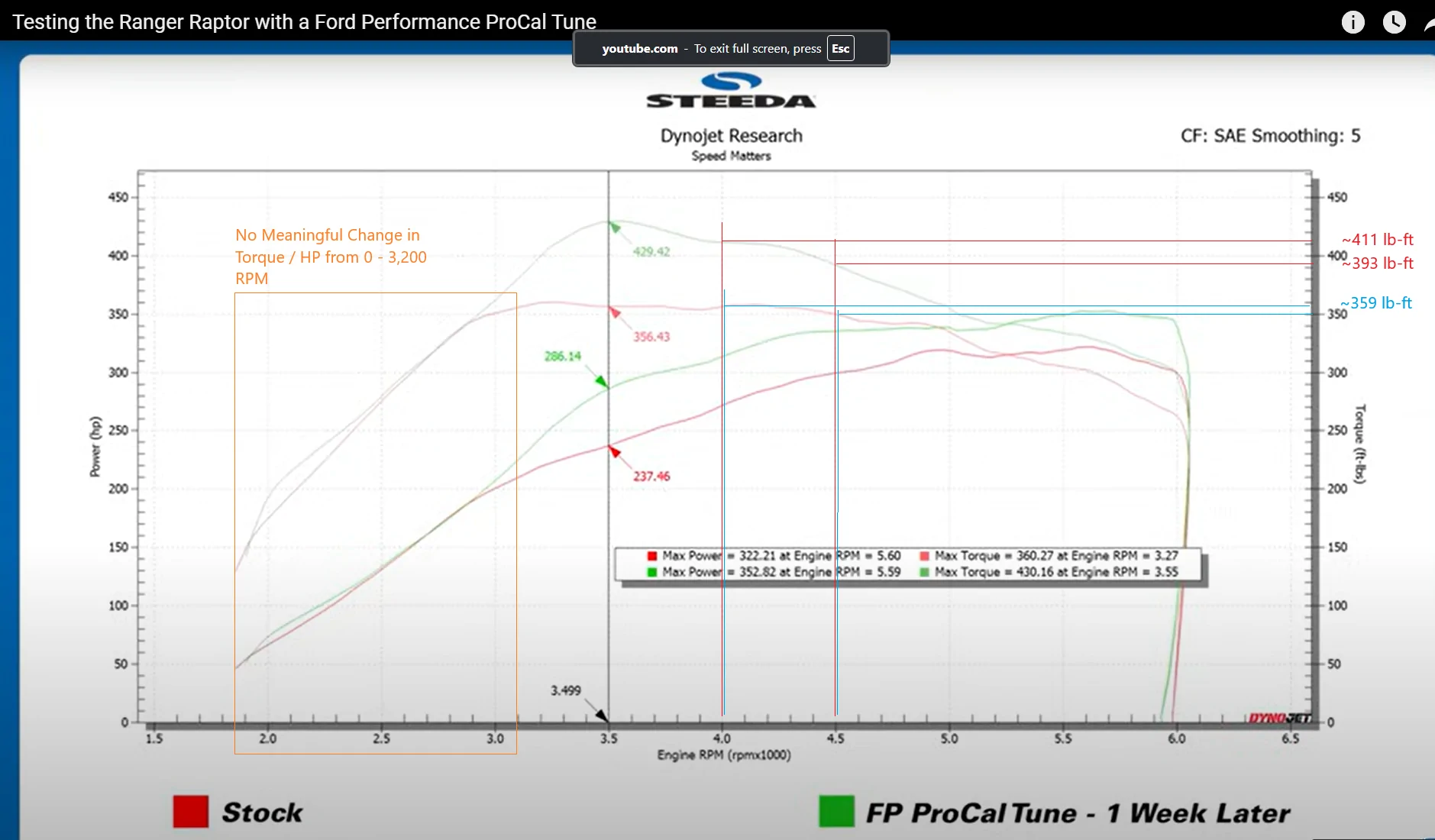

That's why I've said over and over again, I challenge anyone to find an actual Ford print on the transmission showing the naming nomenclature, it's probably not what most people think.
I already posted the 6.7L HO / 10R140 example. 6.7L HO option makes 1,200 lb-ft torque, if you convert 140 * 10nm ~= 1,032 lb-ft.....DOES NOT COMPUTE! I MIGHT buy that it could be 140 * 10 lb-ft = 1,400 lb-ft, that COULD be possible, but I still don't think it has anything to do with input torque ratings.
Never found, nor has anyone else provided and actual official Ford drawings to show this. Not once even for the older vehicles. After digging, if found that a bunch of on-line publications made those assumptions, keep repeating them as facts and it just stuck and became internet lore.
Then one site suddenly changed the multiplier from 10 lb-ft to 10 nm and now here we are.....so even if it meant lb-ft of torque, the 10R60 would be rated for a minimum of 600lb-ft of input torque, or 12% safety margin over a Pro Cal tuned 3.0L's max output of 536 lb-ft of torque.
But then you get into the shift points, it's NOT SHIFTING into the next gear at 3,500 RPM at WOT (i.e., you shift at 4,500 RPM, so the engagement of the next taller gear happens at 3,500 RPM as the torque locks sync the engine RPM up). It's shifting at redline at WOT, with about 1,000 RPM drop between gears, so 6k, going into the next gear at about 5k RPM, so even with the Pro Cal, the 3.0L is making around 350lb-ft at wheels 5k RPM (or about ~400 at the crank that the transmission will see) and that's the input torque your seeing at WOT. That's a HEALTHY 33% safety margin (2/3 derating for high reliability) of what even a FP tuned 3.0L makes in the power band.
You could manually short shift it at 5k to get into the next gear at 4k, but the ECU can also torque limit, so there is a ton of things Ford can do for shift strategies like torque limiting until the clutches fully lock up, then apply vs. trying to apply while they are still slipping to sync up (just an example) under high torque. Whatever the case, I think it's pretty safe to assume the Pro Cal is NOT exceeding the 10R60's reliability envelope and the software-controlled powertrain is highly tunable reliability. People bit** about electronics, but they also do a LOT for modern performance and reliability under hard use that wasn't possible 25 years ago.
This is all contingent on "worst case" too, in real world driving, especially off-road, your rarely into boost and even then, most of the time it's still part throttle or short bursts in 1 or 2 gears. So yah, it'll hold up to hard use as long as you maintain it (barring there isn't a mfg. defect that would cause problems even on a stock engine).
But I personally would NEVER use anything other than Stock or Pro Cal for reliability unless I had a built bottom end (aftermarket forged Mahle Pistons, Rods, big turbos, higher flow injectors etc.) and a built race spec 10R60. On a factory engine and transmission, it's factory cal's, be it Ford OE or Ford Performance Pro Cals which are just a HO calibration kind of like they do with the 6.7L Power Stroke that comes with an HO option that adds another ~200 lb-ft of torque (likely at the expense of fuel economy).

Even the tuners aren't boosting torque much over the ProCal tune, there is a YouTube by SVT Performance tuning a RR with 5* and an S&B CAI, they kept it to about 560 ft/lb so only about 20 lb/ft more. Got about another 50 hp though so the top-end has room to breathe. As with Goose's experience, the intake made a sizable difference at high RPM.

I'm not sure you're comparing apples to apples, but please correct me if I'm wrong. The Procal literature advertises gains of 50 HP and 106 foot pounds of torque to 455 HP and 536 Torque, but that seems to be at the crank, not the wheels since stock is 405 HP and 430 torque. Aftermarket tuners are touting gains at the wheels, right? So 560 in torque at the wheels is way better than 536 at the crank.
