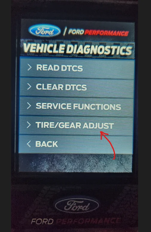

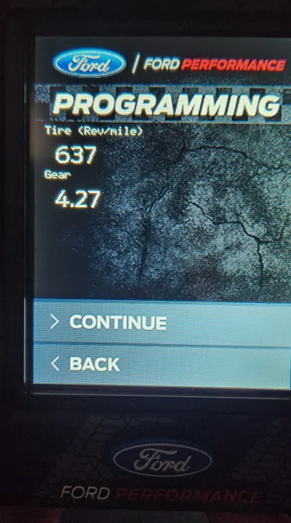

So yes, you can tire adjust with a Procal. You just tap the value and you can punch in your own numbers depending on your tire size then an ignition on/off dance. Not sure why Ford has it labeled on the website that you can't do it...? I brought it up because i was thinking to switch to the Cobb Accessport which has a nice Tire size editor and the extra power thru a goosetune would be a nice bonus, but if the Procal can do what I need it to, then Im perfectly content keeping it and love the extra power it gives.

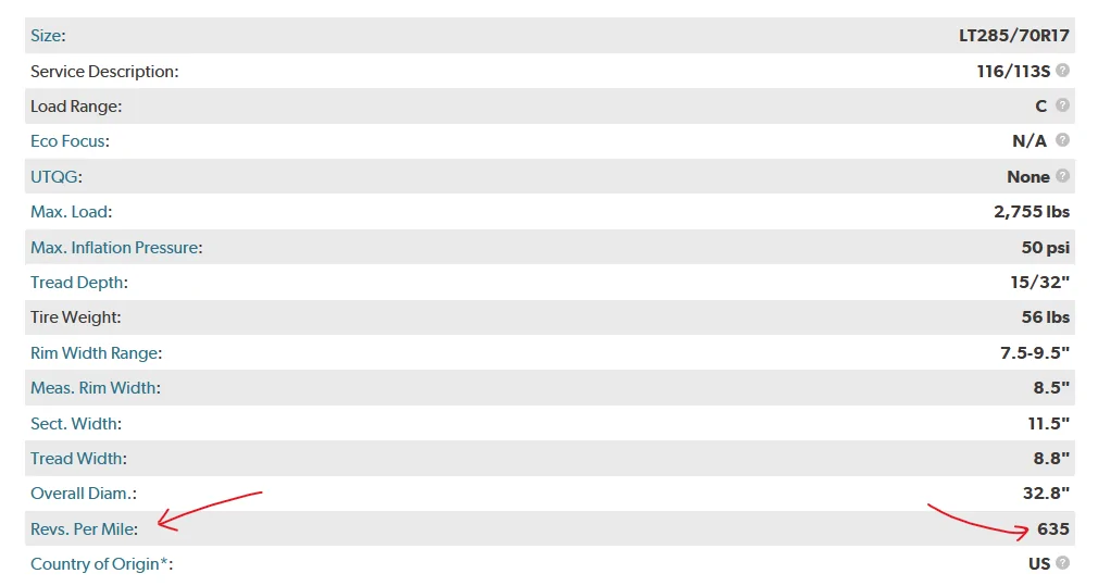

once you move past that screen on the procal for adjusting tire size, the number you change is the revolutions per mile of the tire. its not in mm or inches but rpms of the tire in a mile. google was not very helpful in figuring out what the stock 18 inch tire should read so i had to play with it a few times to get my speedo to .5 off the gps reading.
just fyi for people wanting to change their tire size to correct their speedo

I've found the Tirerack site really good for that info, just look up your Brand/tire size and click the specs. Changing the revolutions is technically changing the tire size. Its alil more complicated than entering 34" or 35" but its more precise as tires all vary in height. The truck/wheel speed sensors/abs sensors look at revolutions or lack there of, The bigger the tire the less revolutions to cover a fixed distance.
I wonder if that's something they added with the last software update for the tuner? When it first came out, there was no option to adjust tire size to many people's surprise. My 2016 Mustang GT Pro Cal 3 tuner had the ability to adjust tire size and axle ratios even on a car!
I'm betting they added it as a basic feature since it's a common option on most of FP's cal's / tuner interfaces and due to time / resources they probably didn't do it initially just figuring they would add it in later.
