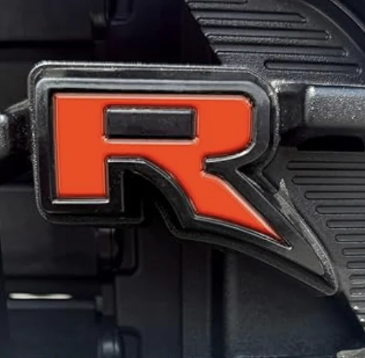

I was thinking, because I now have a RR that has a pro tune, why not put an R on the front grill and call it a Ranger Raptor R. I mean, why not?
I'm liking this idea, but you'll get a flurry of opinions. Some will call it a poser move, some will love it.
R can mean anything you want though, your truck, your choice. Why can you not just put the R on there to mean Raptor? Or do 2 R's for Ranger Raptor?
