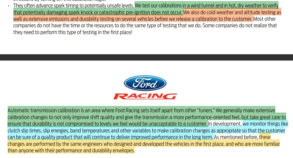

One of the tests FP lists on their tech article for their calibrations is Wind Tunnel testing of every FP Cal. They use dry hot air to induce worst case knock and test for reliability under those conditions. How many aftermarket tuners have vehicle wind tunnels that are climactically controlled and test for worst case conditions?
How many of them are looking at slip energies and times on the torque locks for durability etc? Usually it's "I make more power than the next guy and my car didn't blow up today"....drive it around in their own vehicle and call it "reliable".
I'm sorry, but that is anything but reliability testing and unless it's a built bottom end (forged Mahle rods / pistons), something that can take a lot of abuse and tuning errors, I wouldn't trust anything but OE tuning.
Built engines are built for a reason, so custom tuning makes sense there as it's tailored to a very specific hand-built one-of-a-kind application. These are mass production vehicles with variability in build to build, I'm going to trust the engineering teams that designed them!
Some people are claiming the FP Cal is "just a watered down Livernois cal", I find that hard to believe, they use Livernois programming platform and have for years, they work with Livernois on some things including custom machining work which is Livernois core business, but Livernois doesn't have the OE testing capability that FP does, they aren't data packing the ECU and collecting real-world data and they don't do nearly as much reliability testing because they simply don't have multi-million dollar test facilities like Ford does nor the team to do so (manpower resources).
See attached from Ford. From the PDF, this is of particular interest to most of us (long-term durability under extreme conditions):
Ford Ranger Poll: Stock or Pro Cal (What's your experience, Good, Bad, Meh?) 1767706397908-fy
So, if it's "just a watered down Livernois tune", then I guess Ford is lying about all their testing, tuning and development? The delivery platform has nothing to do with the actual calibration being loaded, how it was developed and tested etc.

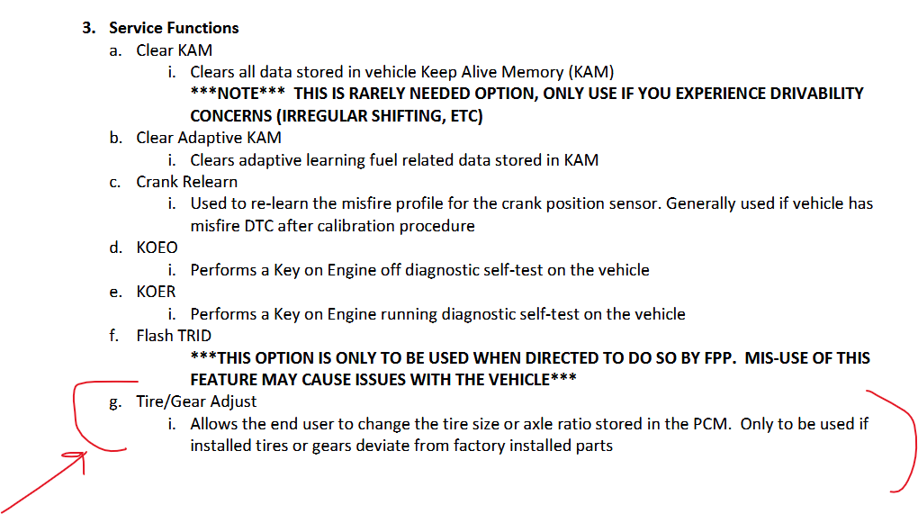

Has Anyone with the Pro Cal up sized their tires? 34's or 35's. I havent tried it with mine yet but does the ProCal unit have an adjustment for tire size?
Not according to Ford Performance. It says so right on the site.
  • ProCal Tool can read and clear DTCs
    • Tire size and gear ratio cannot be adjusted
True i did see that, but all the material/instructions that come with with the procal (page 4) say you can. When I finally get home today i'll plug it in and check it out.
