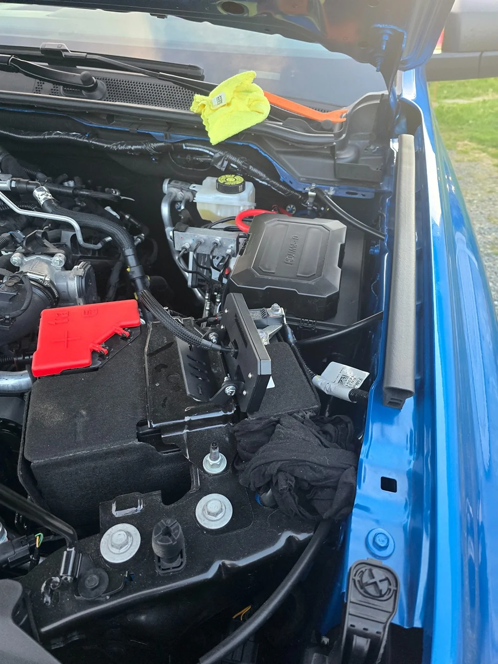

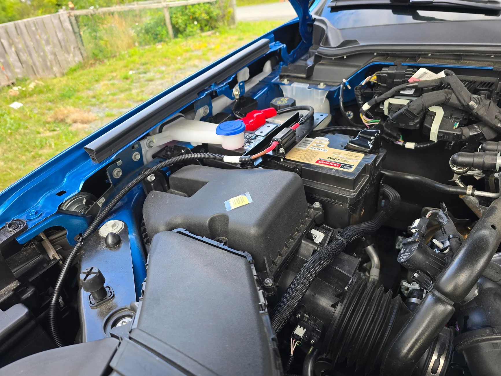

Before I ordered the arb dual battery kit from bpt motosports in Australia to Canada, I just used the included double sided tape from Diode Dynamics to mount my D switch to the top of the fuse box and still be able to open the lid. then I moved it to a simple sheet plate mount I made to go on the battery hold down.
