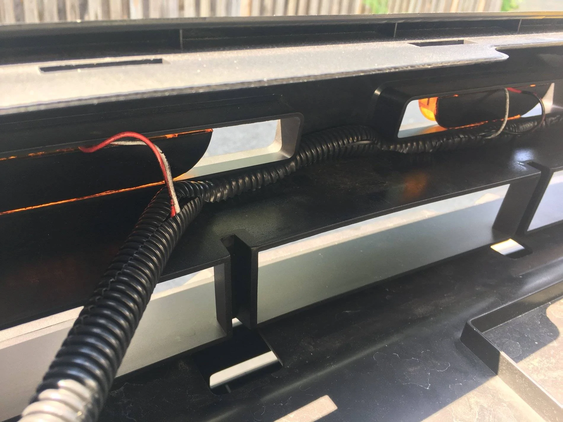

Hey Sid,
Can you elaborate on where/how you tied the wiring for the Grill LEDs into the marker light wiring?
Pretty sure I can follow your diagrams for fabricating the brackets and attaching, but I live in fear of anything wiring related...

Hey Sid,

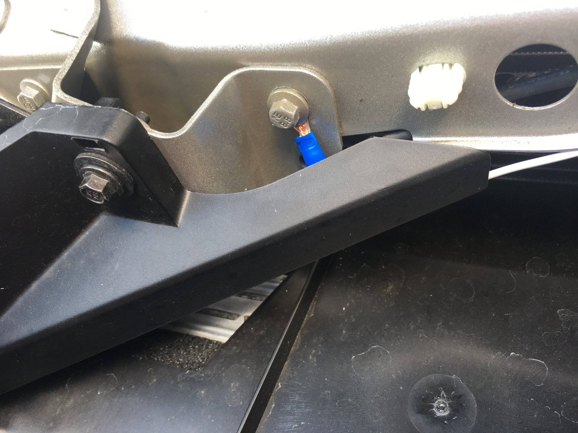

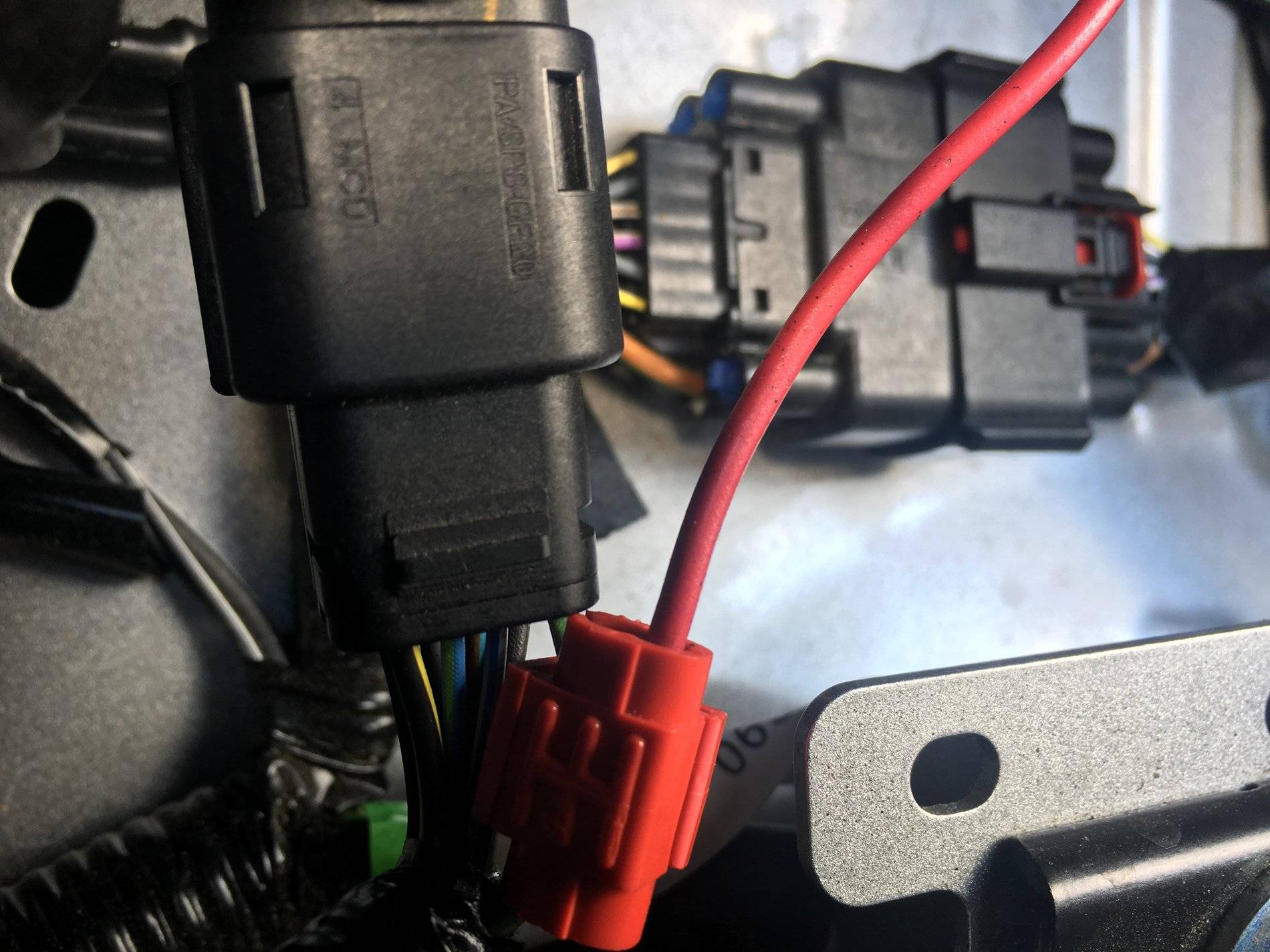

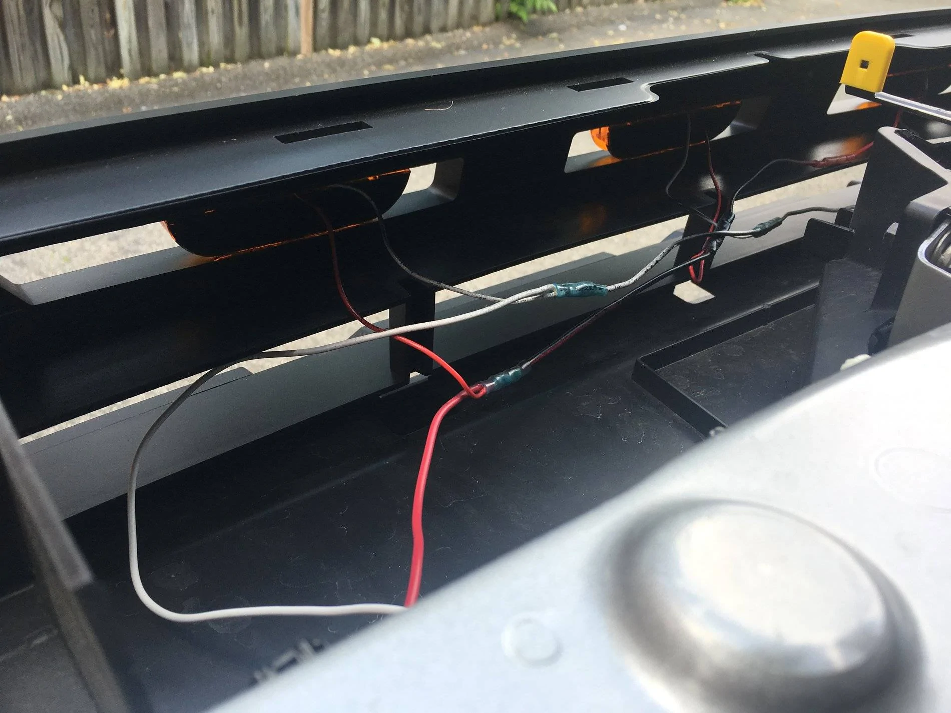

I just finished the same install. I did the mount a bit differently and will post some pics later and update but here is some of the wiring. The wiring was really easy. The white wire ties to any grounded screw. The red wire taps in to the marker lights. This is done by using an inline tap you can get at any auto supply store. On one side you insert your red wire, and on the other side you straddle it around the marker light wire. Squeeze the tap shut and you have then combined the wires.
The location of the marker light wire is near the base of the battery box. It’s attached to a wiring harness which you can unplug to get a bit more room to work. There is some black electrical tape you can push back some as well. If you use my picture and Sid’s picture you should be able to locate it easily. The wire is the upper left wire on the harness. My eyes said it’s mostly green with an orange stripe (Sid said yellow stripe).
For the white wire I crimped a connector on to it but that’s optional.
To wire the lights together I used butt splice connectors that you crimp then heat to be waterproof.
